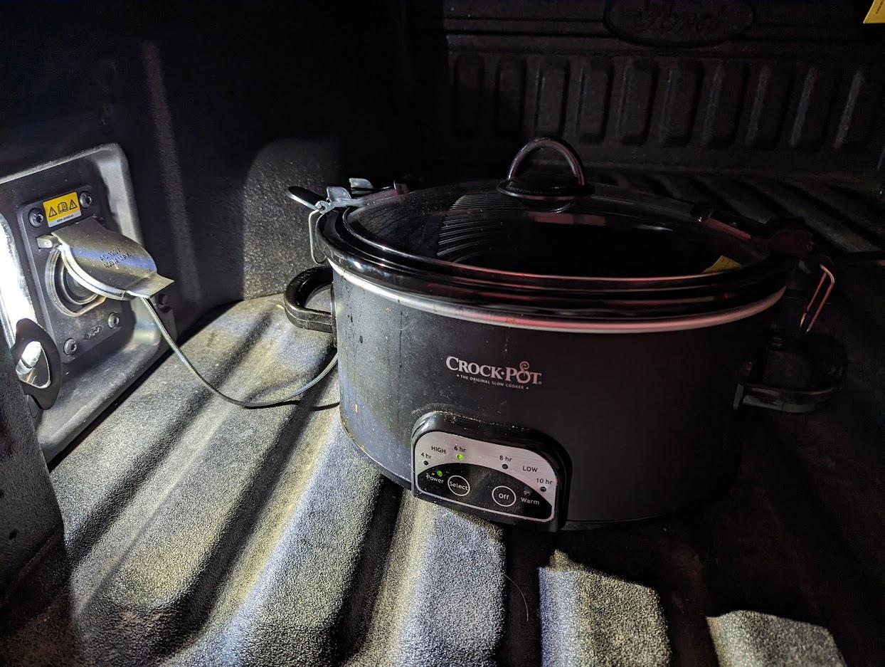

Someone awhile posted this greatness of the crock pot on road trips- We plan to do this on our next camping adventure- Dinner ready before we even set up the tent :)
