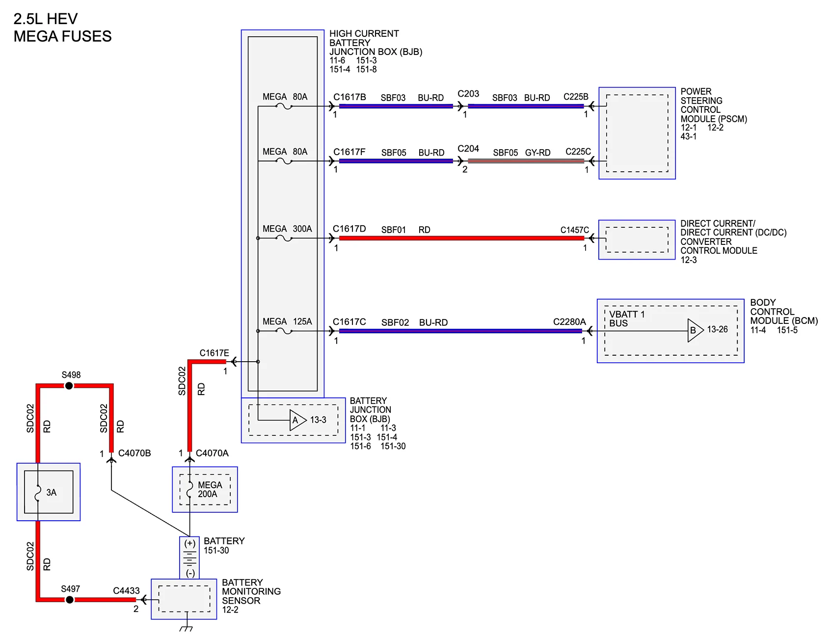

Look guys, I don't know why we're relying on Google AI summaries rather than simply trusting the service manual...
Ford Maverick 3000 watt Inverter Screenshot 2026-02-04 at 10.18.51 PM
Note that the 50A fuse is a *high voltage* fuse, i.e. 300V*50A=~15kW. And an explicit mention of the 265A number.
Ford Maverick 3000 watt Inverter Screenshot 2026-02-04 at 10.23.41 PM
This is the wiring diagram for the 12V high-current junction box on the 2025 Hybrid. Note the fact that there is a 300A fuse connecting the DC/DC stepdown.
Now, if you look closely, you'll notice that there is 2x80A fuses for the power steering, and 125A going to the BCM (and the main 12V fusebox).
Presumably, if you're not whaling on the power steering, it's going to be drawing nowhere near the full 160A (and probably 0A if you're parked).
160A*14V is 2.2kW, which means that a 2kW inverter should be perfectly accounted for when parked because it takes up less than is reserved for the power steering.
Not to mention almost all of the other large loads on the 12V bus will similarly be absent when parked.
Now, I *probably* wouldn't recommend drawing a large amount of power while actively driving, simply because if you did somehow manage to blow the fuses you might break your power steering, but when parked you should be fine.
You can monitor power draw over OBD-II, and I've done so while drawing 1.7kW for over an hour, and it was nowhere near full load. It was cycling the engine on and off intervals because it didn't even need to idle all the time.
