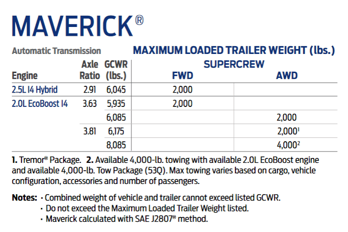

The hybrid is rated at 2,000lbs towing. If he wants to tow 3,500lbs he needs to shed 1,500lbs of weight to stay within the GCVWR. Impossible.

A 2024 XLT hybrid is 3636 lbs +/- 50lbs depending on trim
These are all estimates based on my Focus ST weight reduction (I added some weight to each as everything is bigger on the Mav)
Spare ~50lbs
12V battery ~40lbs
Passenger seat ~35lbs
Backseat ~50lbs
Tailgate ~50lbs
Right there is already 225lbs, getting you below the 3500lbs limit.

Did a search for those terms and didn't find what I was looking for. Curious about how to drop the weight of a '24 Maverick Hybrid below 3,500 lbs. Tailgate and ¼ tank of gas being obvious....
Background is Ford Transit 350 HD AWD can tow 3,500 and I'd like to be able to do so. Thank you for any insight.
It's so close I wouldn't sweat it.
Every 5 mph you slow down is worth about 500 pounds. Just drive 5 or 10 under the speed limits and don't tear apart your truck.
Don't you also have to include the weight of the trailer? Taking items off the Maverick and putting them in the Transit is still not going to change the GCWR.
