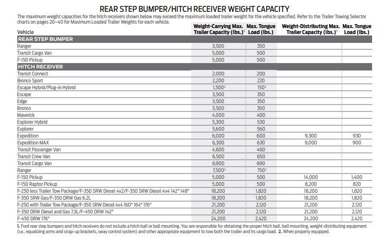

Ordering larreit awd. What is the toung weight capacity. Hubby is disabled and to to carry sometimes his big wheelchair. Carrier is 75lbs wheelchair is 401lbs. Upgraded towing does not seem to change the suspension just radiator and trans cooler. Help please. Dealerships can't answer.

The tongue weight is most relative to towing a trailer and has a lot to do with the proper trailer angle to prevent trailer sway.
the max on a Mav is 400lbs, but I am confident hauling a wheelchair off it with the proper rack will mot be a problem.

Hitch receiver weight capacity is 400 lbs. I wouldn't sweat being a little over.

I believe the hitch receiver is a class III and the weight capacity should be around 1500lbs depending on options, so 476lbs + passenger weight will be under that. Regarding tongue weight, the general rule is to stay under 10%, therefore a 4K towing capacity would have a max 400lbs tongue weight.

It looks like you will be about 75lbs over ~20%. Not sure how much of a difference that will make, but it might make the front end light and make driving a bit less than ideal.
Another option would be to get a lift and put the chair in the bed. We had one for my grandfather's scooter to put the chair in the bed of our F350. It worked pretty nicely, although we had an 8ft bed and a high rise truck cap, so we still had plenty of room in the bed for other things.

So 200lbs standard, 400lbs with tow package?
Those two numbers are based on 10% of max trailer weight not on the upper limit of the weight the receiver can support.

Looking at a new camper. Tongue weight is 430. Do you think 30 pounds will cause any issues?
