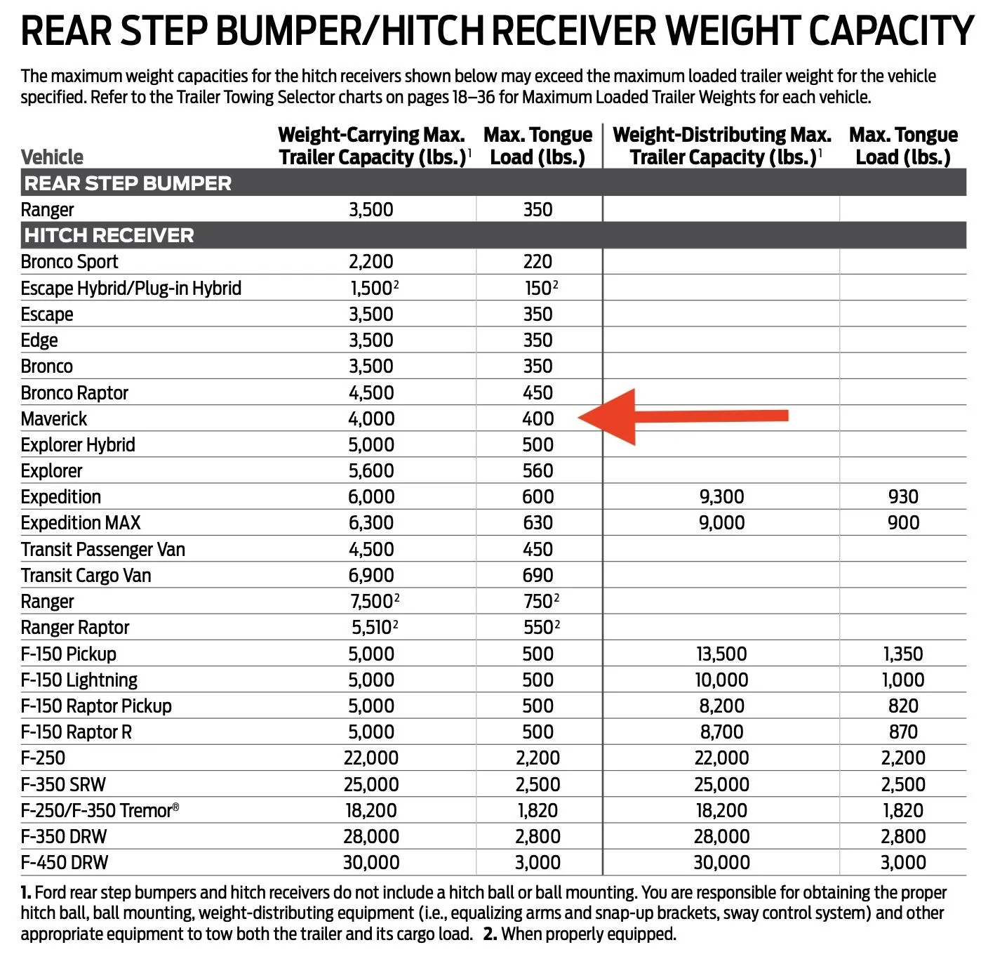

Don't overlook the fact that the Maverick is a unibody vehicle. Which is just fine....up to a point. Compared to the much thicker steel of a body on frame vehicle, the "hitch" mounts to much thinner sheet metal. Too much stress can too easily tweak that metal compared to a more rigid traditional frame. While I may push toward the listed limit on tongue weight....I would NOT feel good going to it or over.
In some towing specs ( possibly the "J" standards used by Ford) there is also a spec on how long your hitch ball is set from the hitch face. Go over that and the "rated" tongue weight gets lower.

Typically as a guide, max tongue weight when you can't find it is 10% of max towing weight. So a 4K tow package would typically have a 400 pound max tongue weight. You should never tow with too much tongue weight and never tow with less than 10% of the trailer's weight on the tongue. I prefer a little more than 10%. If you can't stay within those parameters don't do it. Towing with less than 10% on the tongue can lead to trailer sway and then you're screwed at highway speeds. Towing above the max tongue weight can lead to suspension damage and/or loss of control. Still there will be idiots out there that say you can do it.
