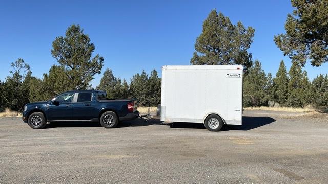

Well that's the flip side of the coin.
Too light of a trailer can be a problem also. I pull something very tall, but also pretty heavy. Never a problem but I can't think of a time I've pulled in winds greater than 25 mph. Should I encounter such I will:
A) slow down significantly until finding a parking spot
B) park until winds improve
This was a pleasure without "high" winds, but always "breezy" in the Sierra Nevada. 3300#. 7x12x9 Have electric brakes.
