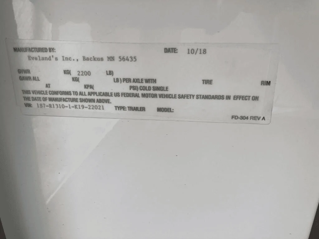

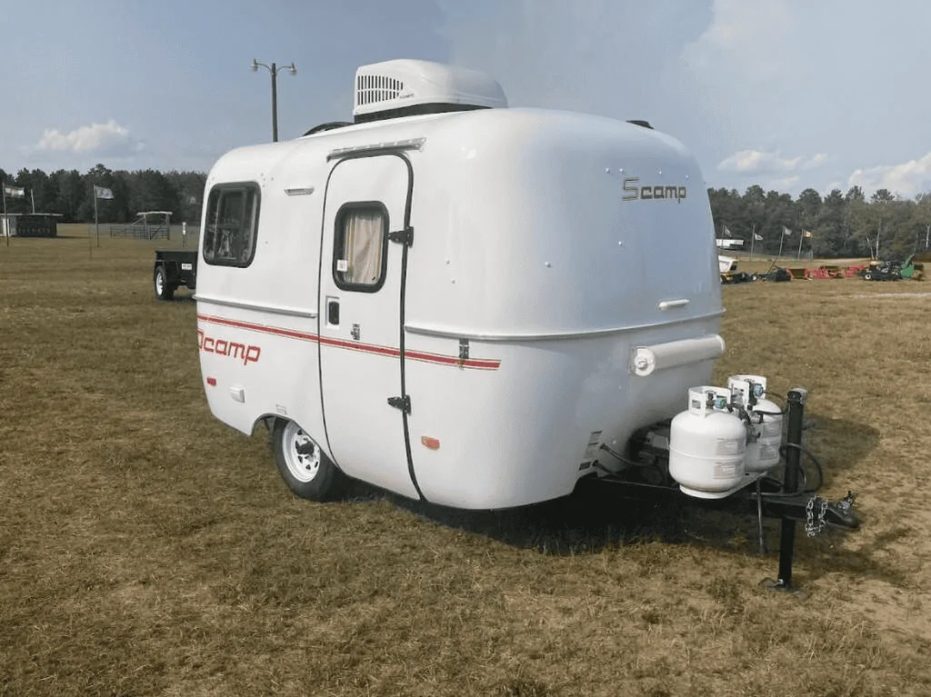

, I would assume this is a 13 foot Scamp. If you Google Eveland's INC it is a Scamp manufacturing facility in the VIN it lists R1310 which should refer to the model of the trailer since there is no model number on the FD plate.
If this is a 13' Scamp, they show empty weights ranging from 1100 to 1600 POUNDS, depending on model. While the weight may fall within spec, the frontal area may not,,,,

I would drag that thing around like a donkey pulling a plow. These have literally the smallest frontal area of any not popup travel trailer. Using a Mav without the 4k tow package shouldn'tbe an issue. I wouldn't load it like a crazy person. I don't think you will have any problems. I have the 4k set up, and when I picked up my travel trailer it just so happened to be right at 3850. I weighed it after the 1100 mile trip home.

You should be fine pulling a 13 foot Scamp. I have a 16 ft Scamp that has 2200 lbs. dry weight. When it is loaded for a week long trip, it weighed almost 2900 lbs. with food and gear. I have the 4k tow package so my Maverick tows like a champ! Have fun with your Scamp!!

could you possibly find a model number or something like that for us to use?. Currently all I found was that the R1310 in the Vin for Scamp translates to a 13ft trailer. Then by doing some quick google searching and on the Scamp website mentions " Our Standard 13′ touches the scales at 1,500 lbs (without a bathroom, which is available in a standard) with a tongue weight of 200 lbs. " But then apparently there are a few options that could have been added to the trailer (awning, bathroom, etc) but appears to be (if empty) under 2k...but I am not claiming to be correct or anything.
