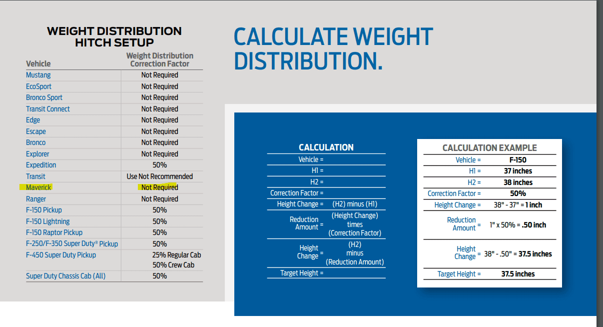

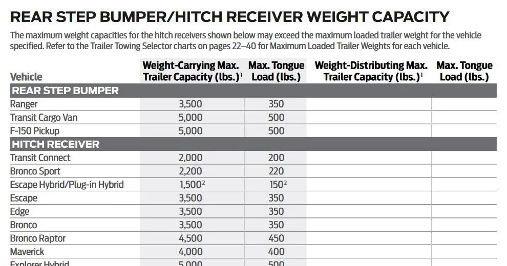

Ford has shown if you can’t uses a WDH that they will make it very very clear just like they did on the Tranist.
Using the well it’s blank therfore they are saying not to use it doesn’t work when we look at other Ford trucks. Ford leaves the same section blank for the Ranger which is clearly not a unibody truck and is perfectly capable of using a WDH. Ford is basically saying it’s not required to tow the max. Which is correct it’s not. However, tow a tall trailer close to the max weight and it will makes a massive difference in terms of sway control and ease of towing.
