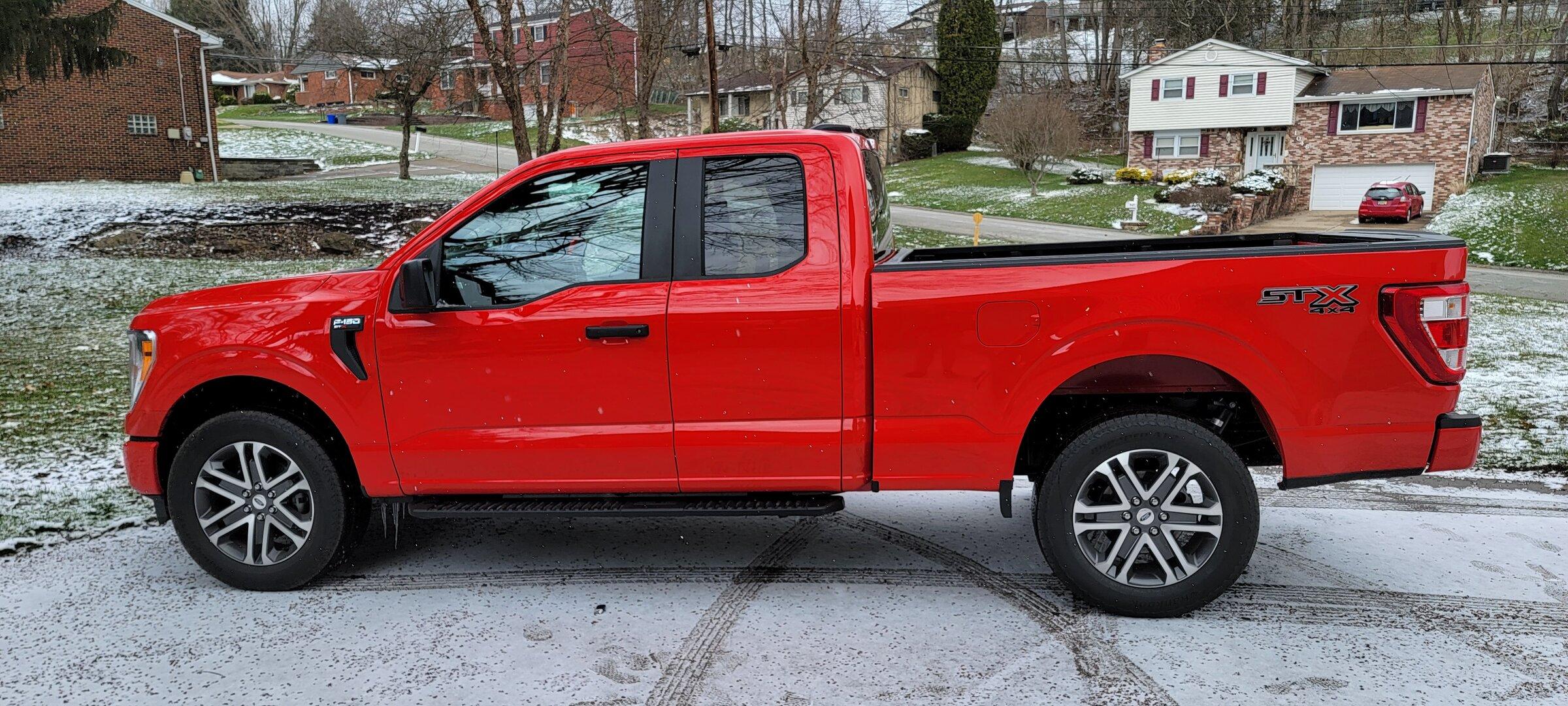

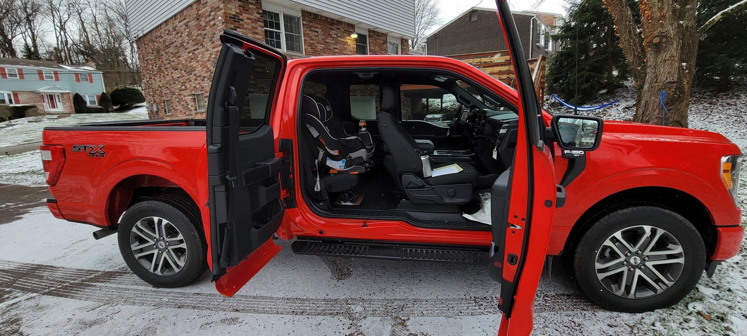

I had my truck in to the dealer this week for that harness swap out. They had it for about a day and a half. No issues since they finished it up. Also, this dealer loves giving me loaner vehicles worth a lot more than the Mavvy. This is what they have me for the day. (2022 F-150 STX) 😂

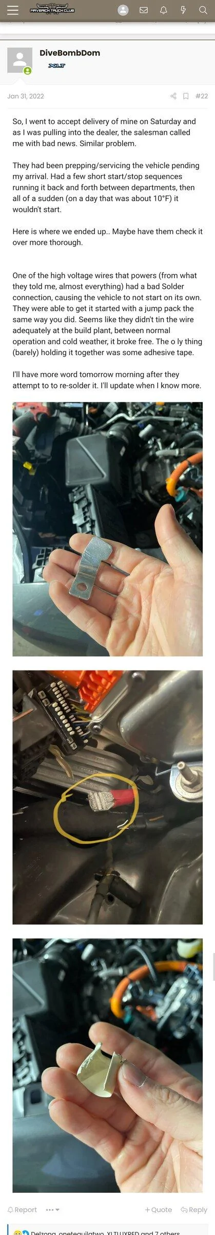

Other members have reported a faulty solder connection in their wiring harness.

It was a faulty wiring harness on the 12v side of the system. Here is a sceencap of my original post explaining a little more detail.
Wow! You may be the Master Ford Tech! Maybe they will pay you for documenting this - they should! My Service Dept has been working on it for a week. If they have not figured it out by Tuesday, maybe I will need to check this out myself at the dealership. Thanks.
