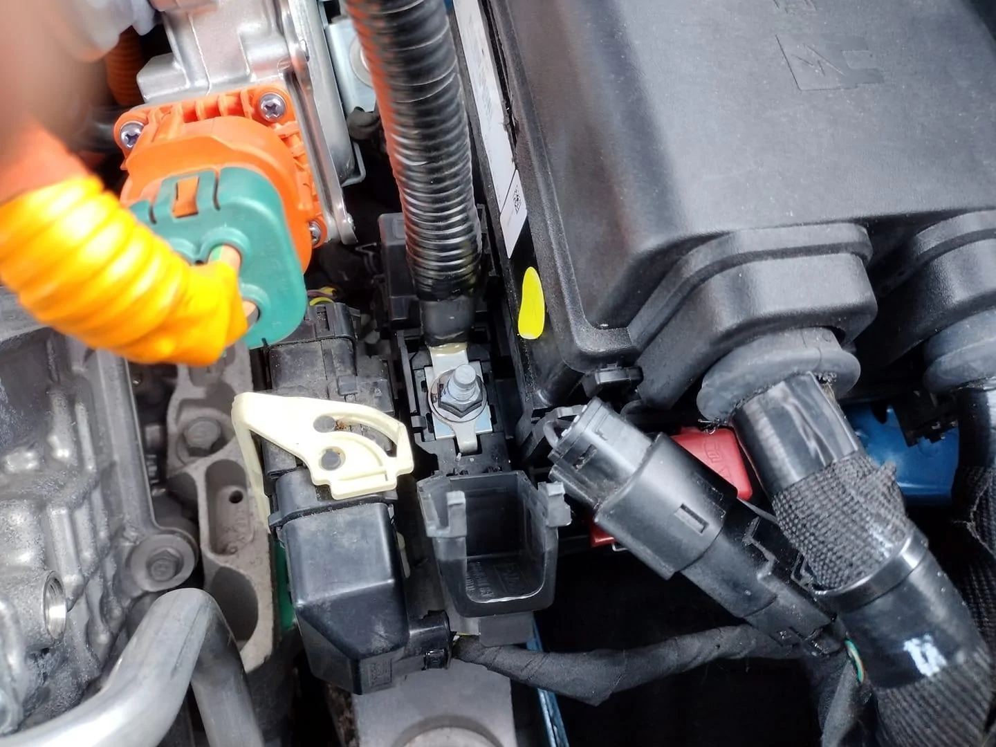

Lengthy update....
@KeinoDoggy Man I was really hoping everything was sorted out and fixed, but I am once again a member of the dead maverick club. However, I have learned a lot.
The guys at the service department really tried to help and unfortunately their fix didn't hold. I have done some investigating in the driveway and have narrowed it down to this cable (directly behind the one you pointed out). When I pull up on it, all of the relays click and I get 12V, when I relax pressure, everything dies.
Ford Maverick [UPDATE 3/22/22] Dead Hybrid Maverick at 1 month old after getting "Deep Sleep Mode" messages. [Possibly fixed by software update.] 20220601_172735
I probably shouldn't disassemble anything past what I already have, unless there is an easy fix?
This is pretty large wire, so is that connector soldered on? It looks to me like it is almost pulling out of the connector end (See second photo).
Ford Maverick [UPDATE 3/22/22] Dead Hybrid Maverick at 1 month old after getting "Deep Sleep Mode" messages. [Possibly fixed by software update.] 20220601_181657
