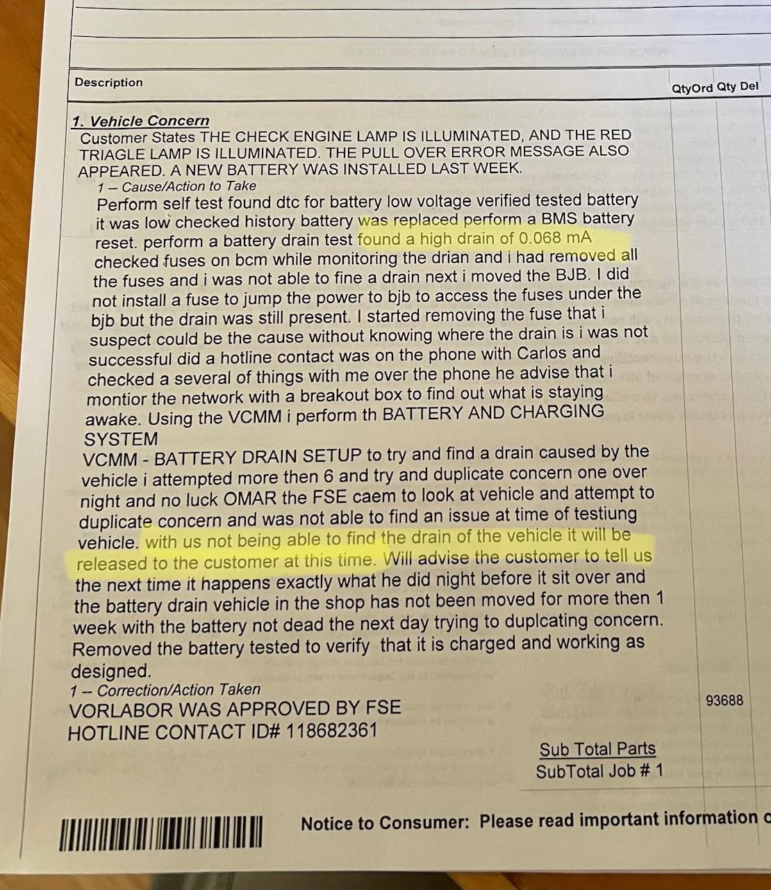

First Update: Fixed for now at least, took it to the dealer, they performed a load test on the battery, it failed (any battery with only 2.15 volts will fail a load test), so they replaced the battery. They didn't perform a parasitic draw test like I hoped they would but if this happens again, I will make sure they do next time.
Another Update 2/4/22: After the dealer replaced the battery a couple days ago, I just got another FordPass Deep Sleep Mode notification. I checked the battery voltage with my multimeter while the car was off and with doors closed, and it read 11.6 volts. So it does look like the battery is draining on it's own for sure and the first battery wasn't just a "bad battery" as new batteries should read 12.6 volts. I have a Mercedes with a 4 year old battery that still reads 12.3 volts with the car off. I'll give it another day or 2, see if it completely dies out again, and back to the dealer it goes...
ANOTHER Update 2/6/22: Went to start it this morning, truck would not start, instrument gauge was on without the key in the ignition and flickering, key fob unresponsive, relays were going crazy and there was a grinding noise coming from the brake pedal area. Battery voltage is 10.1 volts.
UPDATE 2/7/22: Dropped it off at the dealer again this morning, was able to jump start it. When the car started, the check engine light was on and a red triangle light illuminated on the dash. 5 codes were stored in the ECU.
UPDATE 2/12/22: It has been at the dealer now for 6 days with no updates or ideas what the problem is. My service advisor reserved a Ford Ecosport Loaner for me which I picked up today.
Update 2/22/22: It has been over 2 weeks now that the Mav has been at the dealer. My service advisor informed me yesterday that no progress has been made on finding the cause of the issue.
Update 2/24/22: It is still at the dealer but my service advisor just called and said a Ford engineer will be coming to the dealership today to inspect my car.
UPDATE 3/8/22: Picked up the Maverick from the dealer today after 31 days sitting there. Ford Customer relations called me 3 days ago saying they think the dealership fixed the problem and that it will be at the dealer for the next few days for observation. Last Night (3/7/22), my service advisor called me to inform me that the issue was fixed. However, my Maverick was not connected to the FordPass network for the last couple days indicating that the battery was either disconnected or dead. When I picked it up today, it ran fine, the check engine light was off, and no flickering lights. I drove home (about a 3 mile drive), parked and went inside to have lunch. About an hour later, low and behold I got another "Remote Features Disabled/Deep Sleep Mode" FordPass app notification. My heart dropped and I went outside and put my multimeter directly to the battery, sure enough, 12.1 Volts indicating a drain/low charge level once again. (A fully charged battery should be 12.6 volts.)
UPDATE 3/13/22: Have had the truck back in my possession now for 5 days and it hasn't died yet. I only got 1 deep sleep mode notification on the day I got the truck back. About a week before that, I noticed a notification on my FordPass app that said the software has been updated to the most recent version. I believe this may have been the fix for my issue. Normally, my Mav would have died by now. As far as the deep sleep mode notification and 12.1v battery reading the day I got it back (3/8/22), I think that may have been because the dealer didn't fully recharge my battery before returning the car to me. Will keep driving the truck and update. Otherwise, the truck is driving great so far.
UPDATE 3/22/22: I believe the issue is fully resolved. I haven’t had any deep sleep mode notifications nor has the battery voltage dropped. Truck drives great!
