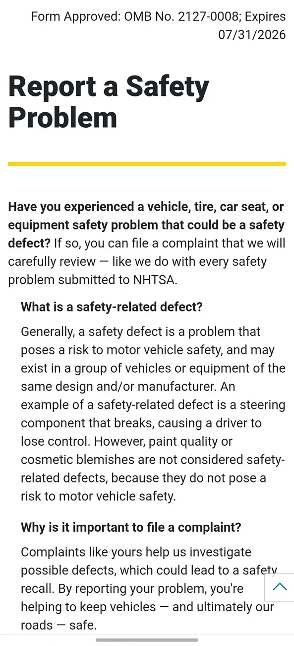

I don’t believe this is a safety concern.
How is this not a safety concern?
I had a Ram that the tailgate would flip back due to the latch mechanism. There was then a recall for that. That is a safety concern due to it being common enough and the possibility of drivers losing their load.
New (relative to within 5 years? 22MY is within that time range) vehicles with CV Axles failing is very concerning.
Ford Maverick Tremor CV axle failure Screenshot_20260121_044952_Chrom
