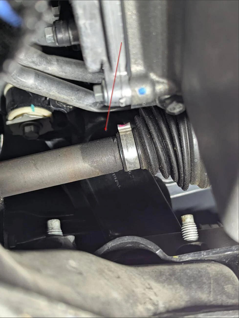

Almost a year later:
2023 XLT Hybrid
- 145xx miles
- Passenger side showing it leaked a little more comparing to when it had 6300 miles, see image.
- No shake/vibration under acceleration yet

That looks pretty minor. My '22 shed lots of grease all over the place from new. Gobs on the frame. Just kept waiting for it to fail, but it didn't. Had it changed out as it is getting close to the end of the powertrain warranty.
Cheers.

Yours is good example of the inner side having the leak 1st.
So many pics show the outer side only with a leak, where water could flow down thru poorly sealed clamp area, thin grease out, which makes it's way back out.
I guess one of the traditional methods of an issue don't really apply, per some posts earlier.
Really just squeezing the grease out.
I wish I'd noticed that recommendation of earlier post to get some good "before" photos to keep comparing. Got the outers, but failed to get inners during oil changes.

From all the failed CV axles I have heard, each time I do an oil change, I would take pictures of the axles. And I guess I will update my post on here too, we will see how much more it leaks each time I do an oil change.
