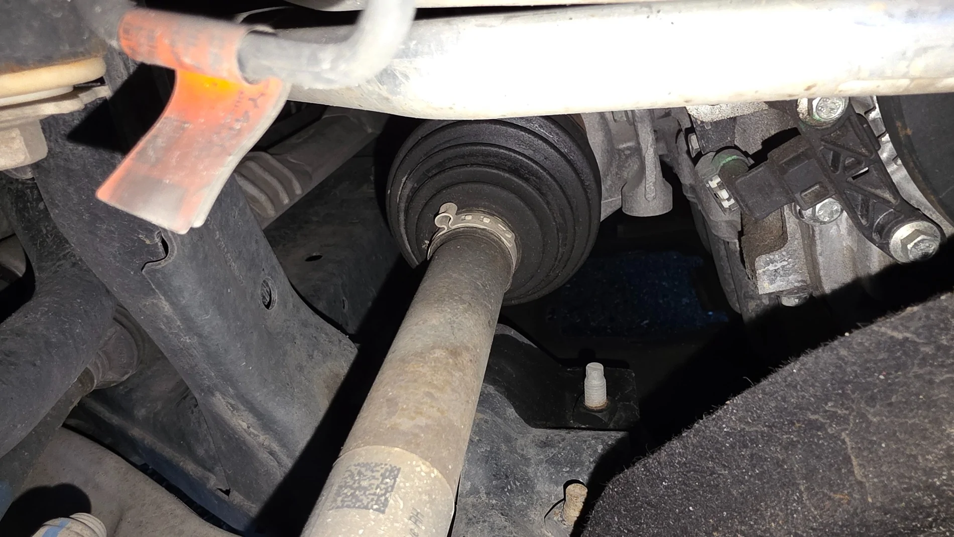

Mine's an early 23 Hybrid Lariat. The front end shake kinda started over the summer under acceleration but has really intensified under heavy acceleration recently. I came accross these CV threads and decided to take a look. And sure enough, passenger CV axel is leaking.
Appt made. Stay tuned.
Hopefully the dealership will have the part and get your situation rectified ASAP.

It took a bit, but both half shafts got replaced under warranty at the dealer and all is good again :)
CSP 25N09 does not apply to Canada as a fact, It applies to the USA only.
Though it helped with diagnosing the problem, but for this dealer, mine is the first they have come across with this issue.

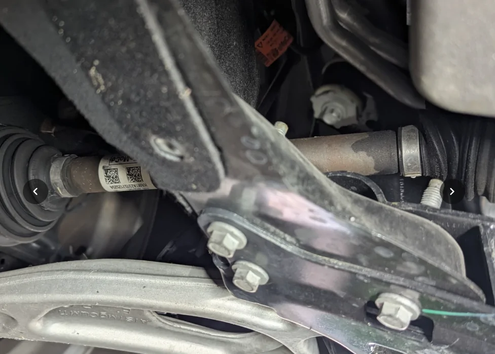

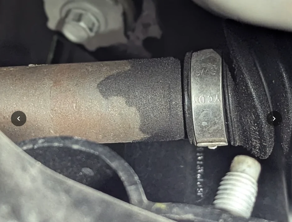

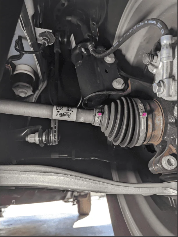

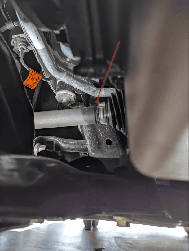

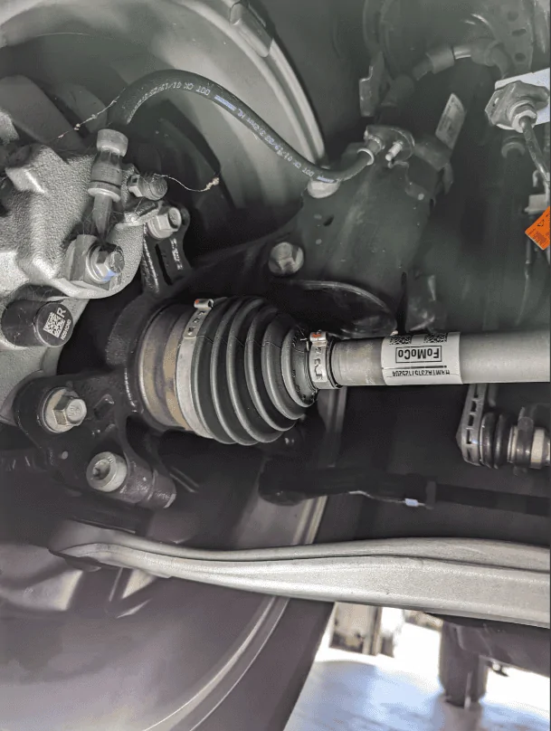

2023 XLT Hybrid

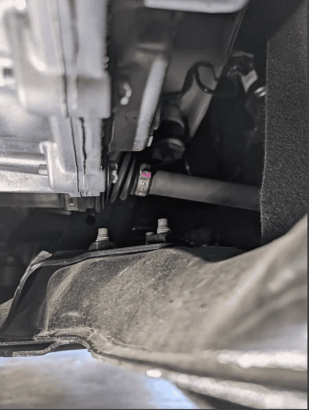

- 21,507 miles
- Passenger side showing it leaked a little more comparing to when it had 14.5k miles, see images.
- No shake/vibration under acceleration yet

That small amount of weeping at the clamp shouldn't cause CV failure. There's still a lot of grease in there.
