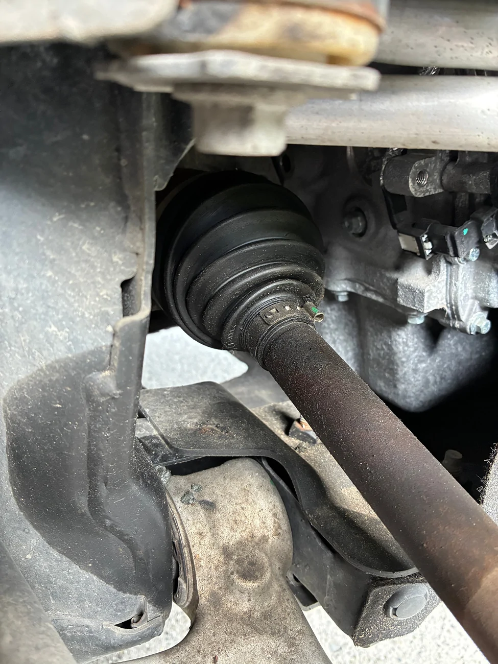

It's not very likely to fall apart if that's what you are asking. Your Maverick's aren't even throwing any grease, so it's not that bad yet.
My passenger side axle looked like this when it was replaced at 24k miles.
Ford Maverick CV Axle Issue @40K Miles -How long to complete failure? IMG_0838
