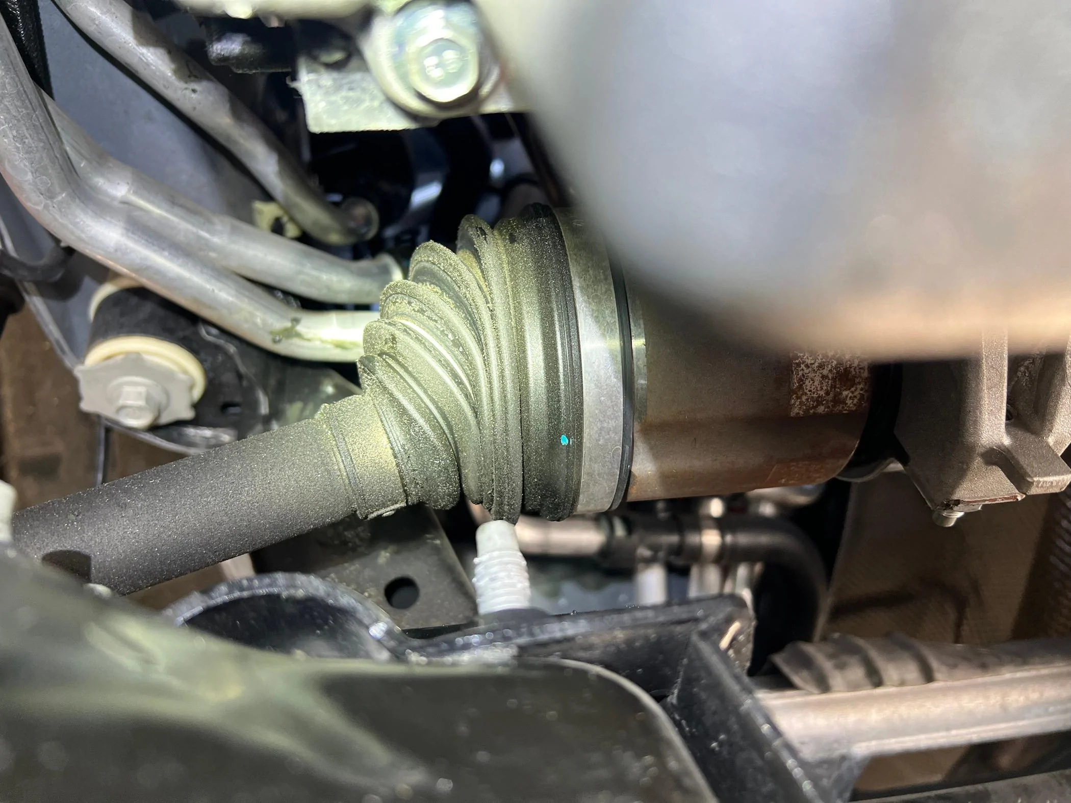

I think you're right about the extreme CV angle pushing grease out of the boot. This is on jack stands with wheels off the ground. As you can see my CV boot is leaking a bit of grease and getting flinged around. This is on the passenger side. Driver side is fine for now but still got an extreme angle on the CV joint. Not good.

In that image, is the wheel's weight supported by the jackstand or is it just hanging. That would account for some of the extreme angle if so.

Looks to me like it was likely just grease caught under the boot/clamp during assembly. There is no way I would look at that little bit of grease and think it's going to fail because of that.

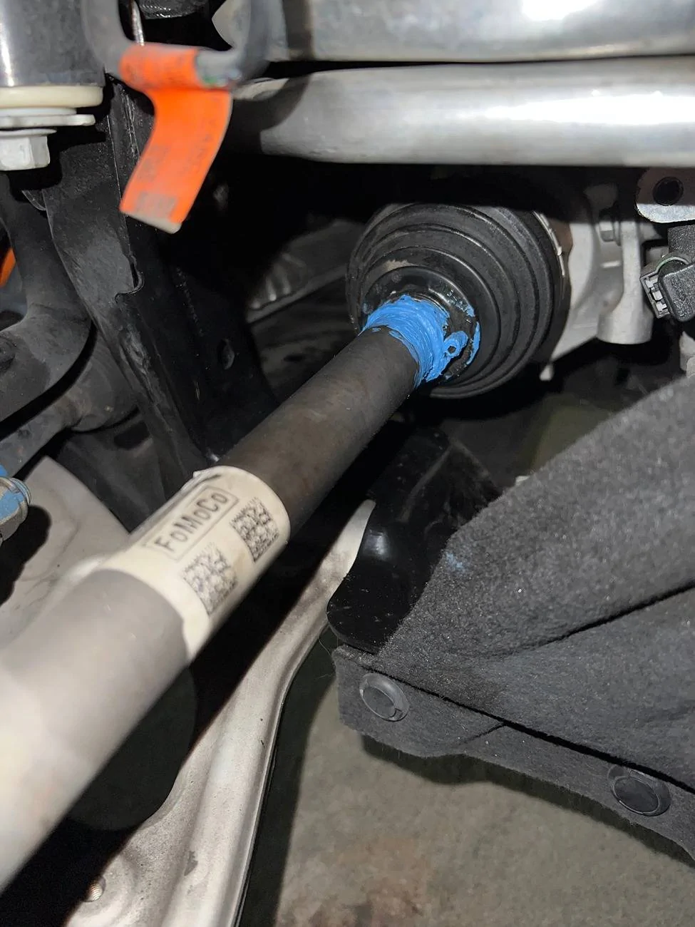

It’s not just hybrids. A lot of ecos on here with the same issue. Did my oil the other day and saw the same thing. Grease seepage through the clamp on the passenger side but none on the driver side. I cleaned with brake cleaner and then applied some black rtv on the boot where it contacts the axle to seal it up. Been dry ever since 200 miles and dry now.
Good idea using black rtv where it leaks at. I just did mine right now with blue rtv and hope it stops the small leak of axle grease.
Hope you cleaned the surfaces that u put the sealant on with brake cleaner. Looks like you have more than a bit of seepage. Like that wet mark passed the tag on there. Hopefully there’s still more than enough grease in the boot. Good thing is you won’t lose anymore. Good luck.
im at 724 miles from putting on sealant and still dry no seepage.
Mine definitely had more than a bit of seepage. Little BB sized pellets of grease flung out and got on the frame that made it look like sloppy welding spots. Not a lot but just enough to go unnoticed. Cleaned everything with brake cleaner which is why part of the frame and half the axle looks "wet". Hopefully it holds up :fingerscrossed:. Thanks for the idea!
