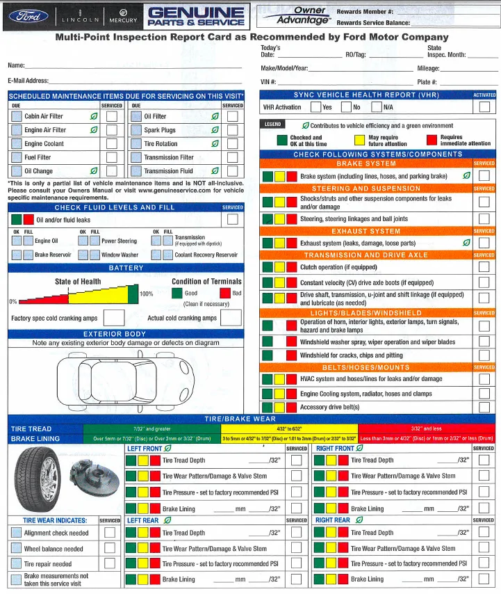

Does it take a $200 diag fee to put it on the lift and inspect the CVs? Well, no. Seems the sort of thing that should be covered by a complimentary multipoint inspection, but then you'd need to go in asking for that and see what they notice, rather than trying to get them to diagnose a vibration concern. If they notice something on the inspection, great, they can try to get it covered/talk about goodwill coverage (could be cost sharing so you don't have to pay the full repair cost). But if they have to try to reproduce the concern, the diagnostic fee would apply if not covered.
Here's an example of an older version of Ford's multipoint inspection sheet, showing what the techs are supposed to look for:

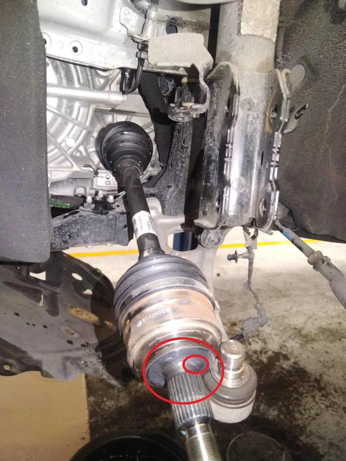

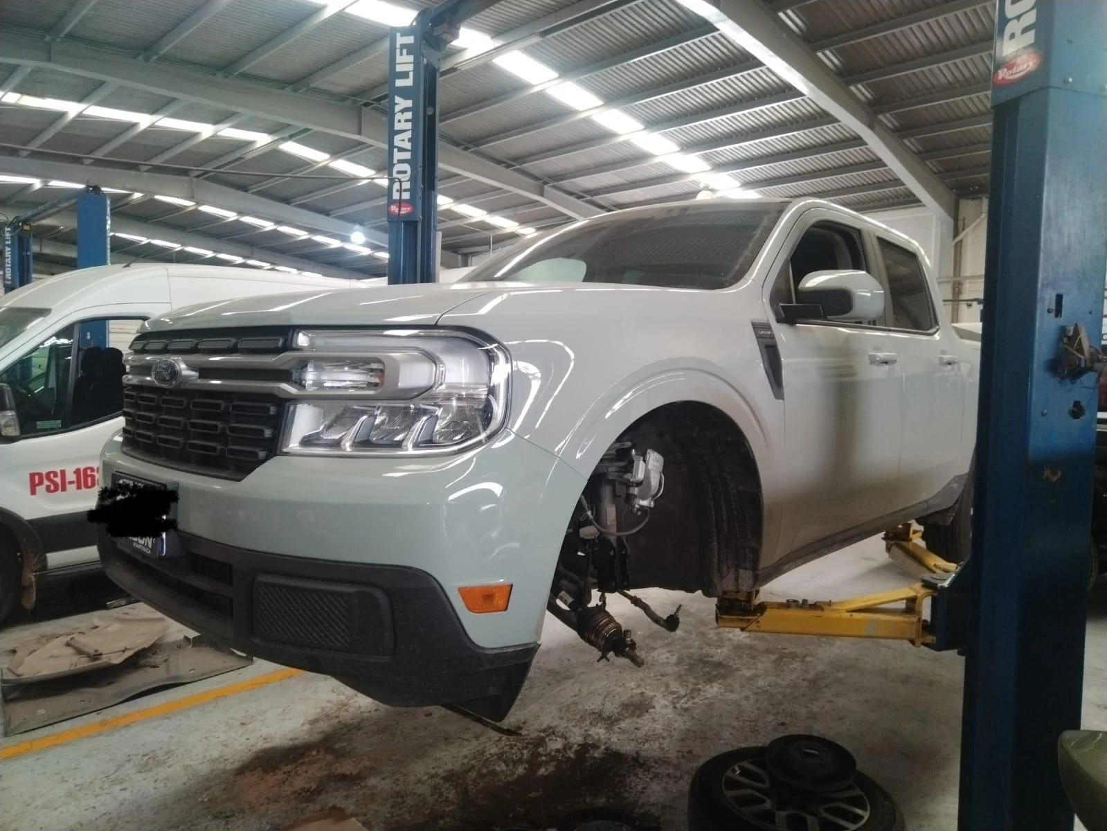

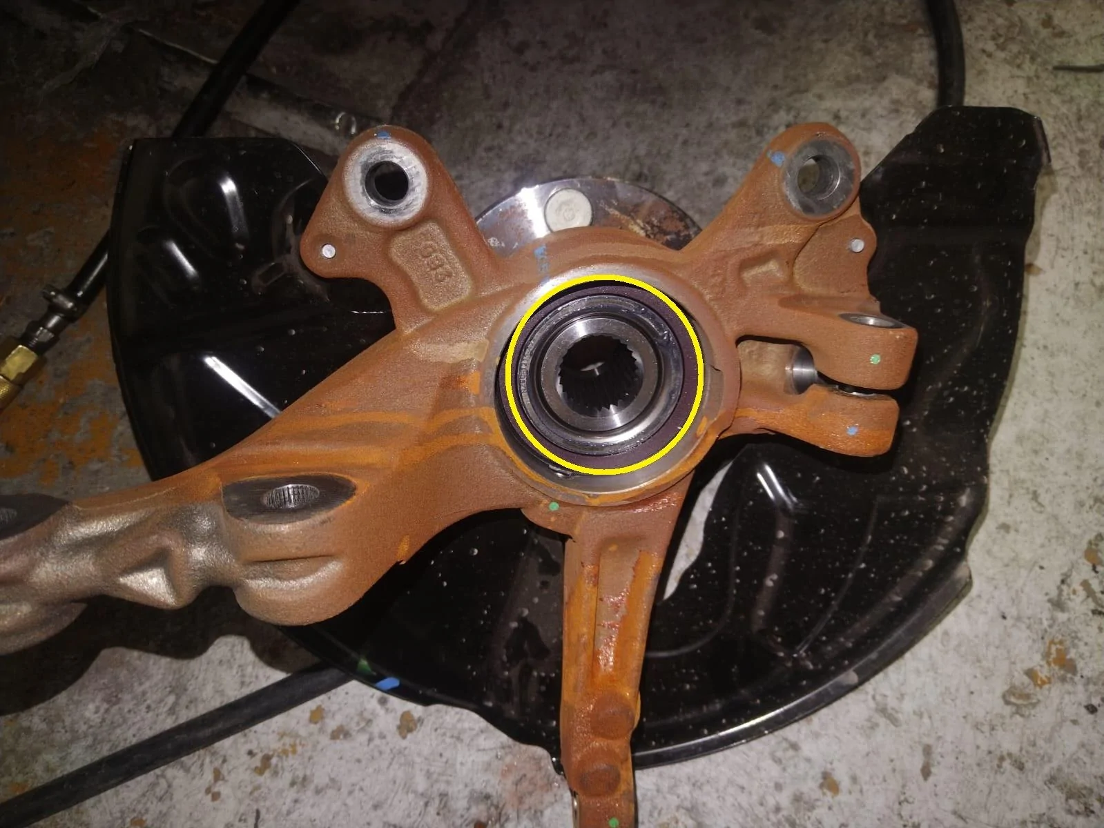

First CV Axle issue started at 3000 Km and the dealer detected the issue at 4000 Km. The dealer changed only of the driver side the cv axle, the bearing and all the piece that houses it .
Ford Mexico says that its an isolated case.
My truck remains in the shop due to a knock sound in another place while doing parking maneuvers.
Ford Mexico close my report for second time
Now I´m searching return my truck to change because its an security risk. I’m trying solve this problem since November.
