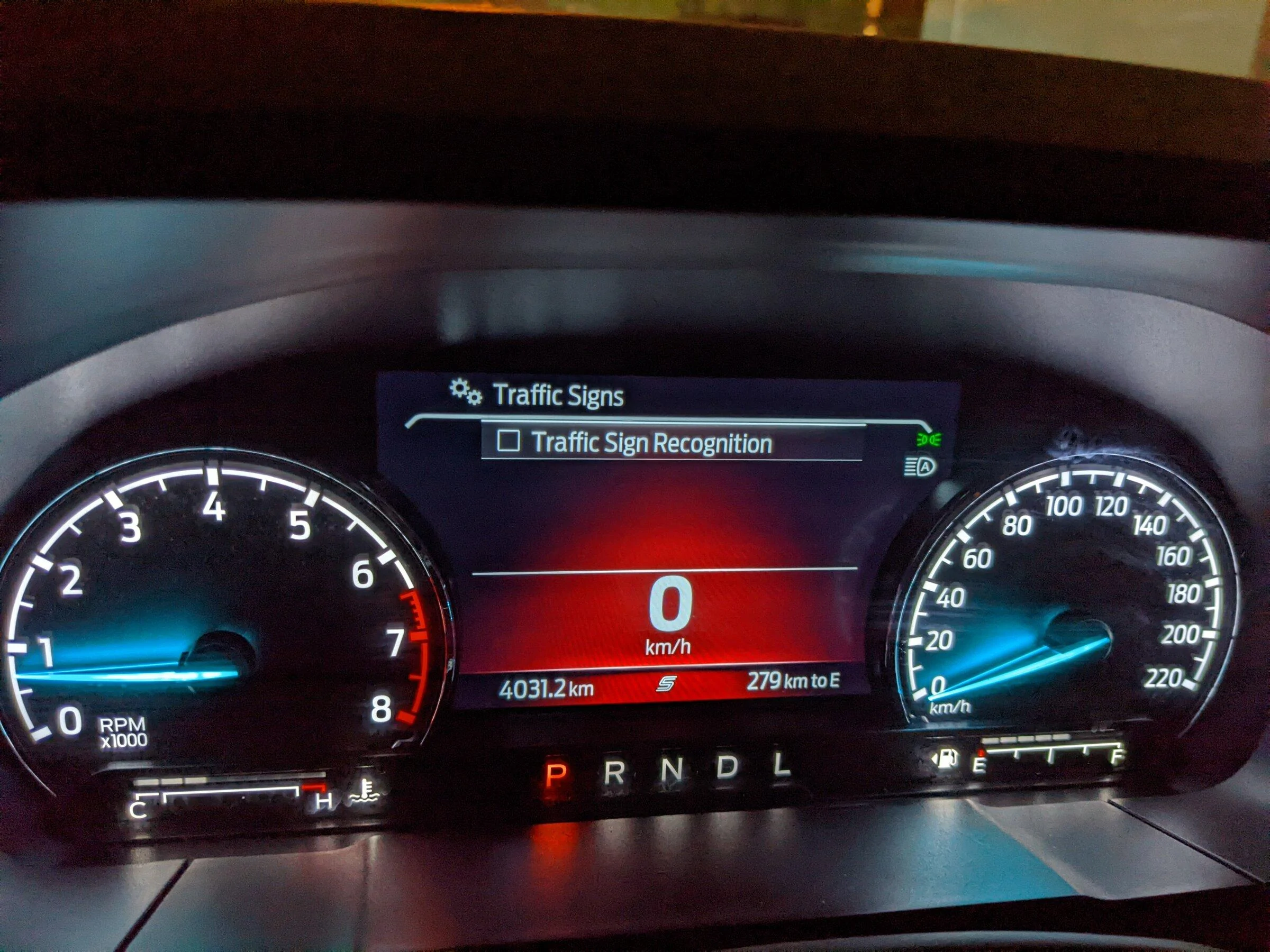

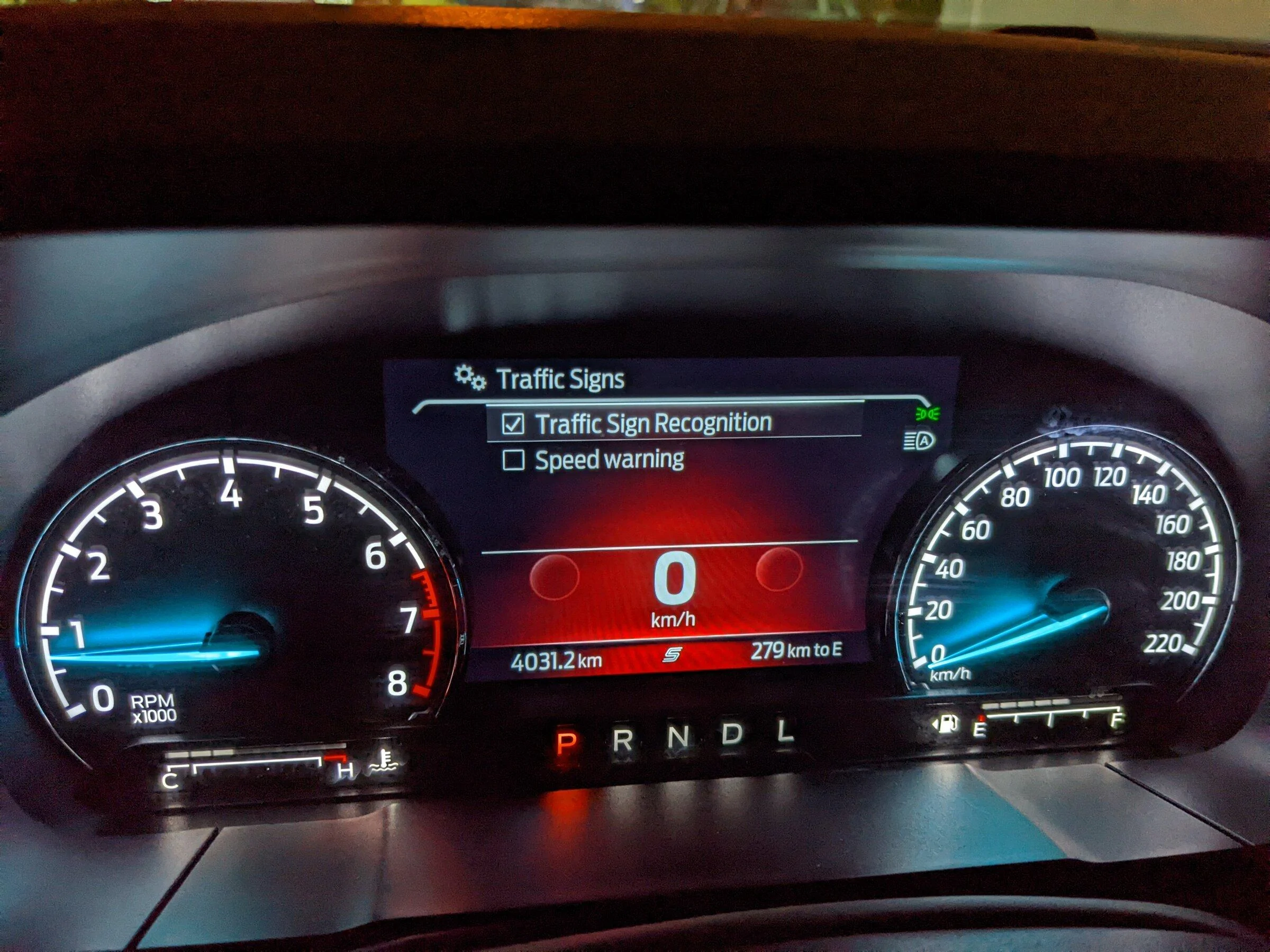

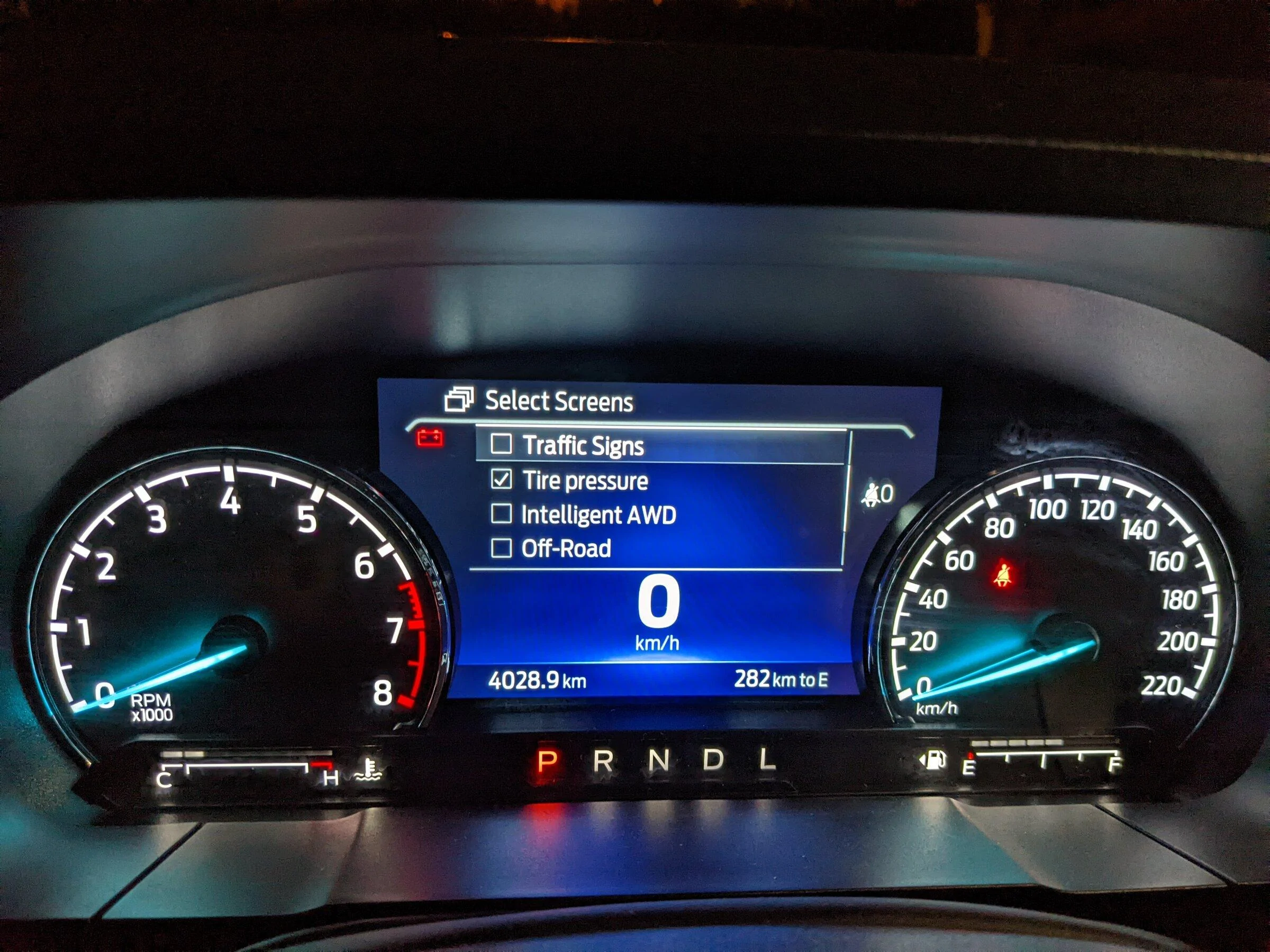

First we need to enable the TSR menu in the instrument cluster. This has been tested on the 4.2inch cluster and is untested but should work on 6inch instrument clusters.

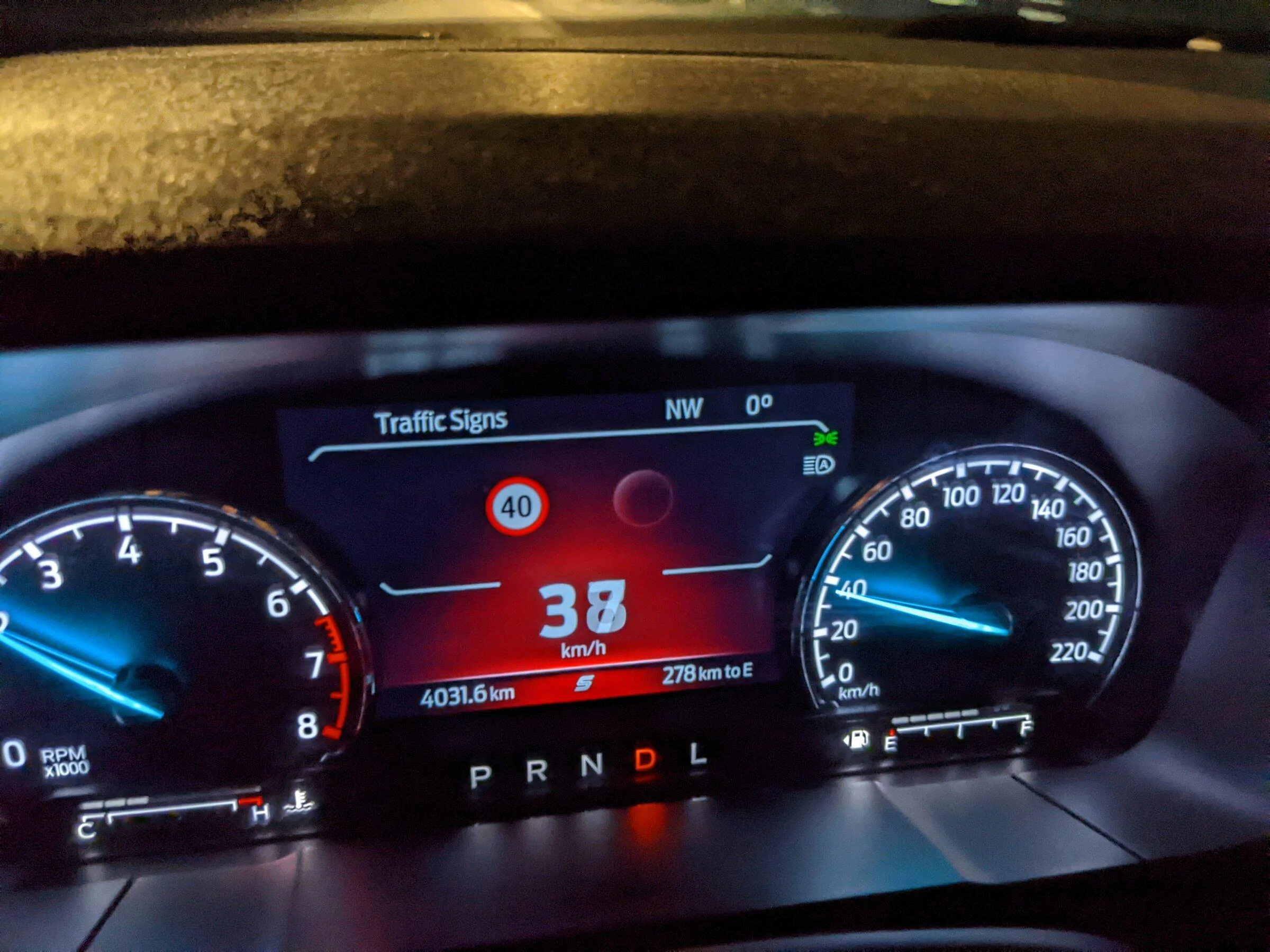

Works, confirmed. Interesting that it's showing UK-style signs on the dash. Some of the screenshots I found for the Escape Platinum show the correct sign icons....so maybe there's a sign region adjustment in the IPC?
There are NCAP settings also that may be involved here. All rhese settings are in the IPC module.
For your overspeed tolerances do you get an above and below 65 kmph or a single tolerance?
Depending which the setting for that is at 720-10-01
It should be at x*xx-xxxx-xxxx.
Just change the * with different values until you get a single or tolerance setting or double if vice versa.
There is also another value that changes at least on mine where the speed limit writing is on the sign.
It was at either at
720-09-01
xxxx-xxxx-*xxx
or
720-09-02
*xxx-xxxx-xxxx
You'll have to play with the values for each to see it changes the signs or not.

What does that off road menu show when you check it?
