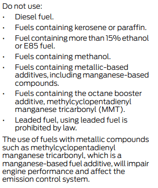

I have settled in to using Lucas fuel treatment in my small engines about 1.25-1.5 oz / 5 gal. 24hp Kohler riding mower runs much better since started using it, apparently keeps cleaner etc. Thinking about using it in maverick. I read some thread in which someone had either posted page, if I remember correctly, out of user manual that while not recommending use of additive or forbidding use stated that no additive used should contain "a specific compound? Metal(I believe)? As it could impare function of catalytic converter. Or maybe he had just posted a link to manual. I intend to research Lucas further when I get my XLT.
