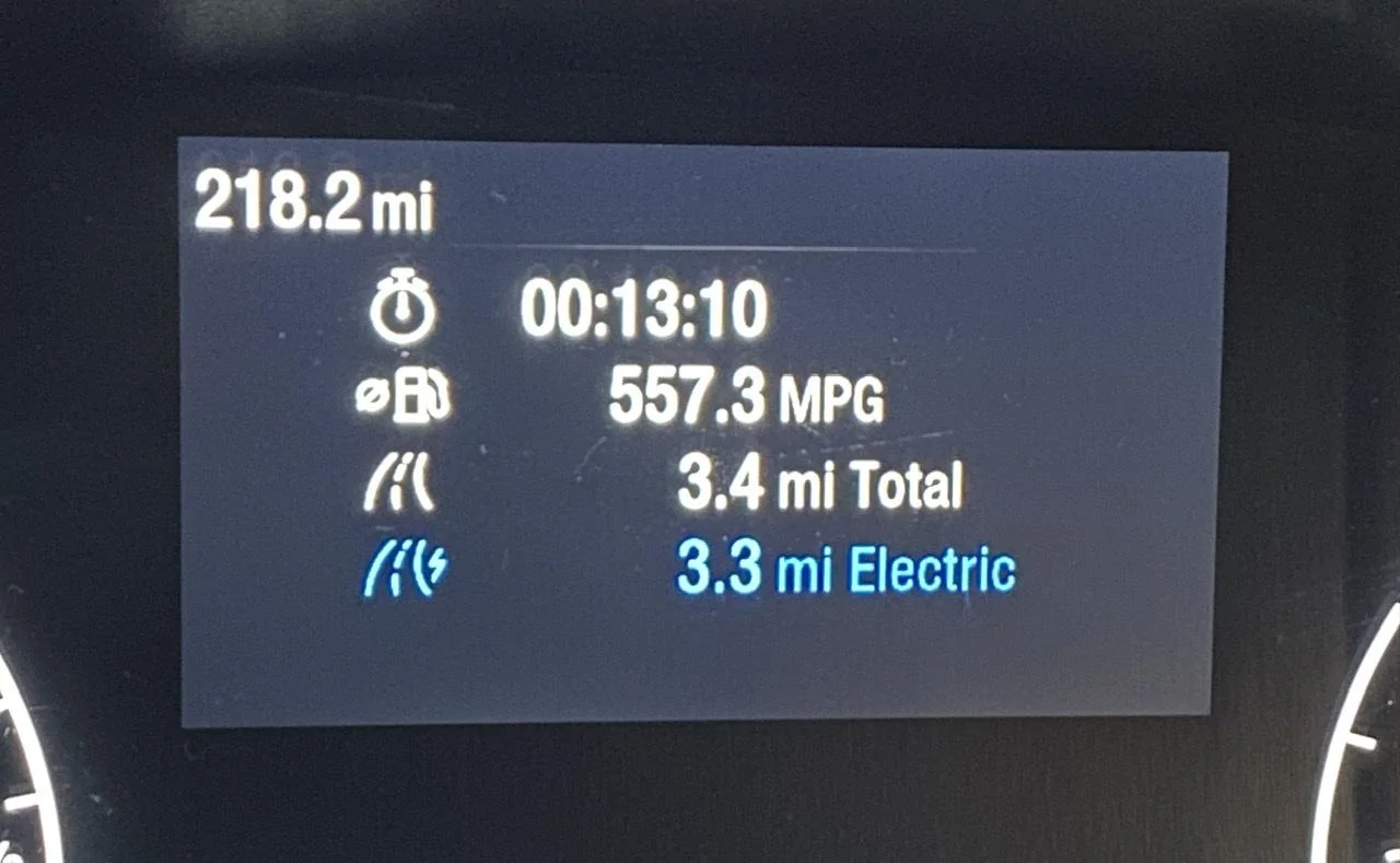

Ford Maverick When does the Hybrid Maverick use electric only vs. gas only vs. both? PXL_20230530_183319670

I live in mildly hilly South Carolina and my commute is mostly truck routes with 60 mph speed limit. I use cruise control as often as possible, and on any flat stretch or slight downslope I click the cruise button down 2 mph quickly which will normally throw it into EV mode, then quickly click back up 2 mph to maintain speed. This method gets me a lot more EV usage out of the truck than it will do by itself.

THE TORQUE for reverse only comes from the electric traction motor. But since you also have a generator on board you can drive in reverse for as long as you have gasoline on board.
FWIW at 25 mph and under you can drive 3.3 miles on level ground, on a "full" battery. Full = 70%. But that 70% almost never occurs. As stated above, the battery is usually about "half" changed.
Therefore a reasonable expectation is about 1.6 miles of travel at 25 mph from battery power alone. The gas comes on every time the battery hits 30%.
Some things are just good to know. This is one of them. But I needed an external meter to know when my battery was at 70%.
