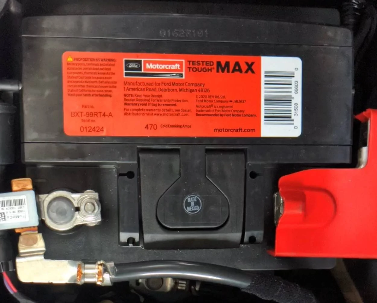

I have a 2023 Maverick Lariat Hybrid that I recently bought that has 15k on it. It has original motor craft battery. I have been getting battery saver mode when I don’t drive for a couple days. I just reset BSM and it went off. Just wondering if anybody replaced standard battery with agm and problems then resolved for good. Standard replacement battery vs agm. What are your experiences? Thank you in advance

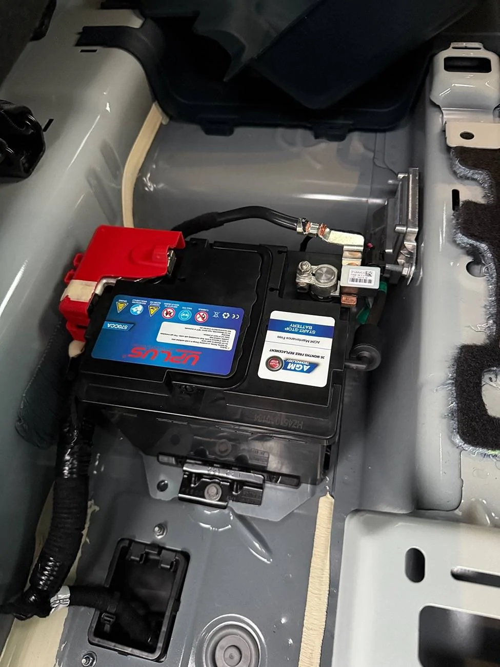

I am having trouble finding the right agm battery , as size seems to be the problem....can you guys give me some exact battery maker and the battery numbers that will fit....delco , Walmart and others....when I put * 2023 hybrid maverick * in they keep saying * will not fit * ty

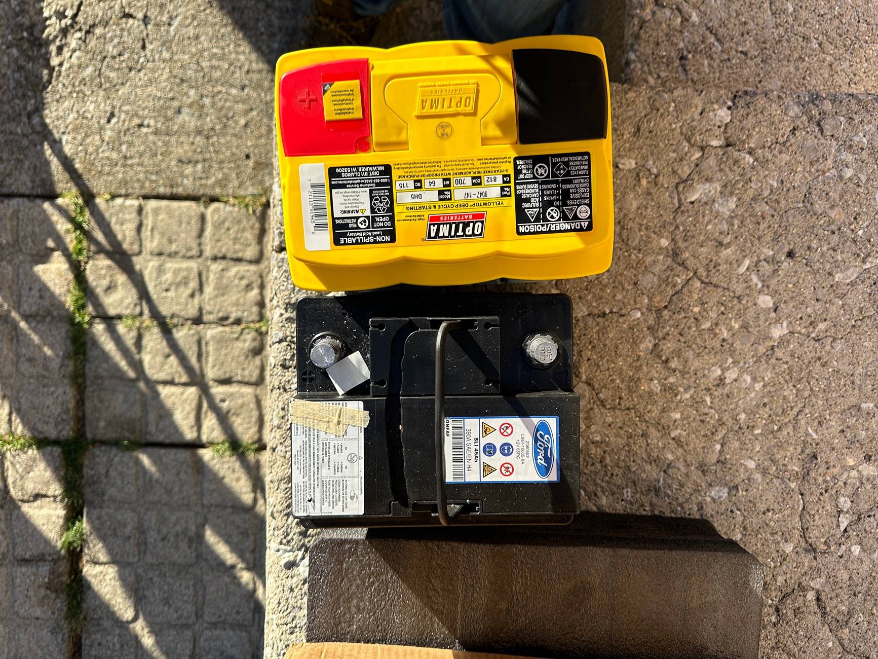

I ordered this after someone else on here did all the research (140r)
I get it tomorrow and can take pics of it next to the factory one and installed if you’d like.
https://a.co/d/atTXR5D
Ty oxhb619 and curtisb....pictures would be great ....140r and then there is also h #s like h4 h5 h6 and group #s it's so confusing....also I would like to know where I can buy it locally... Walmart, napa, autozone. Ect. Ty
Here ya go. I just put it in yesterday. Fits like the OEM. It is this one. The same one OXHB619 ordered.

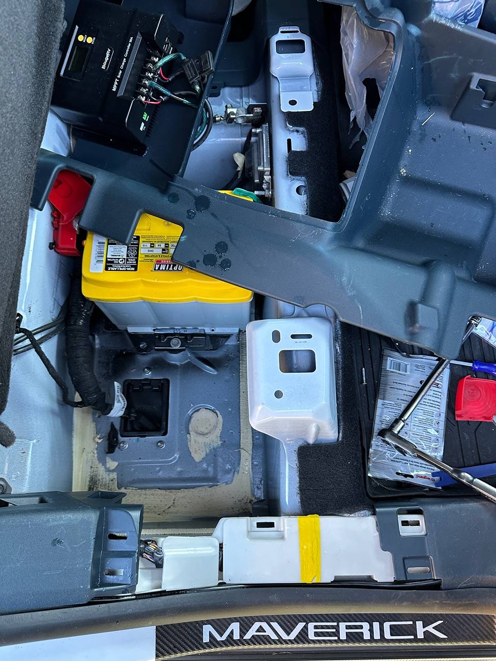

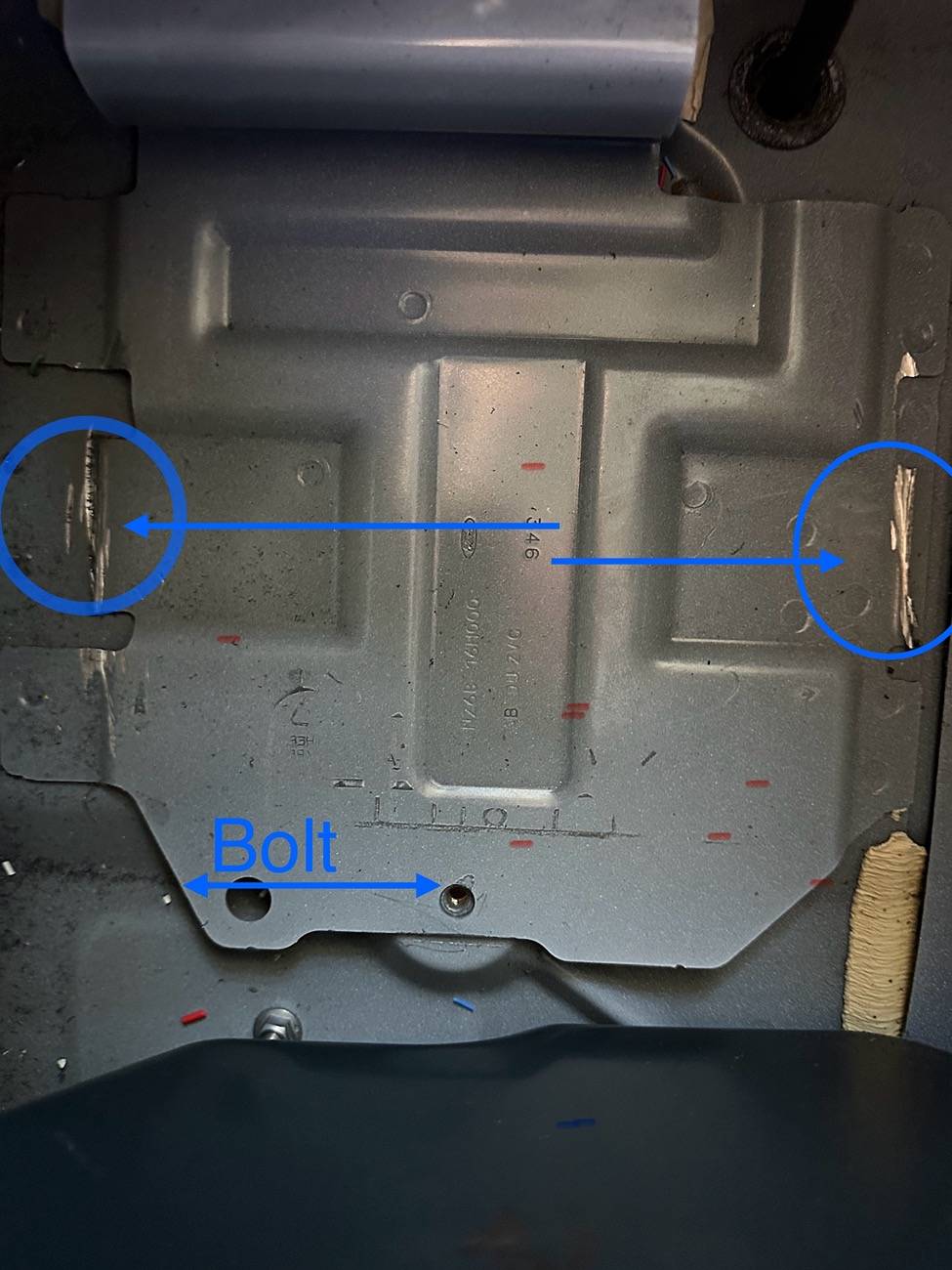

I also would advise that you remove the plastic surrounding the battery area before removing the old battery. It is soooo much easier to install it.
I just replaced my hybrid battery yesterday. How would you even get to the bolt on the little bracket the holds the battery down without removing the plastic? It would be impossible.

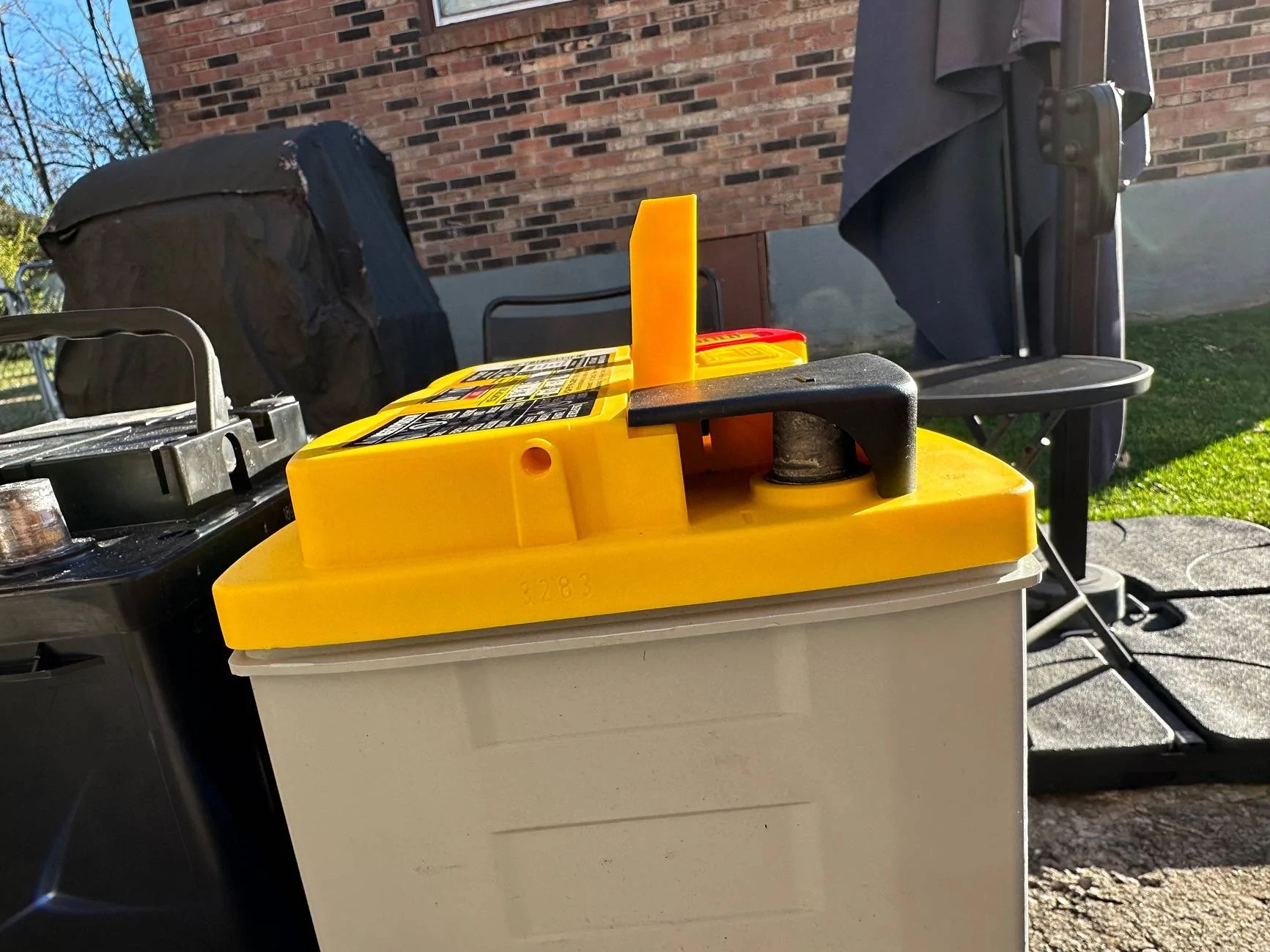

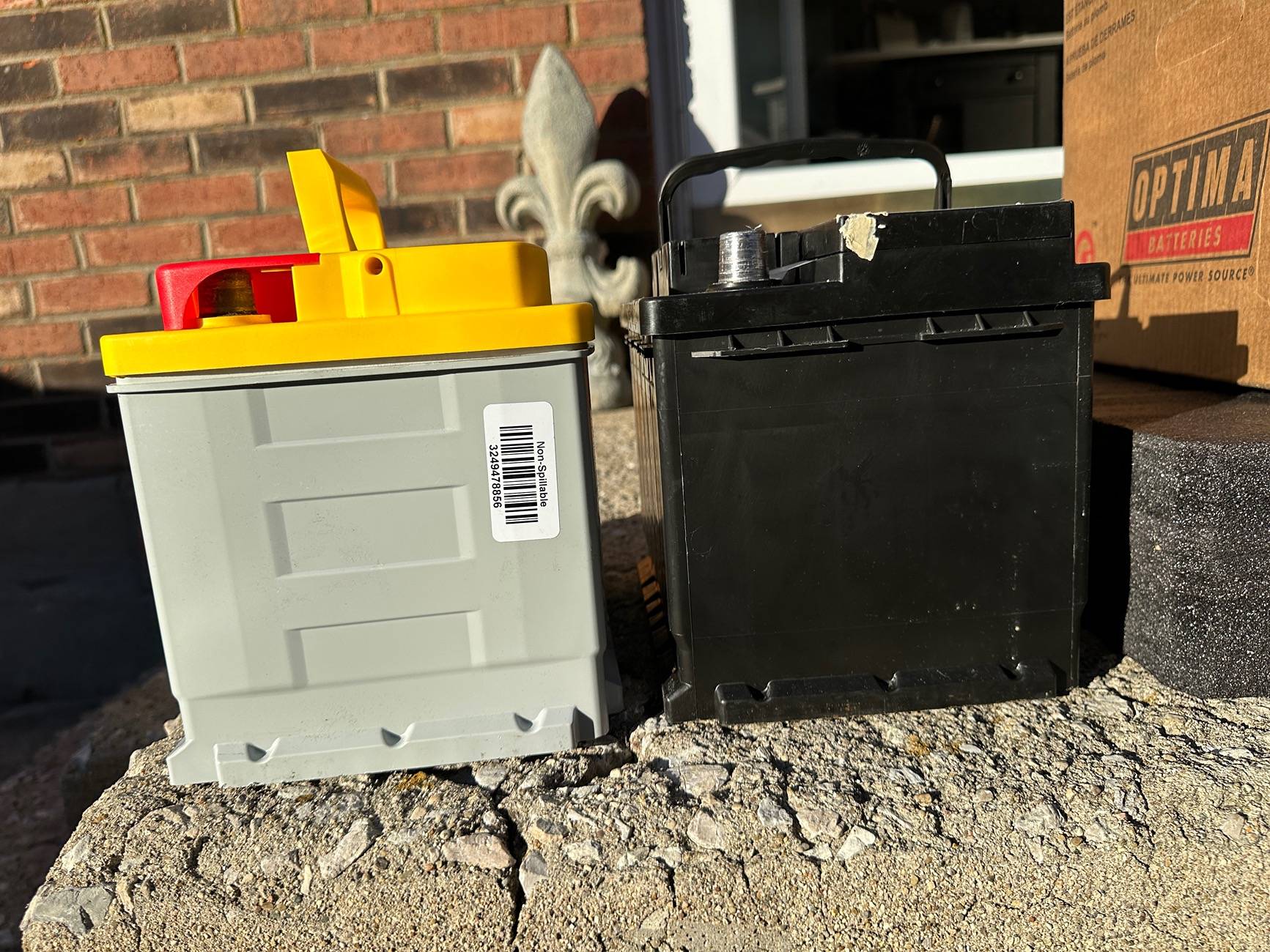

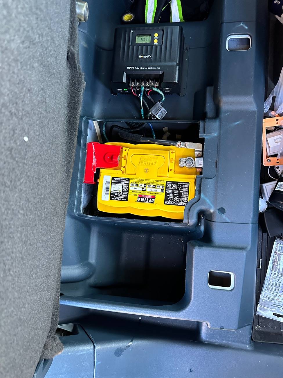

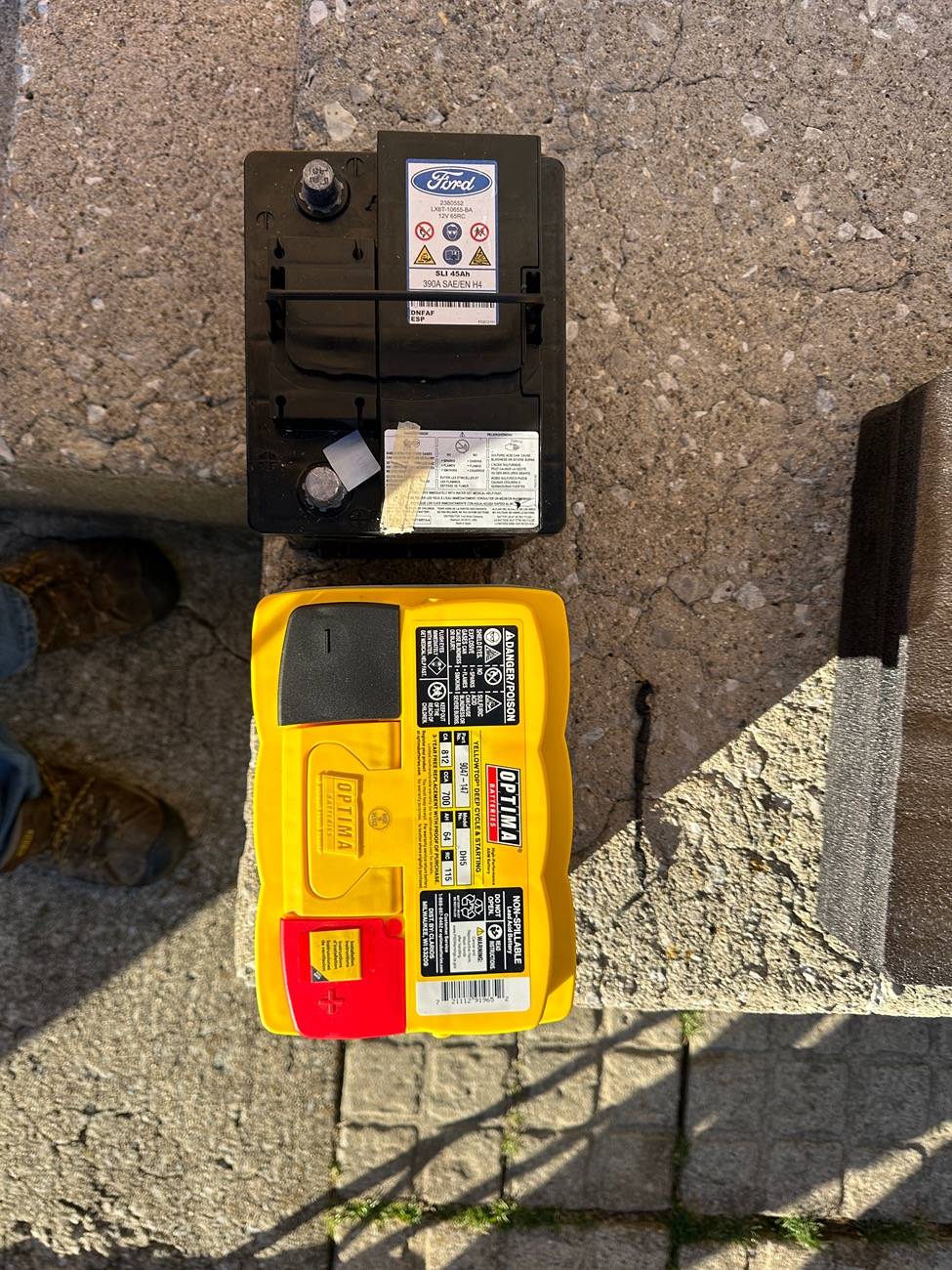

Here is my swap out, went with optima yellow top DH5. Slightly wider, no issues as the side tabs can be bent down or cut off.
I was able to swap the battery out without removing the plastic by using an extension and magnetic socket. It's definitely possible if you have the tools mentioned. If you dont have an extension and magnetic socket, then yes, best route is to remove the plastic.
