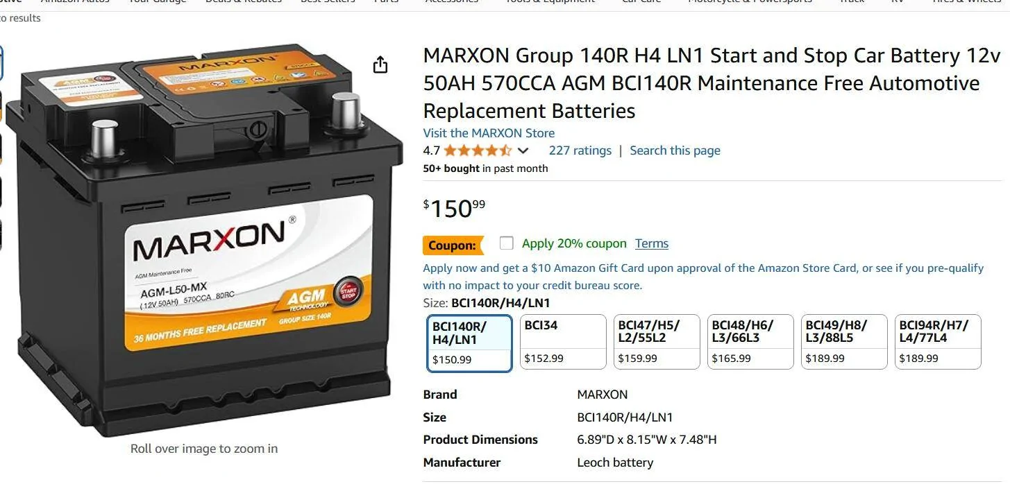

Ive seen several of these Amazon AGM batteries at very reasonable prices. As these generally carry 3 year replacement warranties what could we expect the return policy to be over say a locally purchased (more expensive) AGM? This problem just screams battery replacement within 3 years so will likely be replaced under warranty... :cautious:
Read warranties some are prorated resulting in declining payment for replacement.
