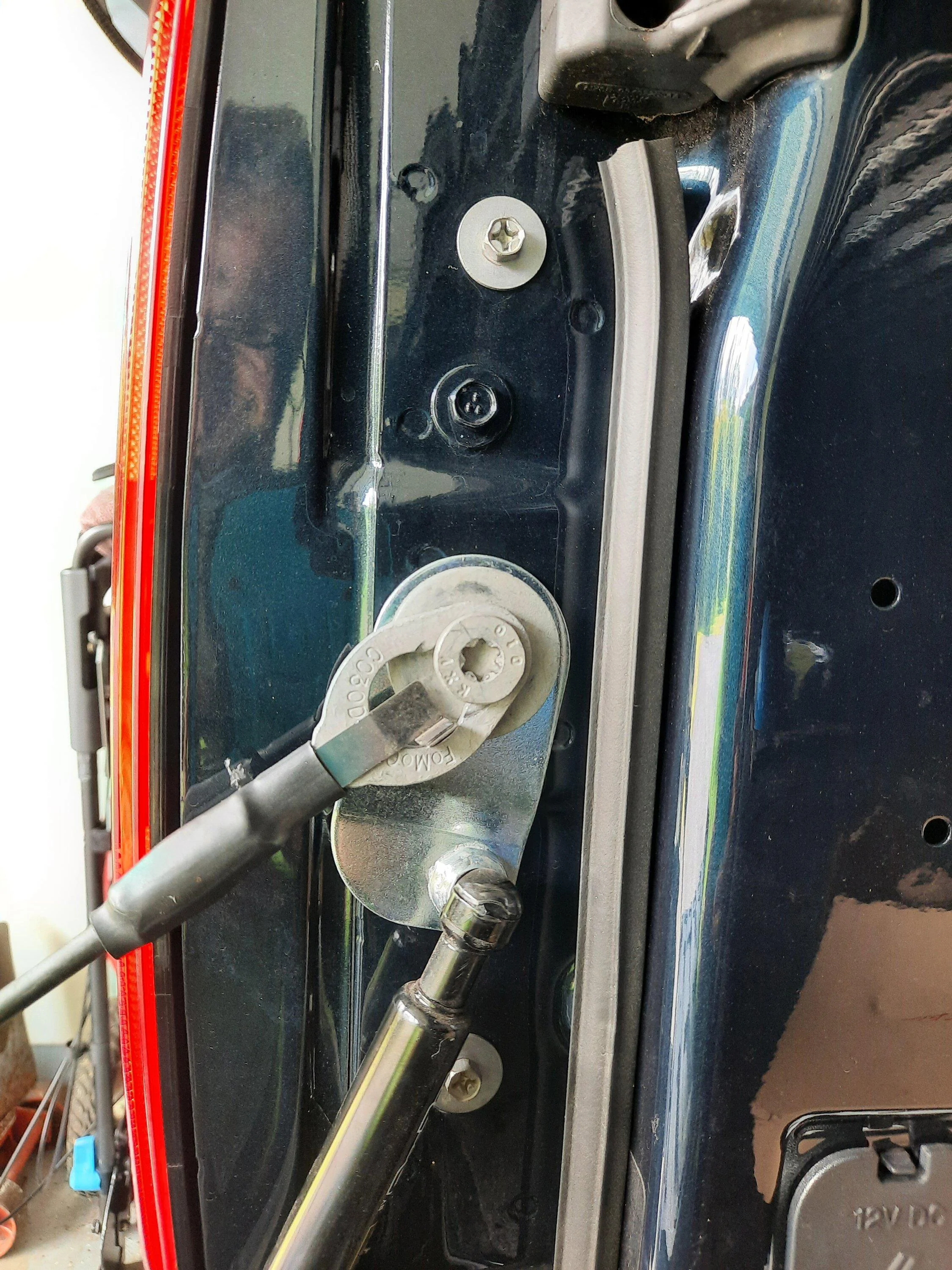

Hi, I installed my tailgate assist with the damper in the upper side and the arm to the bottom, I noticed you installed it the other way, maybe that's why you were having the issue, Mine is working fine after 2 months of use.

Your better off with the chrome end of the piston down that way it won't collect dirt and drag it into the seal prolonging its life. It will wipe the dirt off and gravity will take care of the rest.

Everyone who has stated so is correct, the barrel of the assist goes up and the rod down. There is a mechanical reasoning behind this configuration. On the inside of these gas assist shocks there is in addition to the gas, a liquid lubricant. The reasoning for the positioning is so that the lubricant can keep the rod end seal from drying out and leaking.
Excellent explanation-totally agree with you. Though I don't get why there are pics of these closers out there showing them with the rod up on other makes and models.

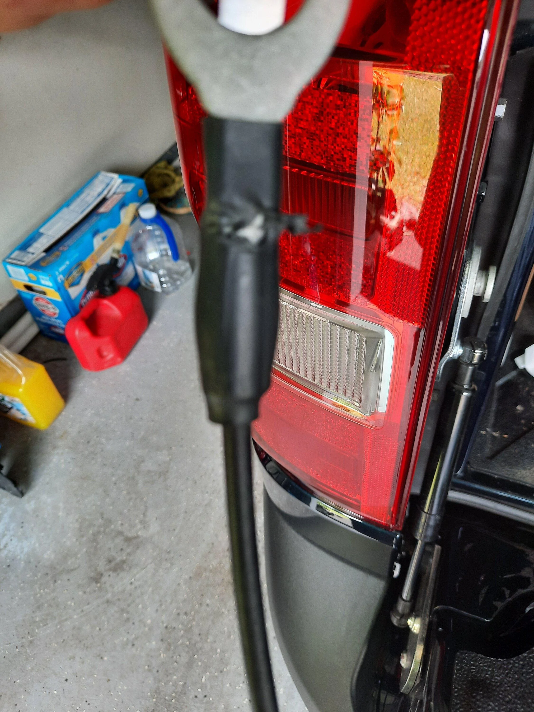

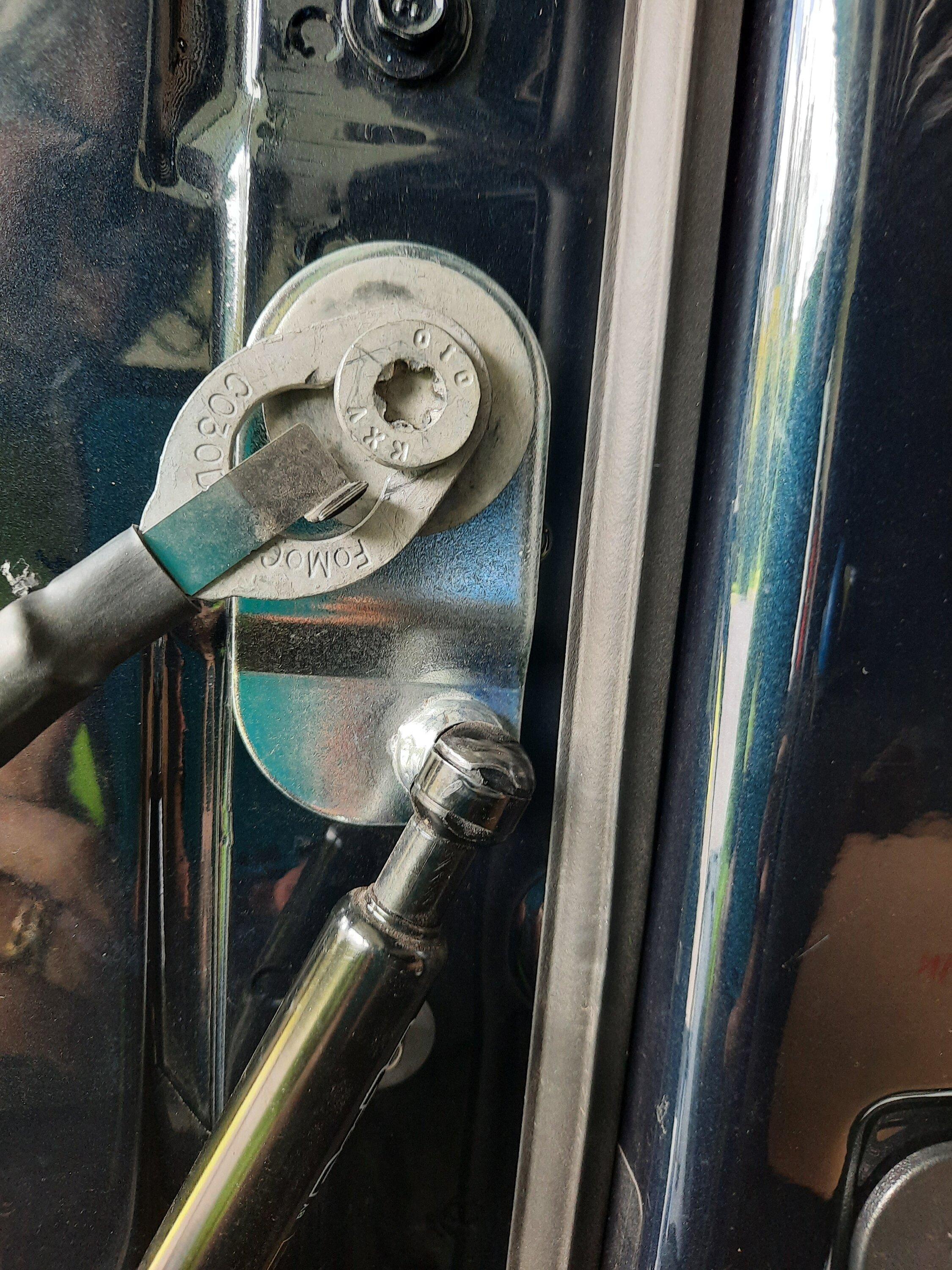

I discovered that to avoid the rubbing you have to be sure that the metal plate that the rod attaches to is exactly straight up and down. Your picture shows that the bottom of the plate is jutting out slightly towards the tailgate. Mine was at first and I experienced the rubbing. Once I reposition the plate correctly my problem was gone.
Good catch, Looks like I F'D up installing my top plate I'm getting that rubbing on the back of the cable will make the proper adjustments

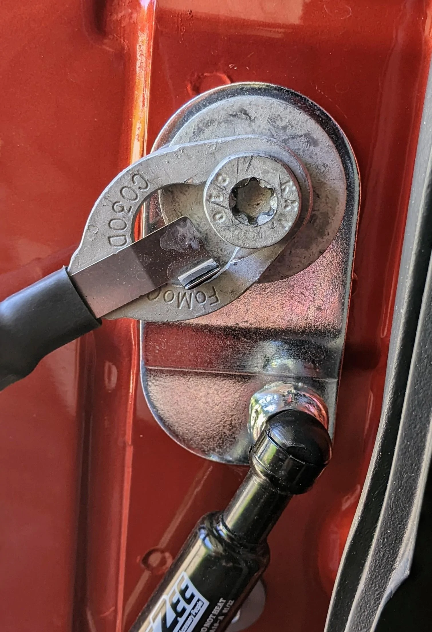

Update, Plate now straight no more cable pinching
Good catch! Thanks also for documenting and sharing with the rest of us so we can also see pictures of what it supposed to look like!

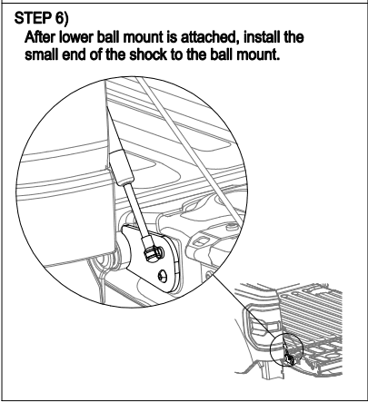

Also as you see in the picture the correct end of the soft close shock has the fat end up
