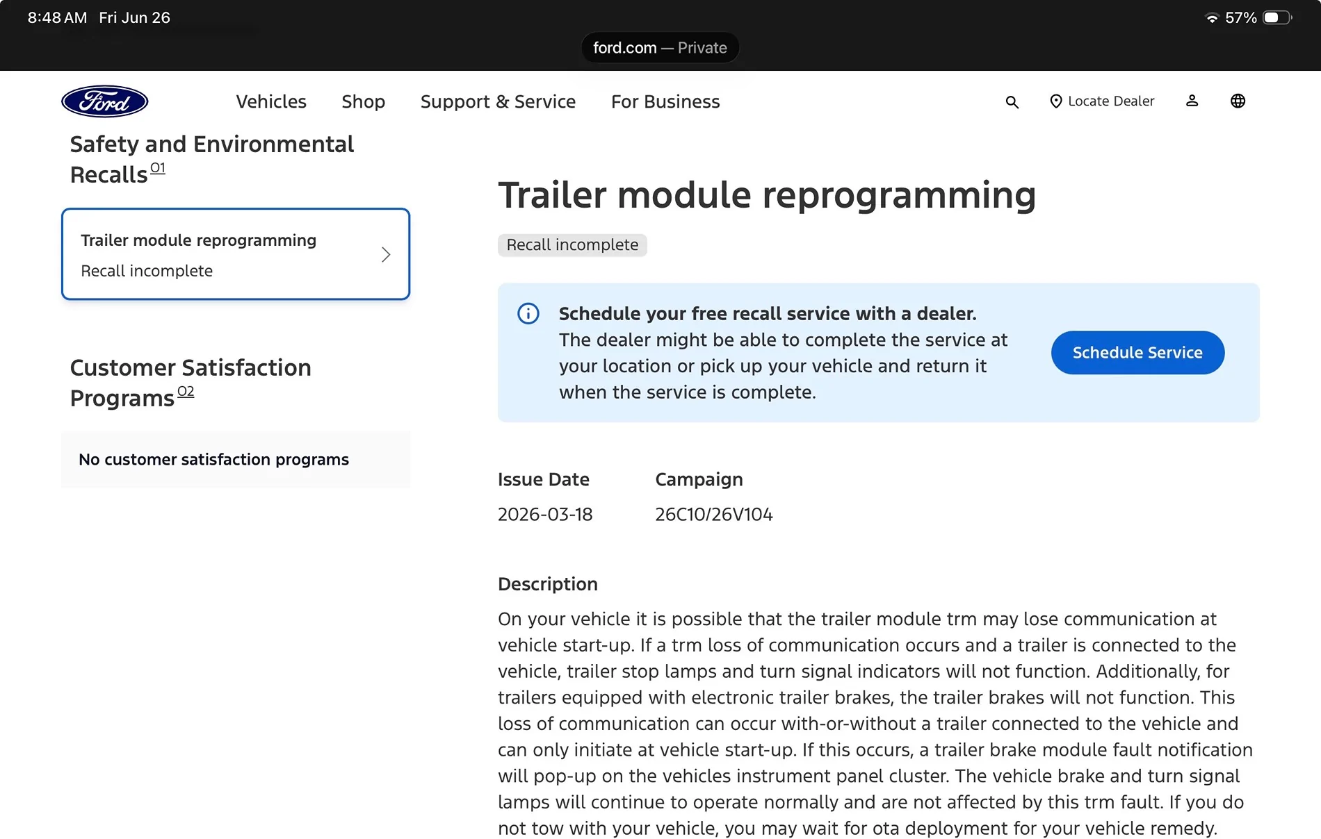

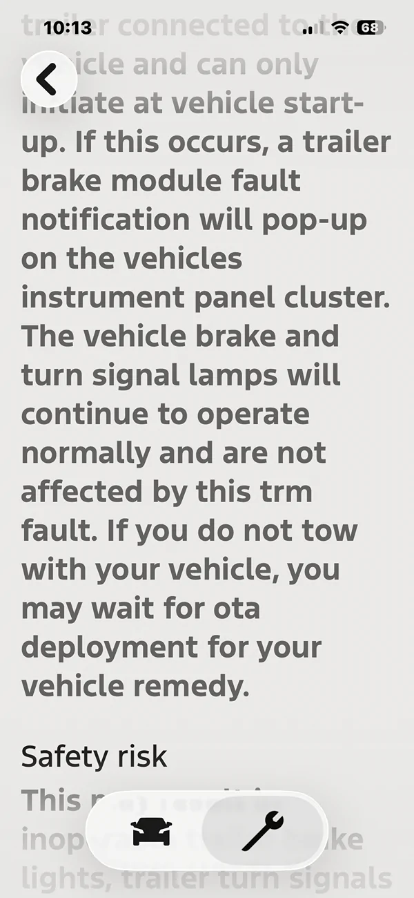

My dealer just called for what was suppose to be the rear lighting fix on tows. She said you need to bring it in now…. I don’t tow. She said,,,, oh, it is not just towing, you might might have rear signals and your dash isnt telling you. Just a heads up.
This was one of those exceedingly rare instances where the person you spoke to was MISTAKEN.
Apparently, her reading comprehension wasn't all that great either...
Maybe find a new dealer...
