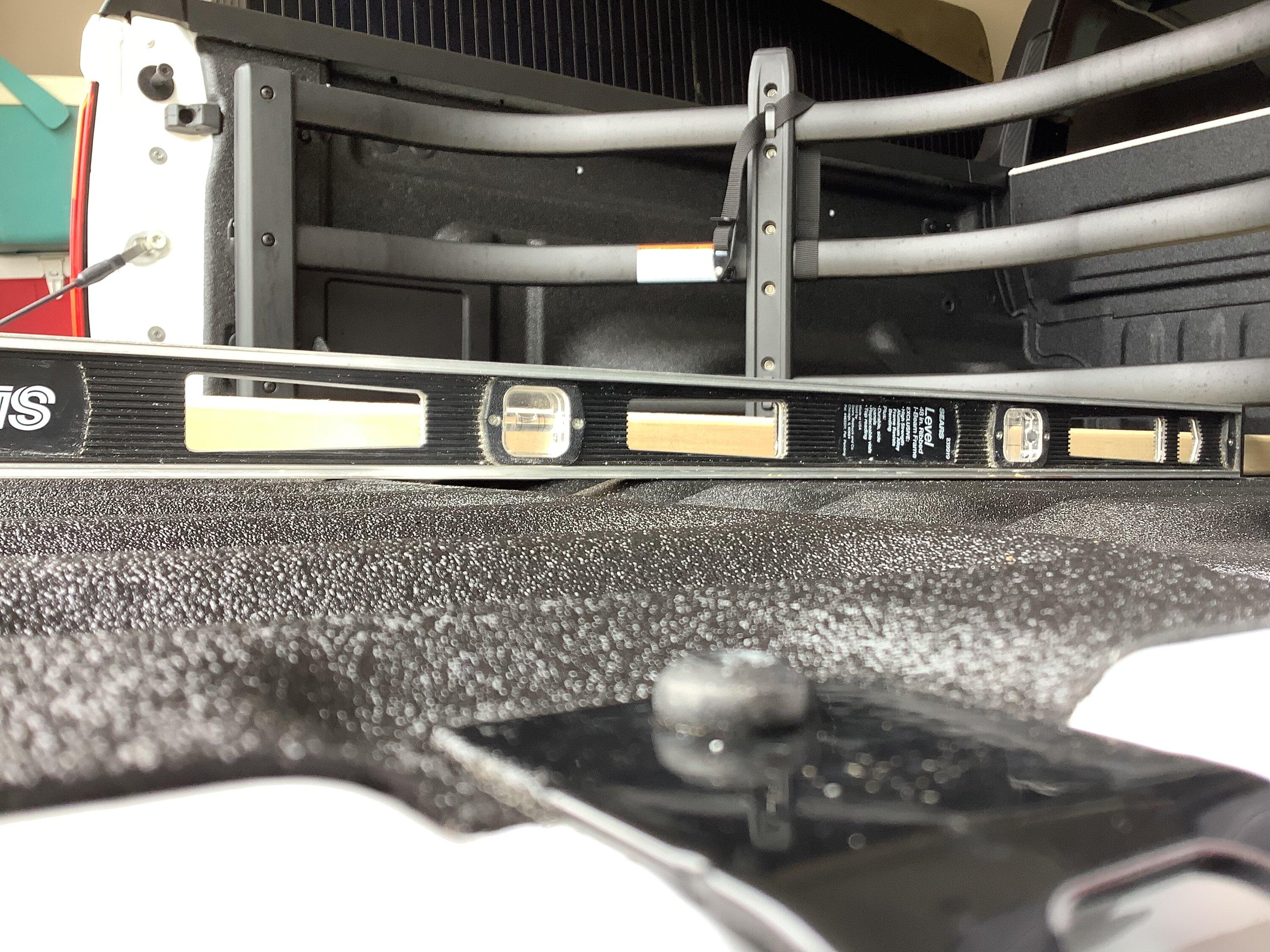

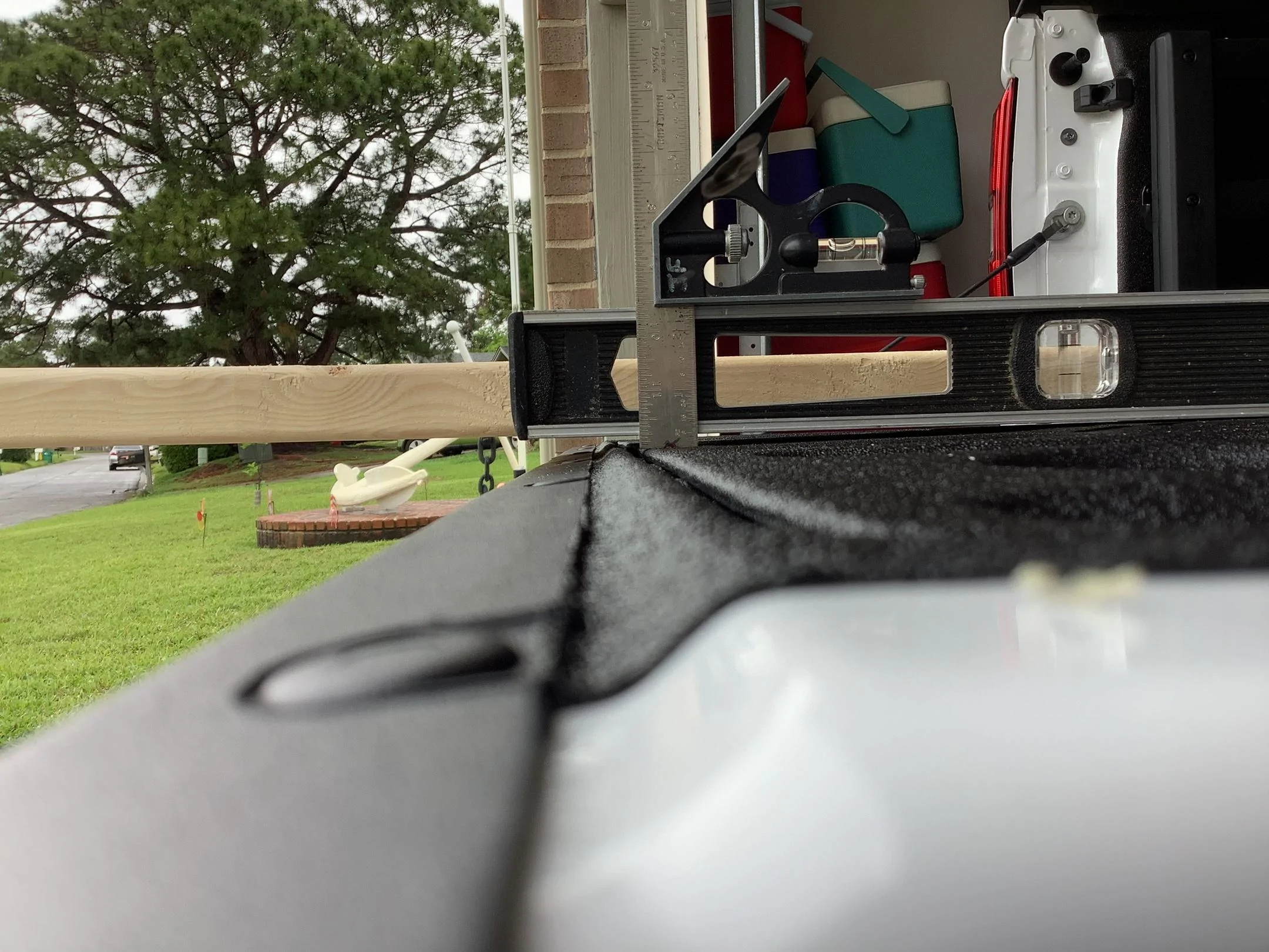

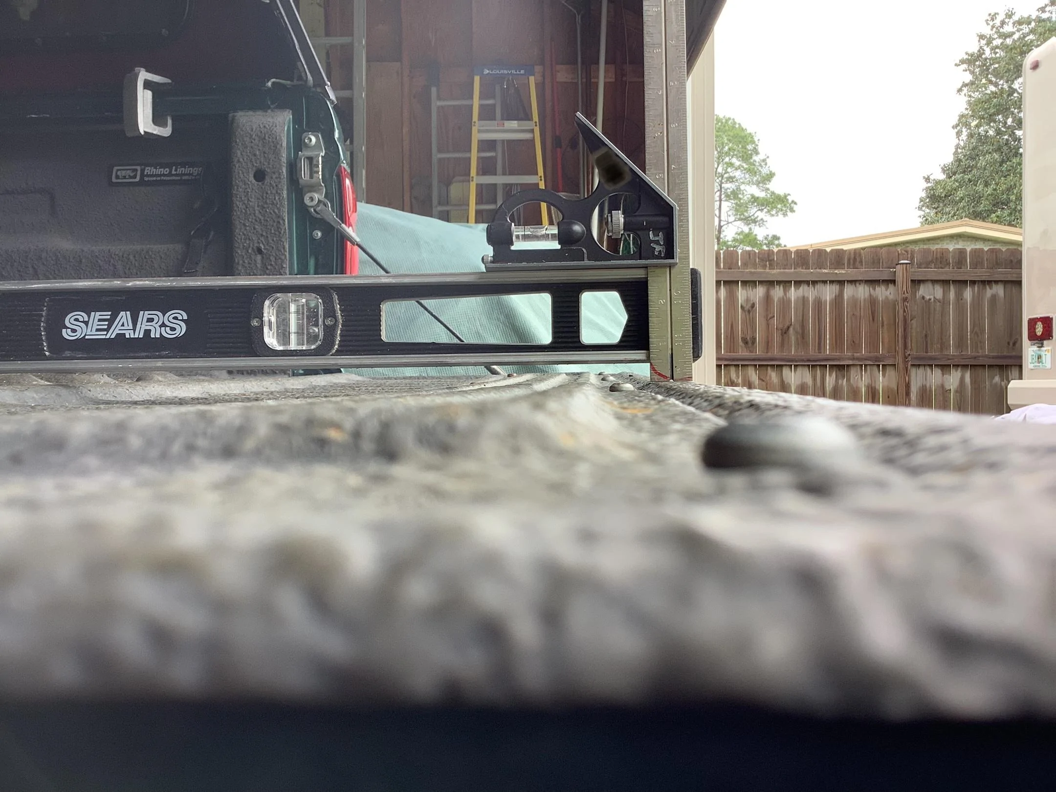

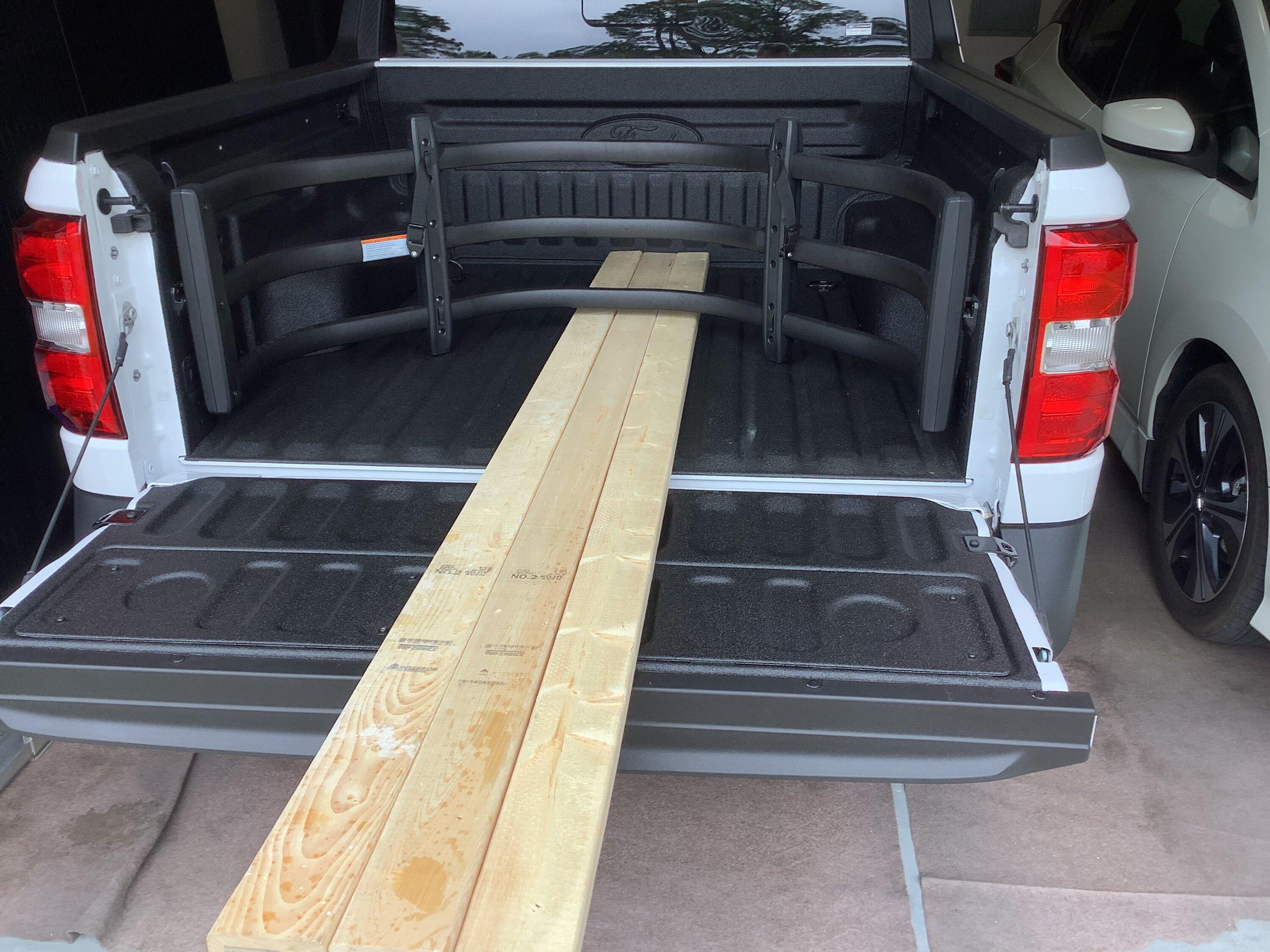

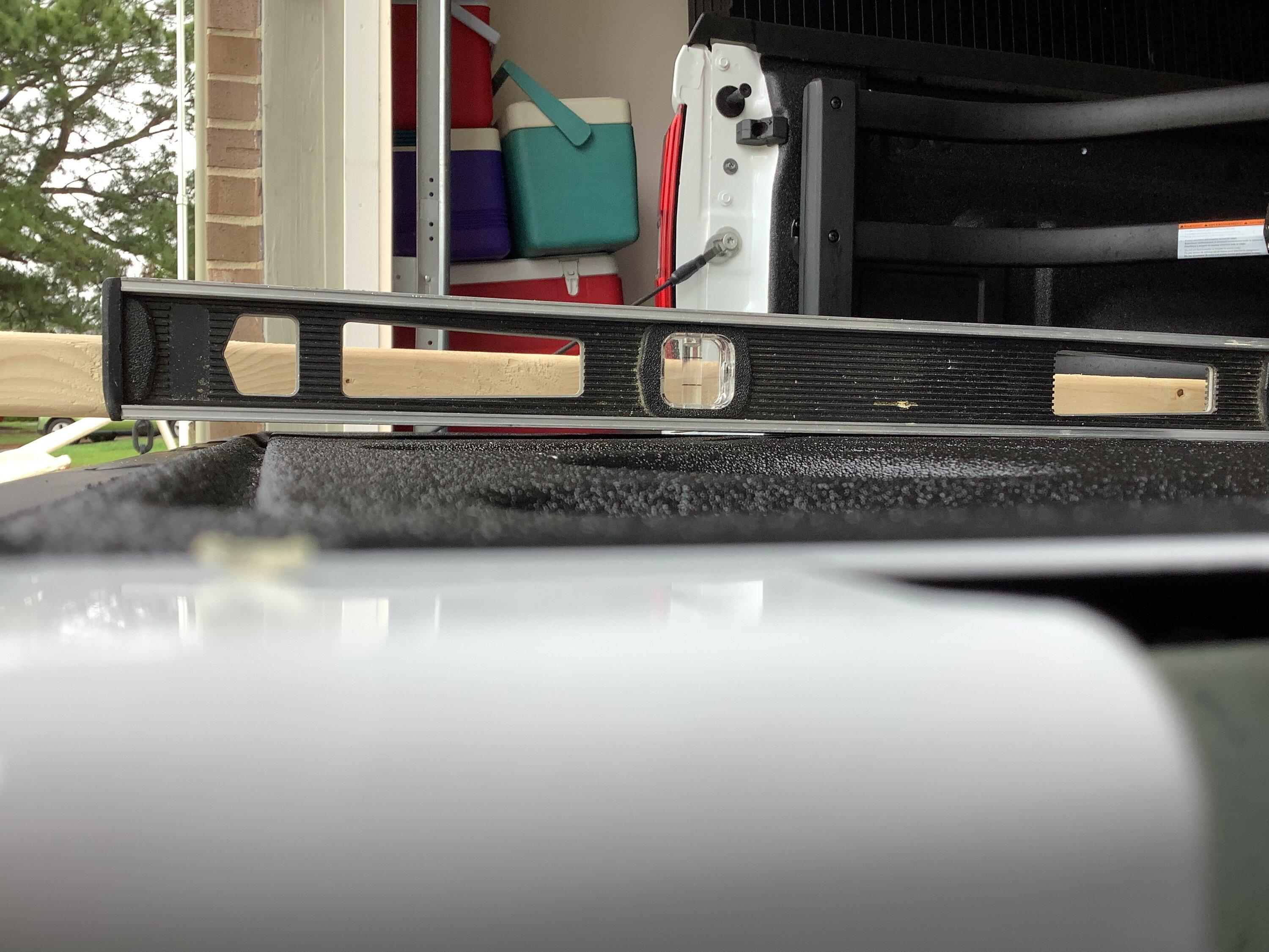

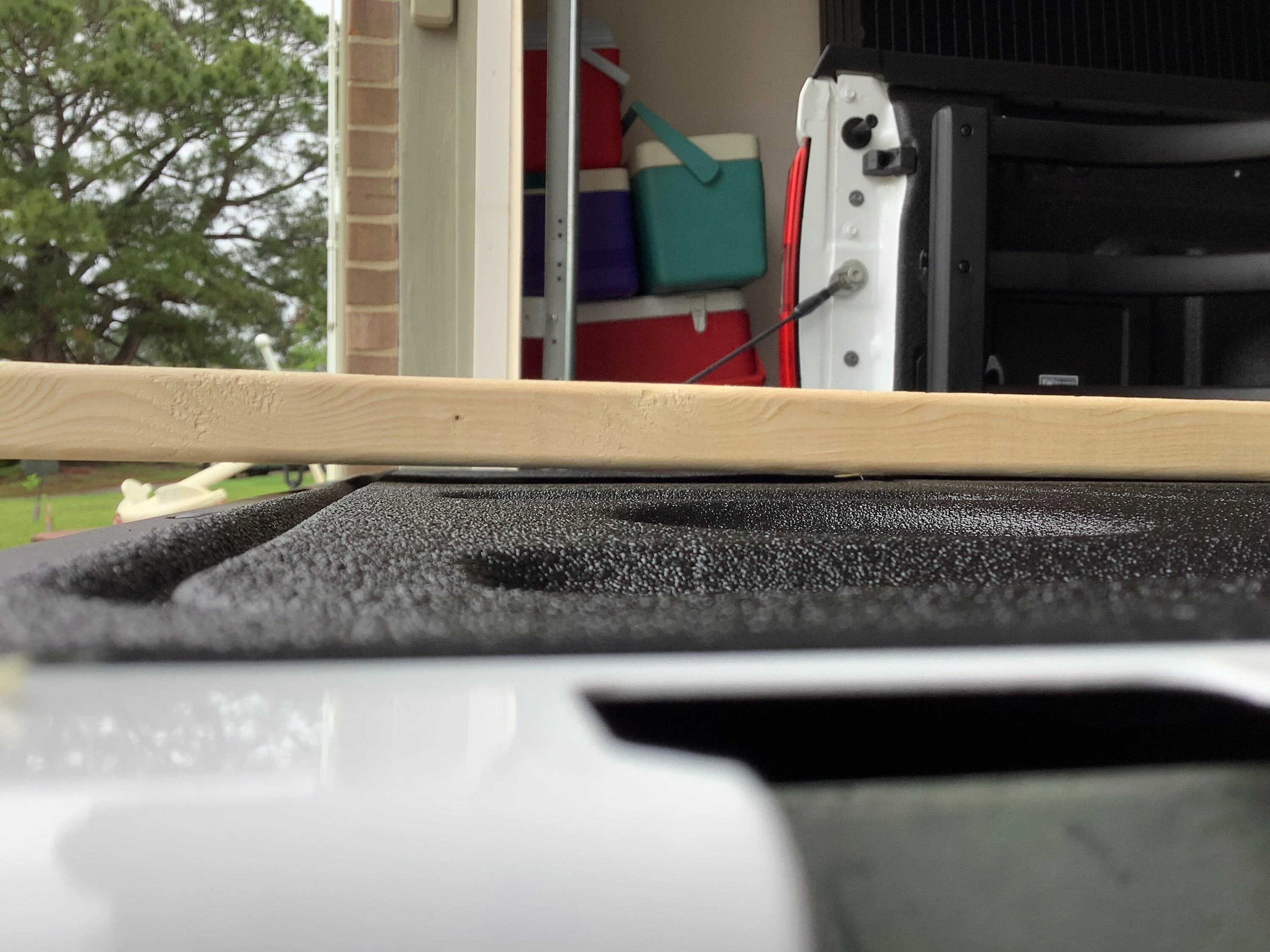

Would you take a pic with a 2x4, level, or whatever flat-ish object across the bed and tailgate and share if your 2023 model is indeed coplanar?
Uh oh. So, I eye balled it at the dealer and it looked fine. Per your request I did the 2x4 and level check. $@it. The front of the tailgate is coplaner with the bed dead on. The rear is about 1/4” low. Dang it. I’ll be looking to get slightly shorter cables. I also attached one pic of my 2000 Ranger tailgate….it’s 7/16 of an inch lower. Now I gotta fix em both. ugh. Lol.

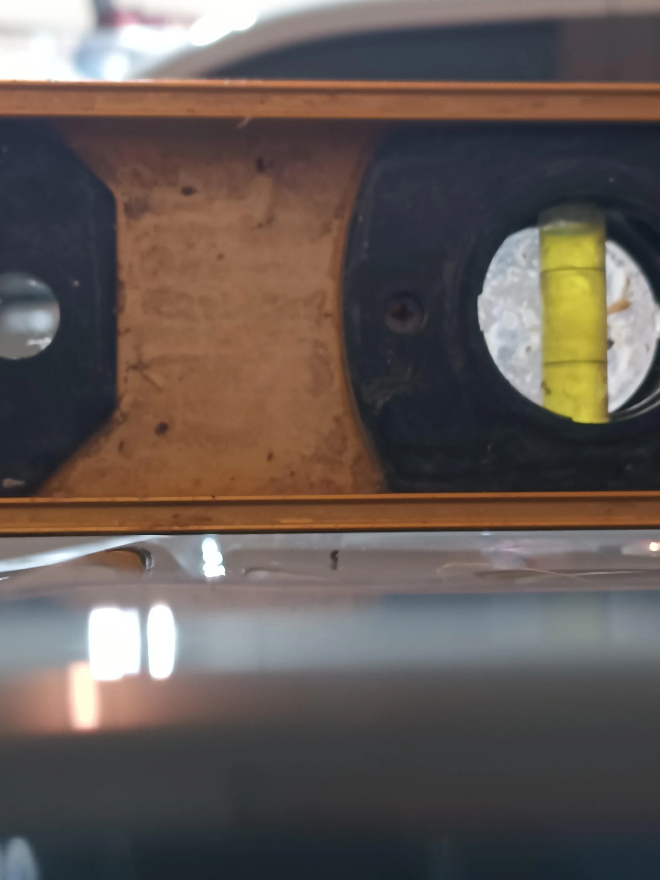

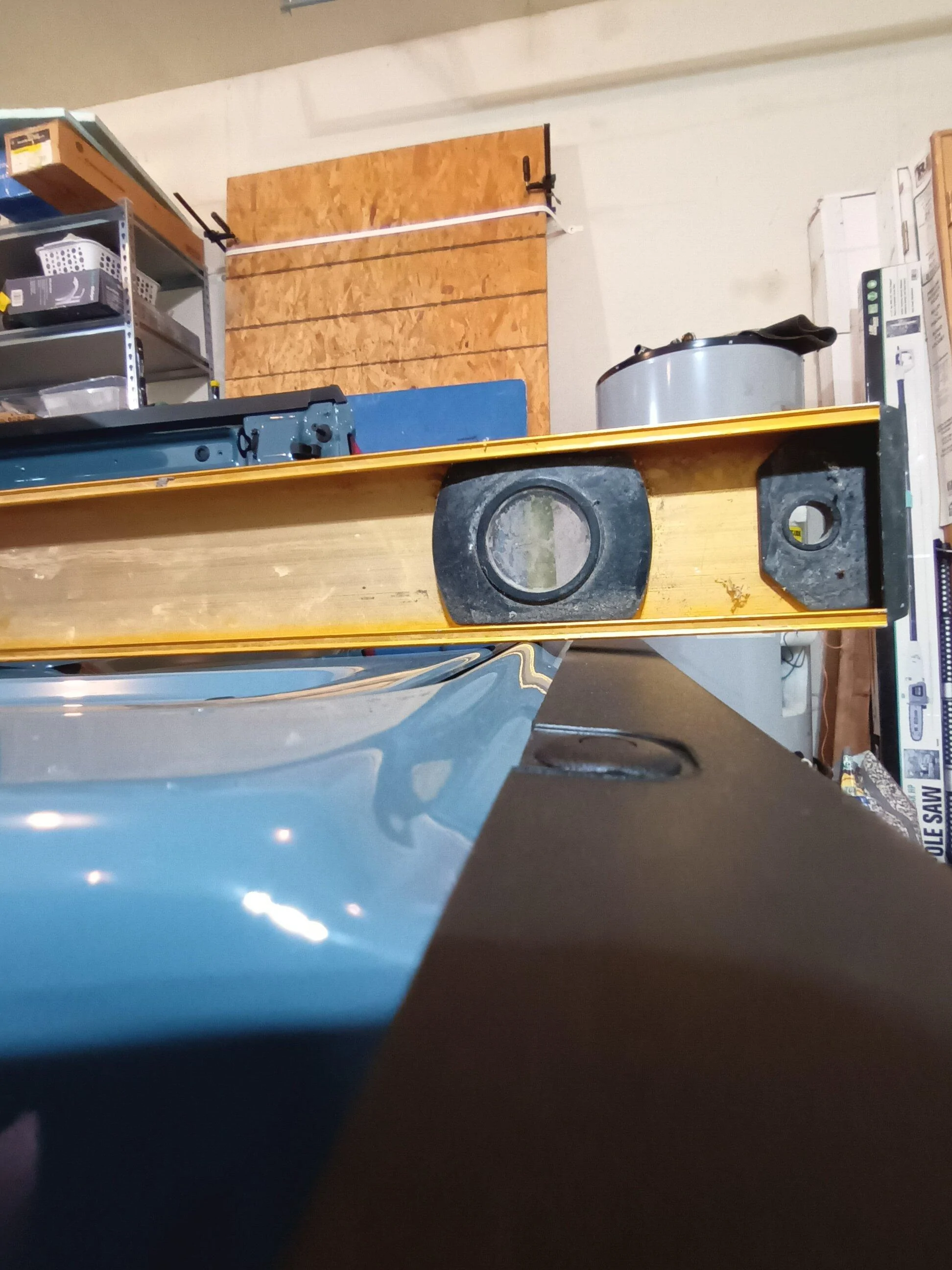

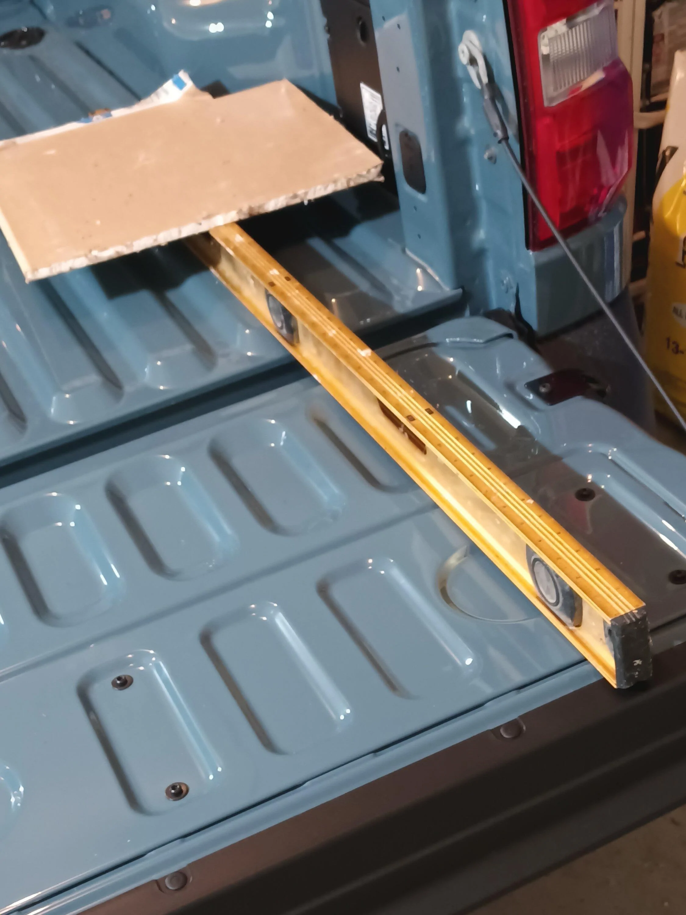

OK went and checked my hybrid 23 XLT vin 19nnn delivered Feb 2023 drivers side is spot on cable is tight, passenger side cable is almost snug but I had anti theft factory hinge lock installed and hinge side of tailgate is ever so slightly high (see pics)
