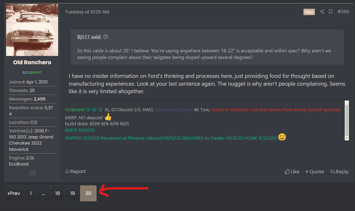

clavicus
Jun 21, 2021
1,484
2,061
I have no insider information on Ford's thinking and processes here, just providing food for thought based on manufacturing experiences. Look at your last sentence again. The nugget is why aren't people complaining. Seems like it is very limited altogether.
Ford Maverick Tailgate not level with bed. 1680289198408
