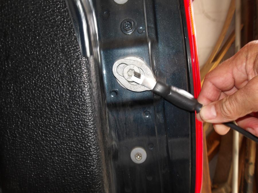

Just checked my 2022 XLT and the tailgate hangs about 1" too low with the driver's side cable being about 1/2" too long at 21 3/4" compared to the pass side cable.
The original 2022 had this problem. The dealer will replace with a matching set. How old is your truck? If one is too short it may be that one is out of position. But one too long? I bet it's just mfg error.

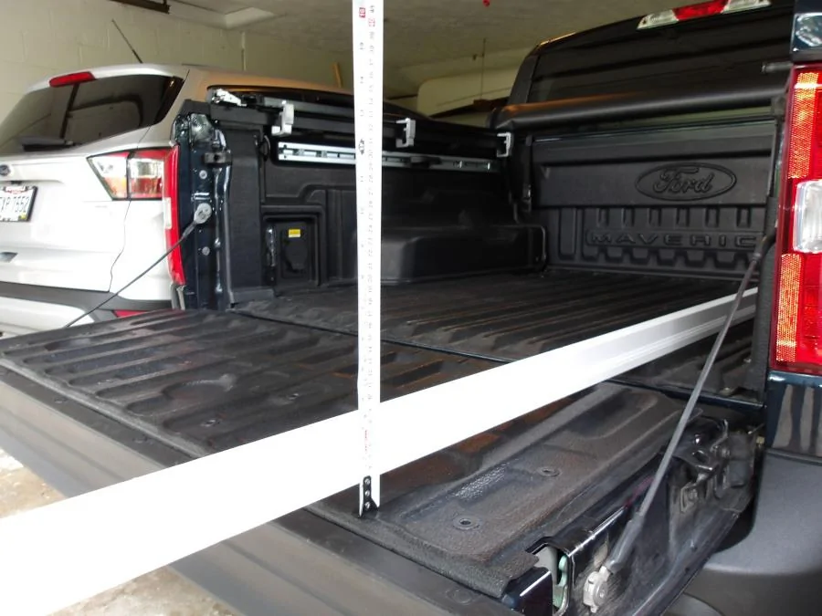

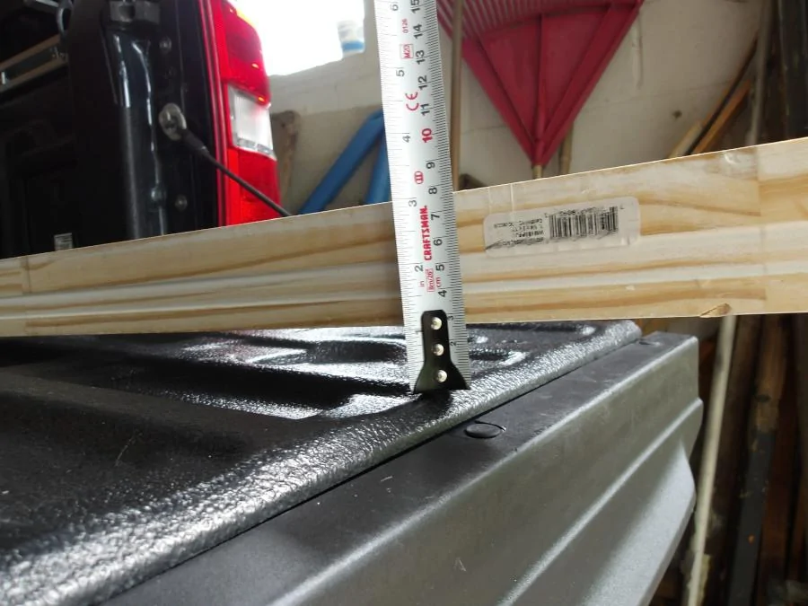

Probably MFG error. Both are too long actually. It's a 2022.

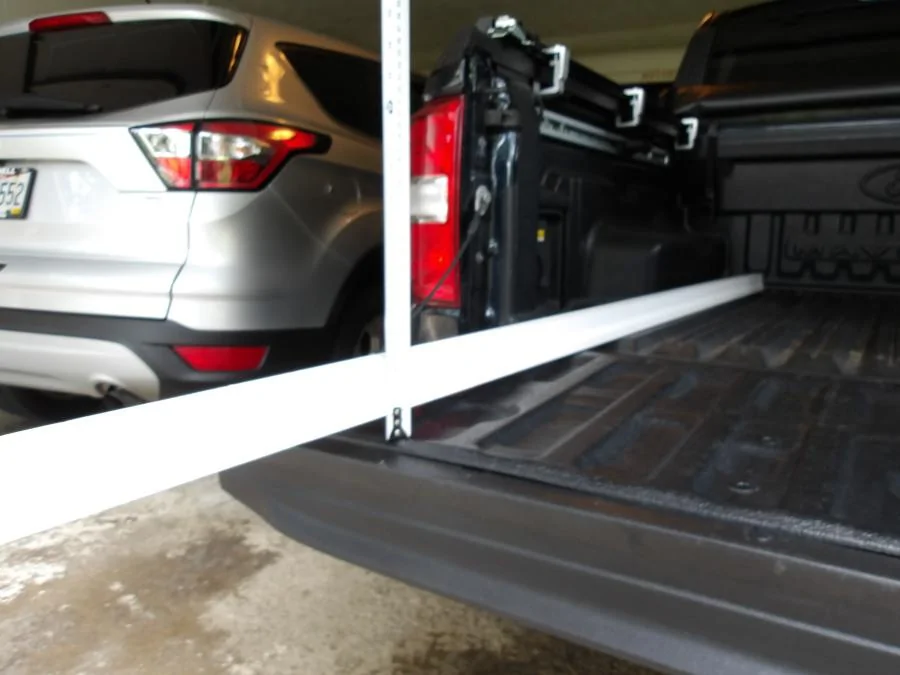

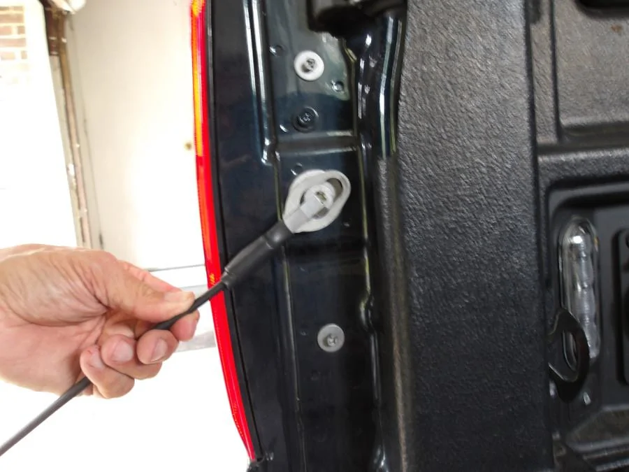

With the tailgate hanging down all the way, the Drivers side is too LONG in comparison to the passenger side by this amount:
Ford Maverick Tailgate not level with bed. 100_1119_S
and THEN f I bring up the tailgate to level with the bed, the passenger side is too long by the amount in the next image. So both cables are too long. These cables are very strong and nothing looks to have been moved. So, they most likely can't stretch without applying enough weight on the tailgate and not damage things.
(I'm very carefully wording this to be accurate) :
Ford Maverick Tailgate not level with bed. 100_1112_S
Ford Maverick Tailgate not level with bed. 100_1113_S
Ford Maverick Tailgate not level with bed. 100_1115_S

Ok you got the bad cables. Dealer will replace with correct ones. (Or at least they were)

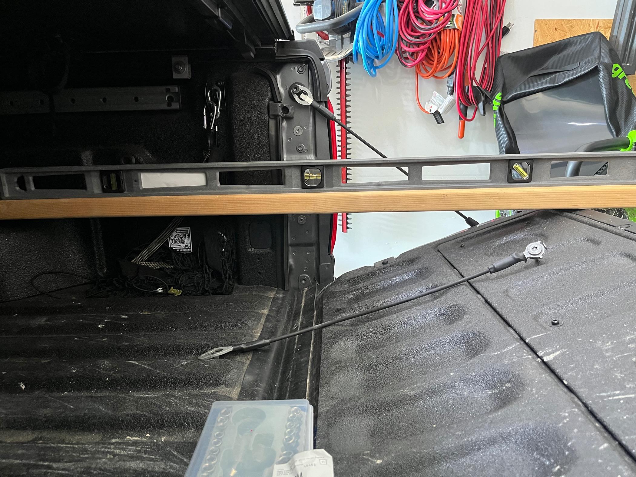

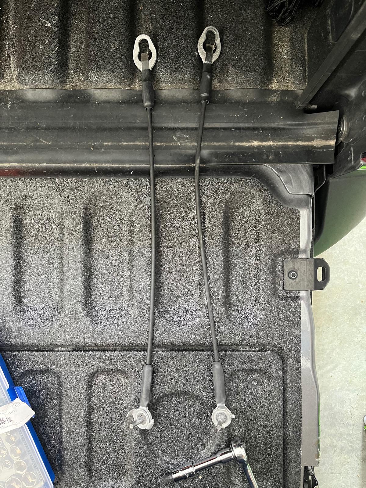

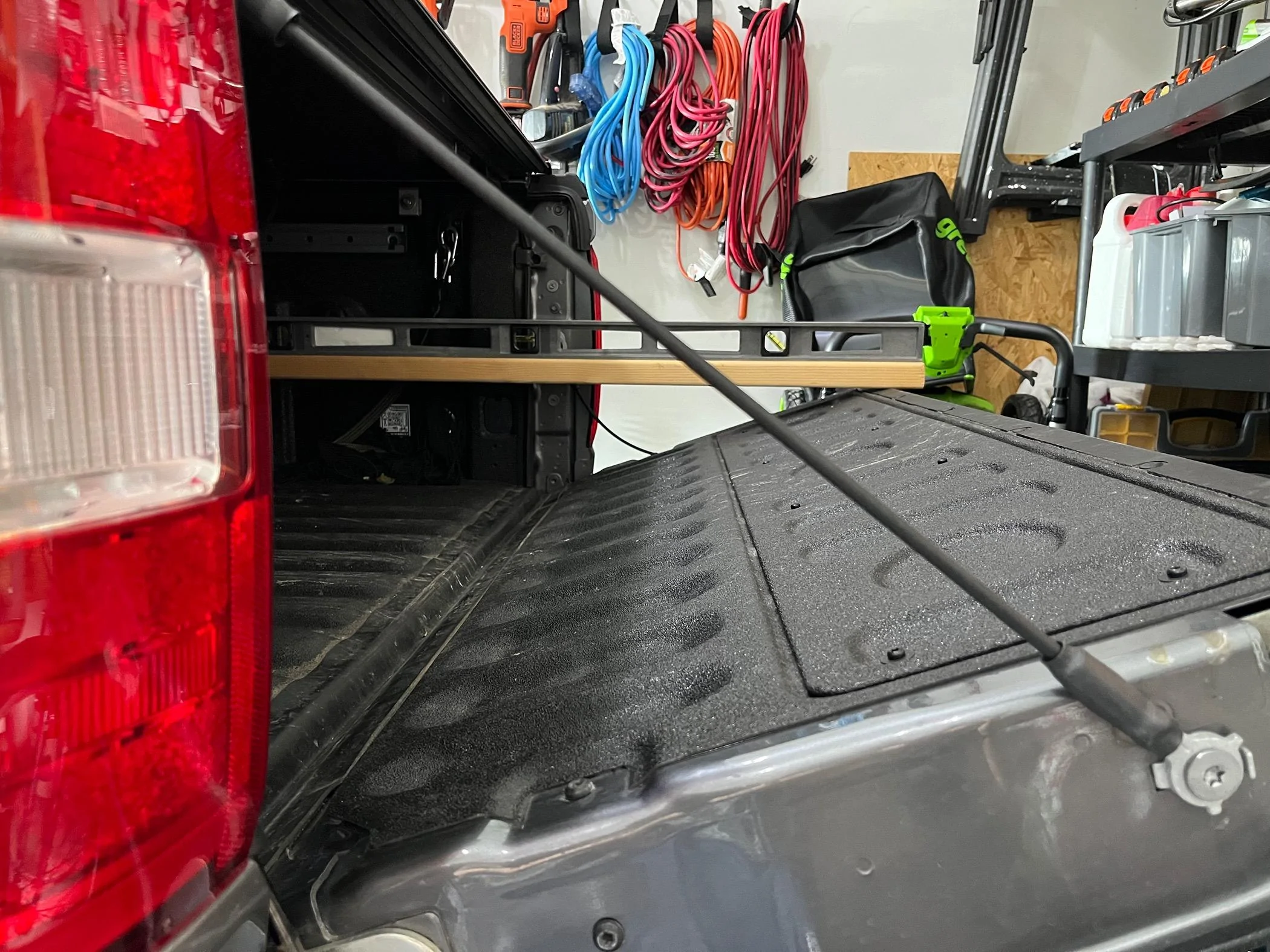

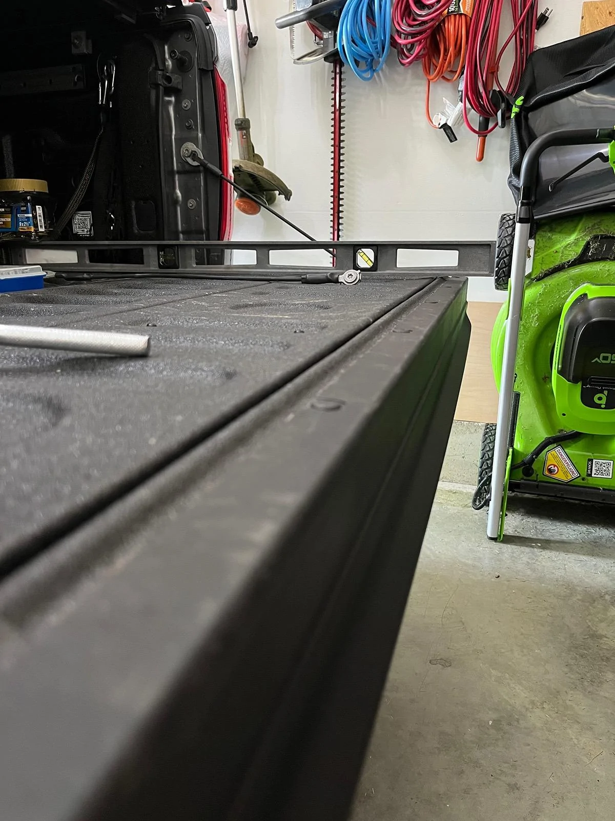

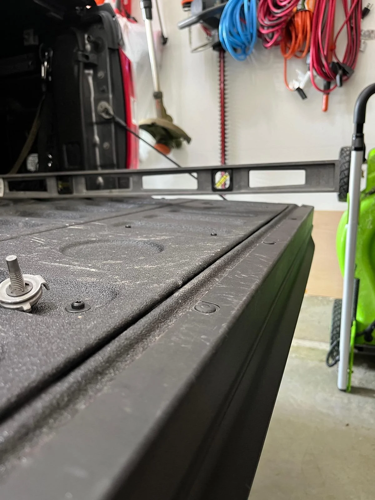

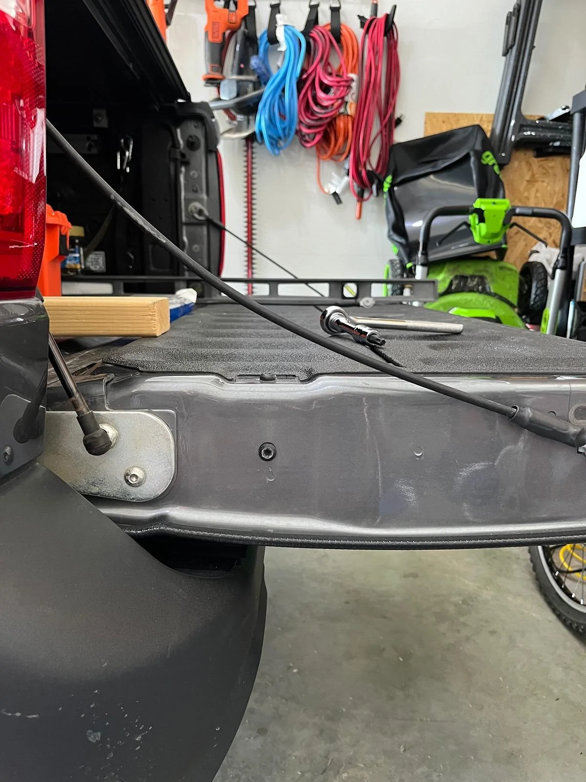

Finally got around to solving this annoyance for myself. Ordered two new cables from FordParts through a local dealer’s website.
Picture #1 - OEM cables from my 2022 hybrid = not level w/big gap
Ford Maverick Tailgate not level with bed. IMG_3998
Picture #2 - Visual comparison of new cable (left) vs original (right)
Ford Maverick Tailgate not level with bed. IMG_3999
Picture #3 - Right side cable replaced; very close to level with a very small gap
Ford Maverick Tailgate not level with bed. IMG_4001

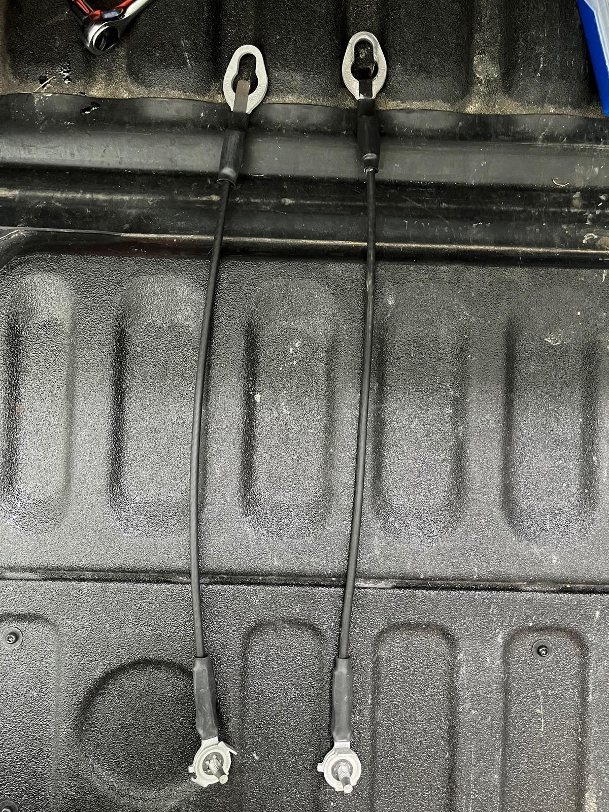

Picture #4 - Notice the slack in the original left cable with the new right cable installed
Ford Maverick Tailgate not level with bed. IMG_4002
Picture #5 - Wheel well test for plywood etc. pretty much level
Ford Maverick Tailgate not level with bed. IMG_4003
Picture #6 - Other comparison of the left hand side cables; new on left and old on right
Ford Maverick Tailgate not level with bed. IMG_4004

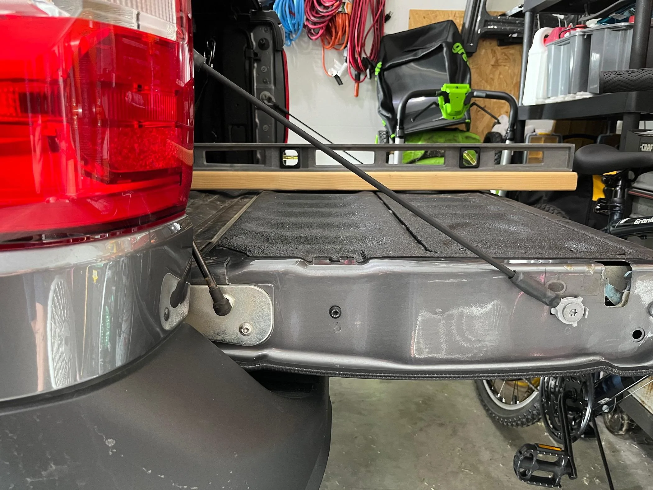

Picture #7 - same wheel well test with the left side cable
Ford Maverick Tailgate not level with bed. IMG_4005
Picture #8 - Final visual for both new cables in the standard position
Ford Maverick Tailgate not level with bed. IMG_4006
I've been in contact with my local dealer salesman and there aren't a lot of 2022 Mavs on the lot but he did say that there's a new Ford Ranger in the showroom with this very problem. So, I'm hopeful that they will replace the cables.
