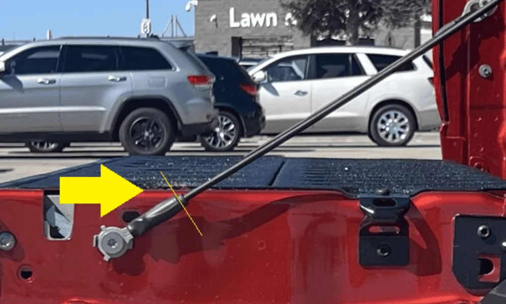

looks to be Drivers 14" and Passengers 14 1/8"
measured from the grommet clip end to the other clip end, so the wire in-between each hook/clip/connector

Ford Maverick Tailgate cable/gate continutes - 1666314913180
measured at that crease, where the actual metal starts under the heatshrink on each end.
Yup as expected, measured from the same spots, mine are each about 14 3/4" or even a hair longer
Best measurement to eliminate any variance in actual end fittings would be to measure the distance from the far sides of the holes in each end as that would be the actual needed length with the tailgate in it's preferred level positions
I’m out of Texas for a week, I’ll check when I’m back. I did those measurements at night too because I was impatient, I can try to be more precise.
I figured the connectors were less likely to be a different size vs the cable from crimp to crimp.

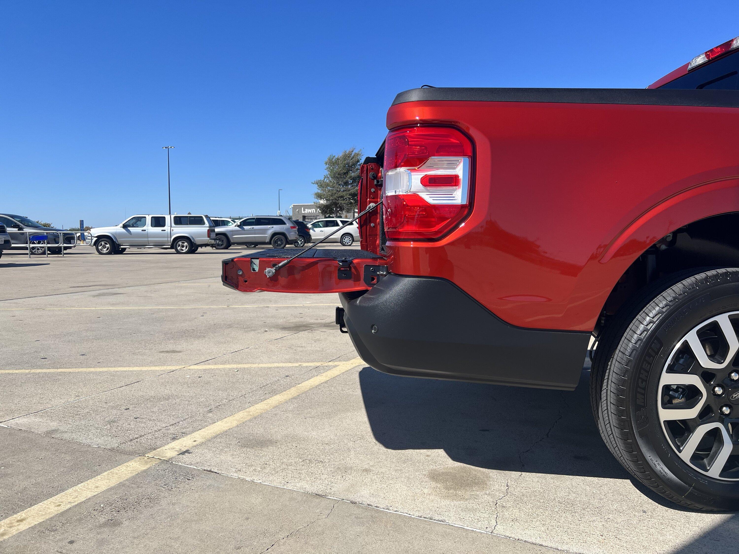

Just picked up my Hybrid yesterday. It seems much more level visually than my XL, I have not used a level or 2x4 to verify.
Now that's the way it's supposed to be, I'm picking up a replacement cable from my dealer on Tuesday and will definitely be showing him this picture! Thanks for the visual
I’d throw a level on it, but I don’t own a long one, always had access to one at work, now I’m remote. Hopefully anyone can get them replaced without hassle.
