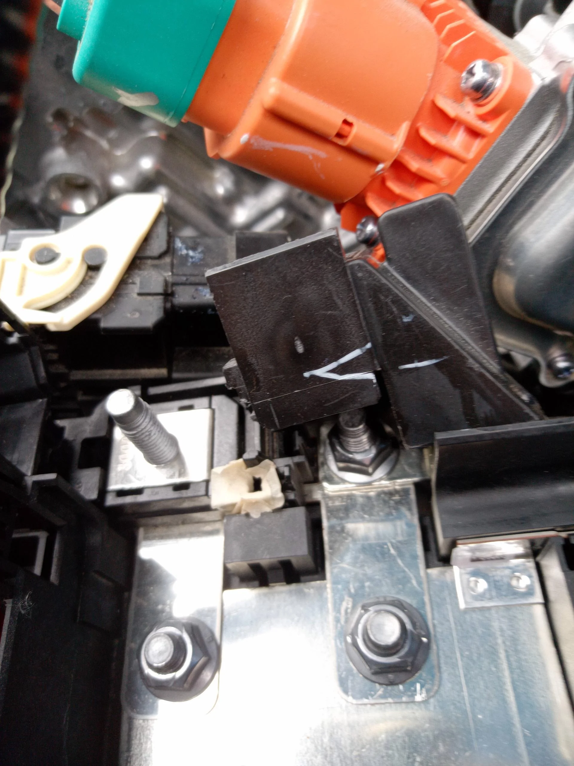

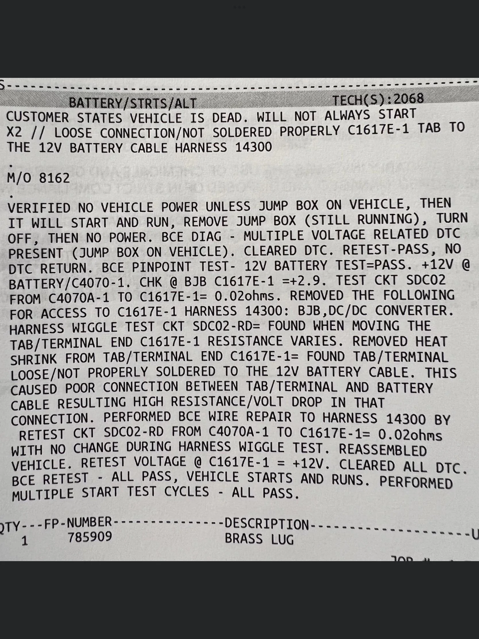

Found this on FB. Recently repaired dead hybrid. I haven’t seen it posted here yet. If this is yours, I hope you don’t mind it being shared.
Why does the term “BRASS LUG” appear at the bottom?

There wasn't room on the top.
It’s not the position of the term that I was questioning.
it’s the fact that it’s brass, not aluminum nor copper.

I just did a write up on mine in the issues threads, i went in and tore apart and checked the rear/back cable.
Skinny great idea, do the same on the rear/back cable and your good.

Good idea! Is that wire aluminum or copper?
Crimping a copper lug on aluminum wire probably isn't a good idea.
Use a lug that is CU/AL rated. They are available.
