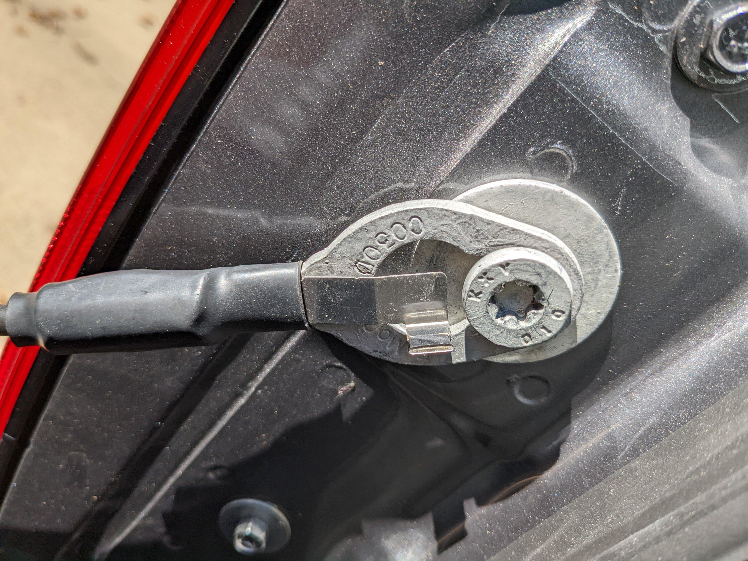

I was out tinkering today with my truck. Both cables from the factory are equal length of course and each is about 3/4" too long I'd estimate (if they were 3/4" shorter, the tailgate would sit level/coplanar with the bed). I assume your new one is about that much shorter than the factory one?
The closest I can find to a part number on the factory cable is "C030D". When I Google that, I just get a few aftermarket cables for old f150s for some reason.
I wonder if this is indeed a new part number, or if there's just a new/corrected batch. I'm very tempted to order a new set, but I'd hate to get the "old batch" if that's a thing...

I believe C030D is the supplier code for the supplier who makes the cable or cable eyelet.

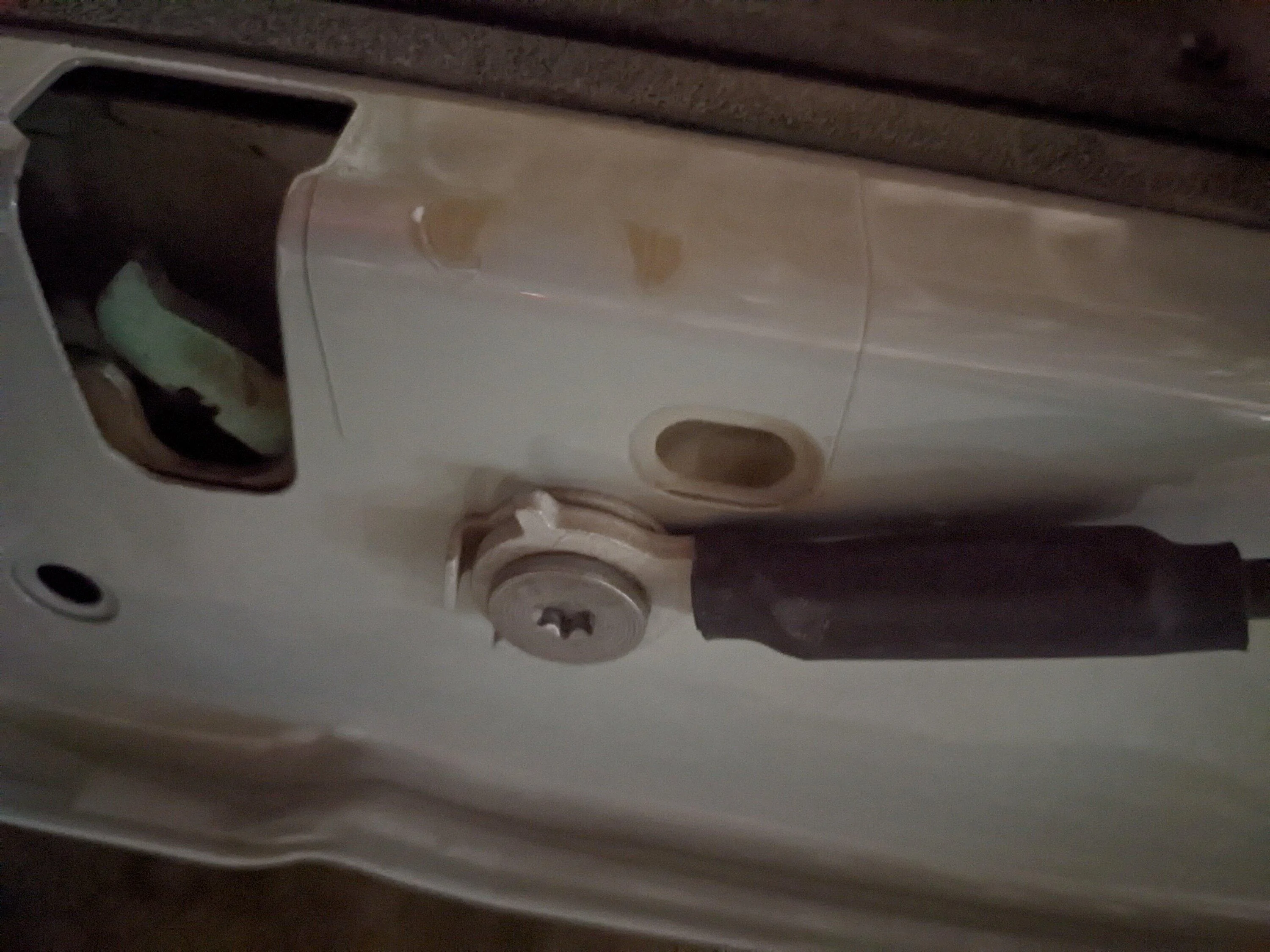

I also noticed an opening with clear tape instead of a plate/etc from the factory next to the passenger side tailgate bottle opener - spare no expense - lol
clearly not there to cover that little hole. PPF. most likely to protect the paint from wear from the cable.
