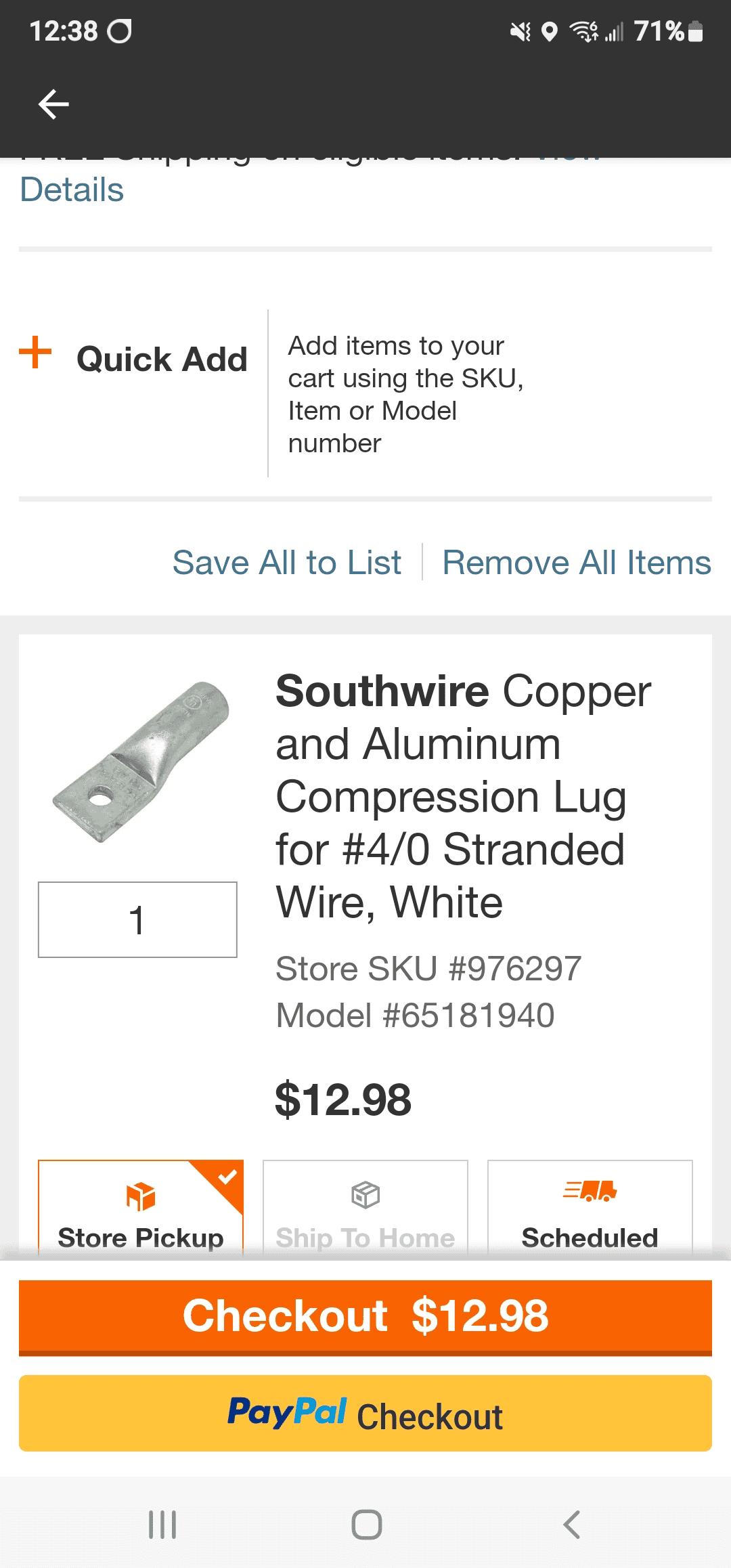

Thinking about this, crimp, heat shrink, call it a day.

There is plenty length on the cable to do this repair.
That is exactly what is needed, it does both AL and CU. Good find!

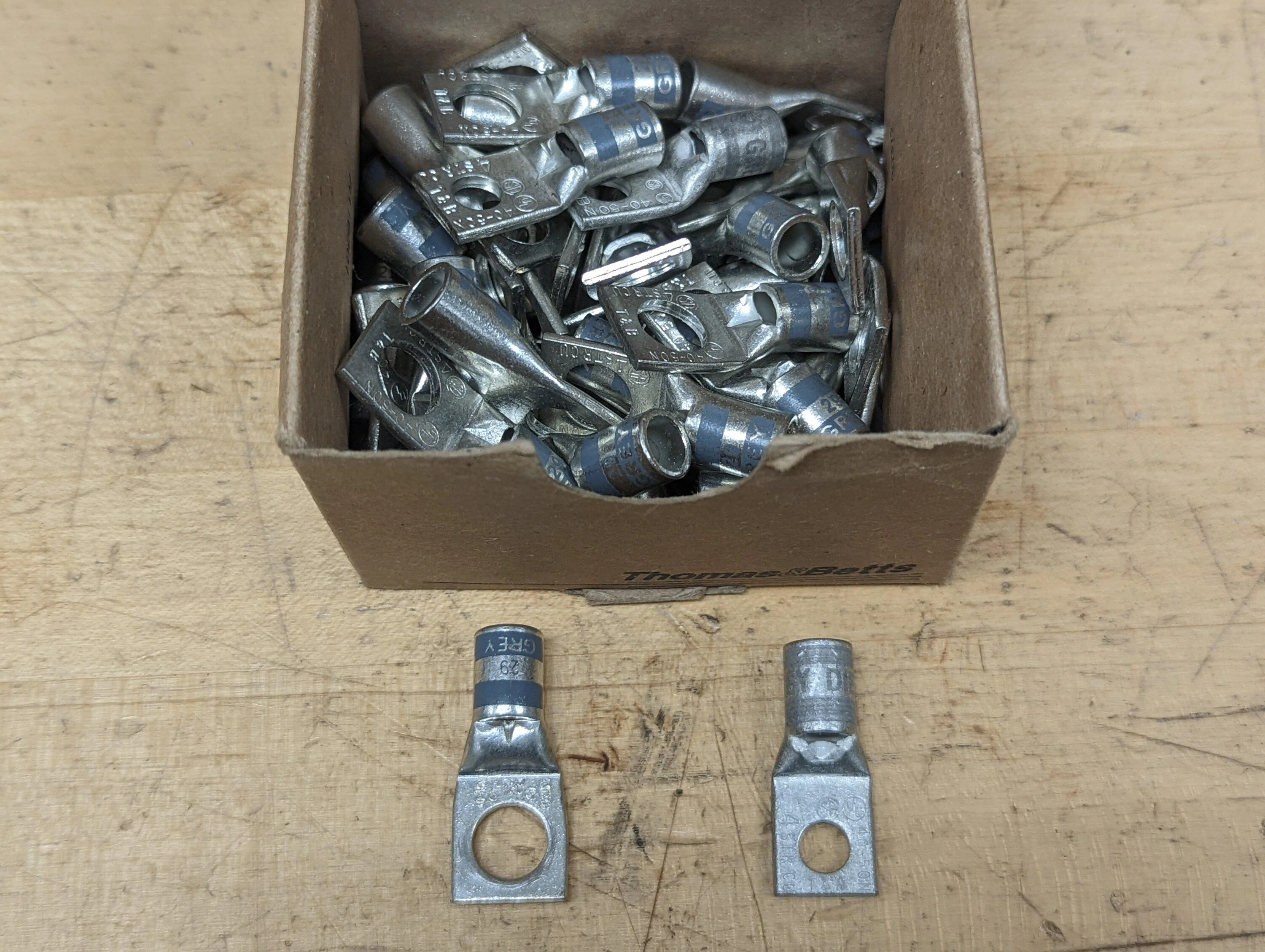

Assuming you did Not buy one of these yet? I'm not sure if the stud hole size is large enough looking at it.
We have these where I work, but they are only Copper Tinned CU, not Aluminum rated. I still have yet to see it posted anywhere if this cable is Copper or Aluminum? I have seen posts where their dealer used a copper lug.
I figured I could drill the hole out to fit.
Yes, I purchased one from Anazon for $7 as opposed to Home depot for $12. The lug has noalox inside barrel.
