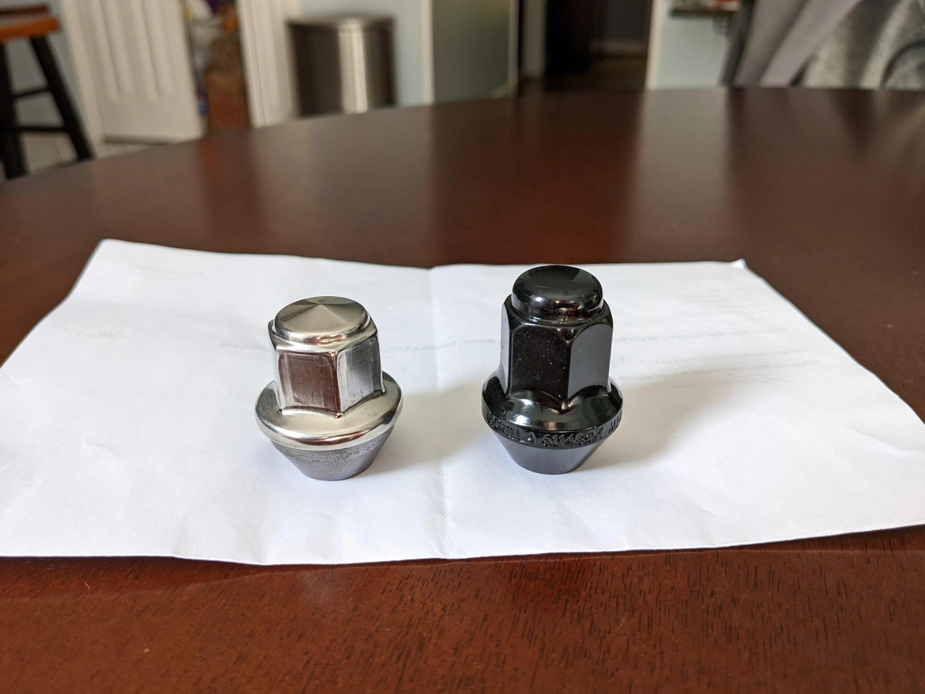

As others have said, the OEM nuts are two piece. A main hunk of steel with a chrome cap. Apparently they're prone to corrosion and swelling. I replaced all mine (and wanted to switch to black anyway).
