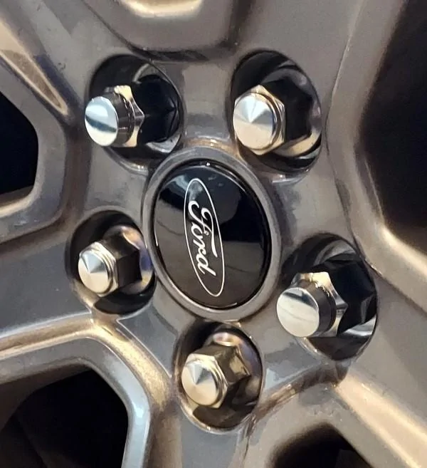

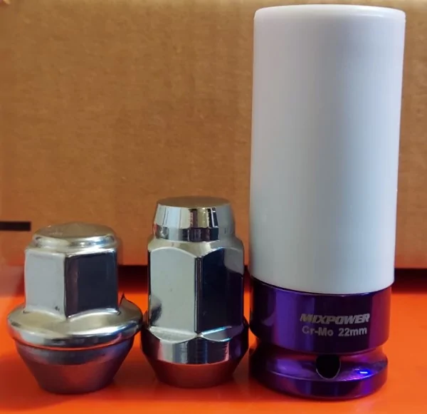

Here are 2 McGard 64073's (3 are OE lug nuts) on a Mav XLT wheel, to compare the look:
Ford Maverick Swelling Lug Nuts lugnuts
Ford Maverick Swelling Lug Nuts lugs2

Note: You need a 22mm (or 7/8") socket or lug wrench if you go with McGard 64073, bigger than the OE 21 mm (or 13/16").

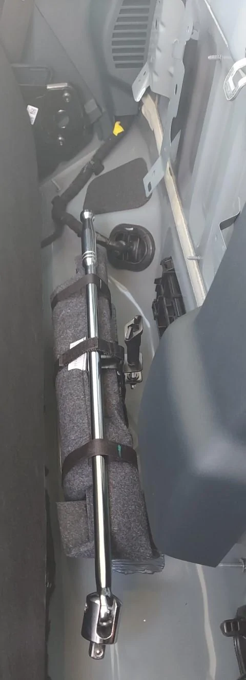

You can strap a breaker bar (nice to have; the leverage makes things easy) to Ford's kit already behind the back seat:
Ford Maverick Swelling Lug Nuts Breaker_bar

The stock lug nut wrench that comes with the jack for the vehicle will not fit the McGard lug nuts. The McGards will need a smaller lug nut wrench.
Need larger. You need a 22mm (or 7/8") socket or lug wrench if you go with McGard 64073, bigger than the OE 21 mm (or 13/16").
