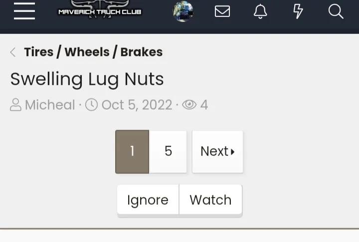

@BillB
Hmm..
What about the stock Maverick lug nuts?
I haven't seen anyone on the forum mention a problem with them yet, and the "similar search list" doesn't show that either. I know on the XL with steel wheels, alloy wheels will require lug nuts designed for them.
That may be a different case for the other trims if they have alloy wheels or some other factor is involved, but with a new vehicle under warranty, keep the lug nuts you have, as the warranty won't replace parts you add on if there is a problem...

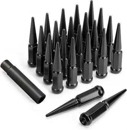

I replaced mine with these one piece lug nuts within weeks of buying my Maverick XLT. Amazon will tell you they don't fit, but I assure you they do. I've used this brand on 3 vehicles with no issues.
https://a.co/d/0dn4HgWR
