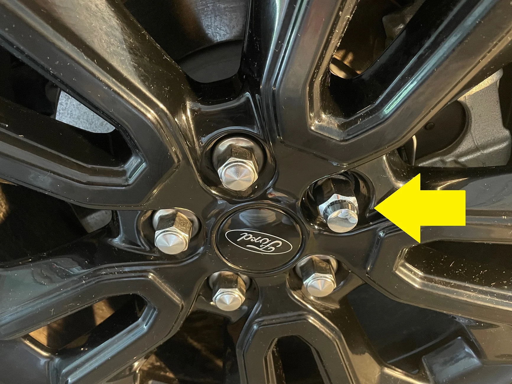

I learn something every day...
I wonder if there is a difference between the XL and other trims due to the steel wheels.
The XL also has covers over the lug nuts, so that might make a difference...
XL = just one piece of metal
Ford Maverick LUG nuts 1787416790622-gg
XLT + Lariat = a thin sheet of chrome plated covering the solid metal, making a 2 pieces lug nut
Ford Maverick LUG nuts 1787416989492-k6
The problem is that moisture or something got in between the lug nut and the chrome cover plate for the XLT + Lariat, leading to the metal rusting and swelling, which your standard 21mm socket can't fit on.
