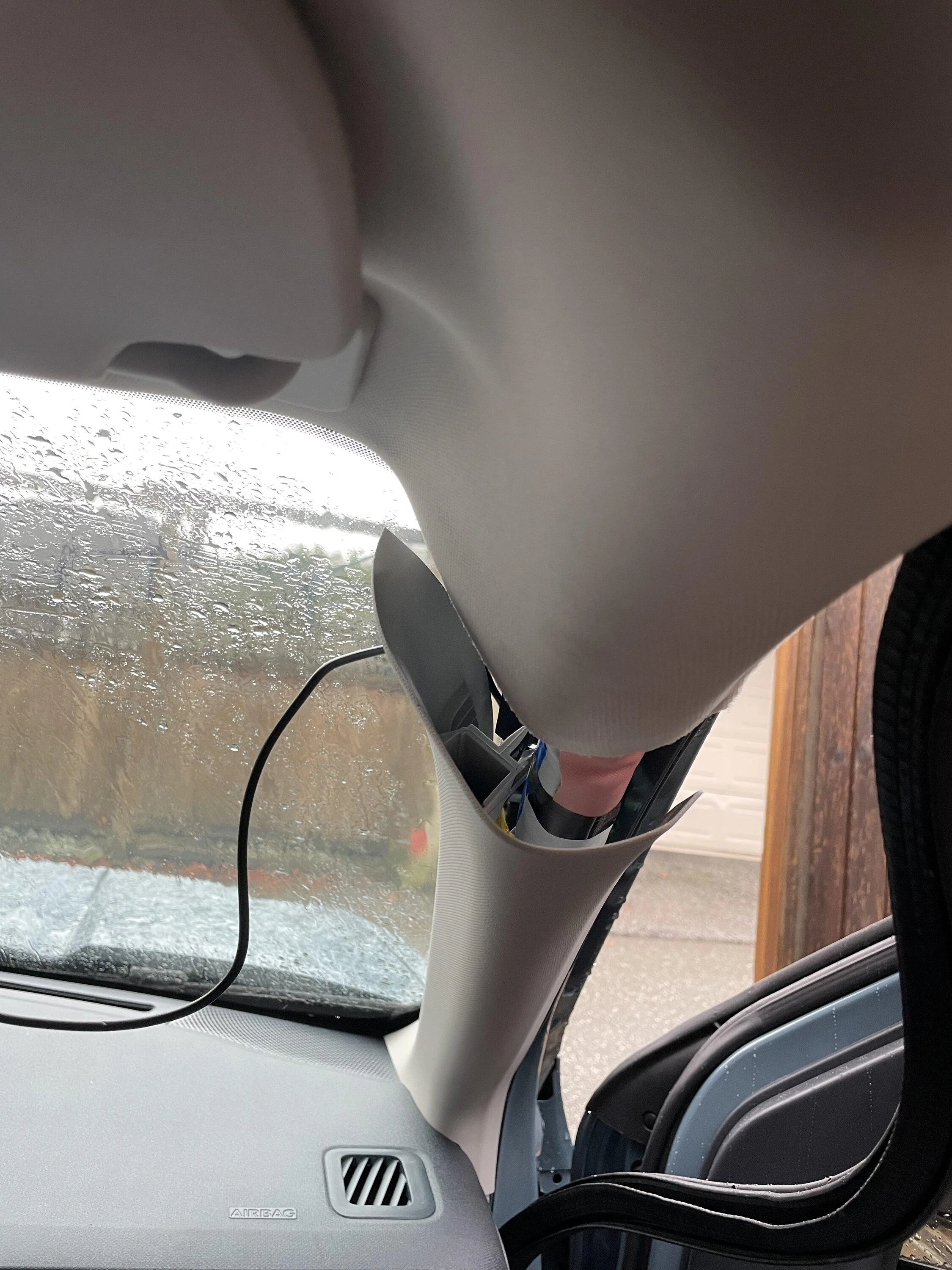

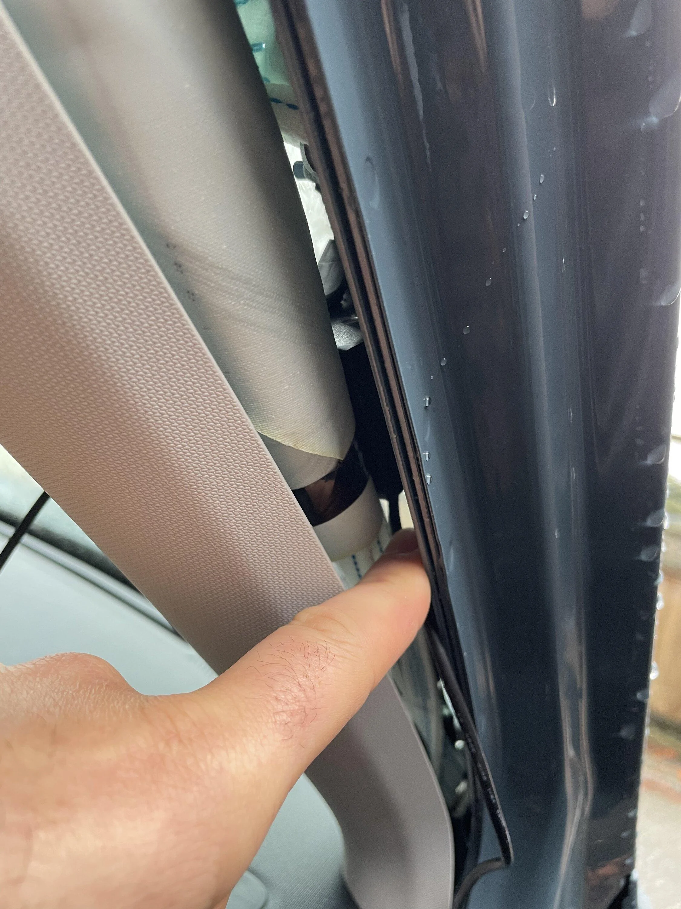

After reading this and others I went back to check how I routed past the side airbag. My first post crossed over it so I went back and pulled down the A pillar cover and rerouted it to the inside, next to the windshield and behind the airbag.

I just installed a single forward facing dash cam today and figured I’d share a few notes while it’s fresh in my mind.
  • I tapped into fuse 3. The top pin was 12V live (when the ignition is on).
  • I grounded to the M6 stud just below the fuse. The nut has an integrated washer that makes it hard to put a grounding lug behind it, so I just added an extra M6 nut on top of it to clamp my ground.
  • Wiring ran up the passenger A pillar and was dead easy after dropping the glove box and removing the door seal. None of it is exposed anywhere.
  • The rubber door seal just pulls straight out with a bit of pulling and there’s no need to monkey with any plastic panels.
  • There is a hole behind the glove box in the top right that exits straight into the A pillar and from there it’s easy to pull up the wire.
  • The only place I needed to flex anything was to pull down the A pillar cover a little bit where it meets the headliner and then a bit of work to get my fingertips behind the headliner.
  • The headliner fabric looks pretty fragile around the edges so be delicate up there.
  • Make sure to run the wire behind the airbag, not over top of it.
  • I put my dash cam to the right of the mirror and ran the wire straight into the headliner.

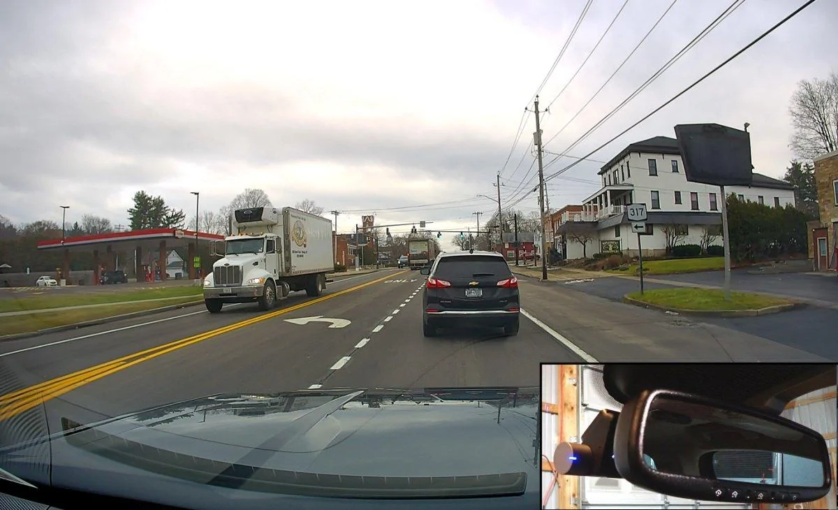

Installed mine this week. Was pretty easy running the 12 volt wire across the headliner and down through the A pillar to the fuse panel behind the glove box. Also ran a wire for the rear camera up the pillar for the rear dash cam. Very happy with the quality. Also got the sensor to turn it on if there's any vibration when parked.
