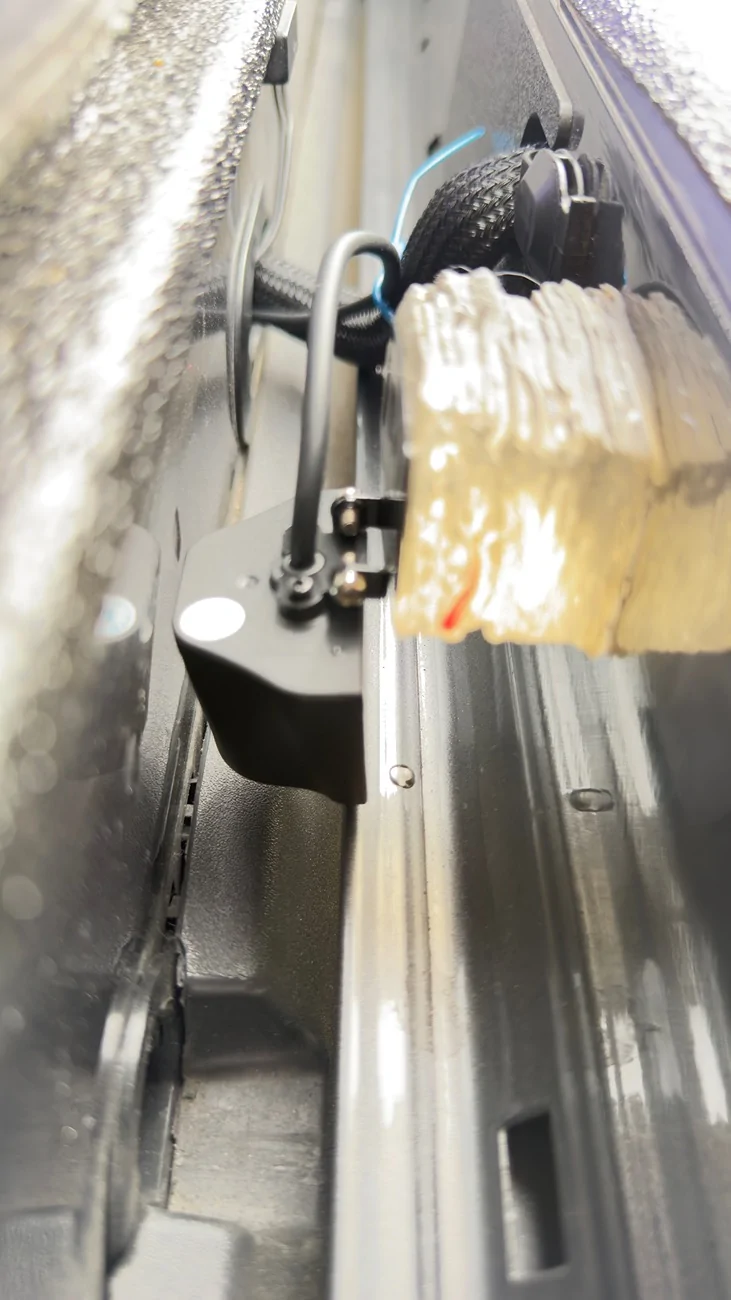

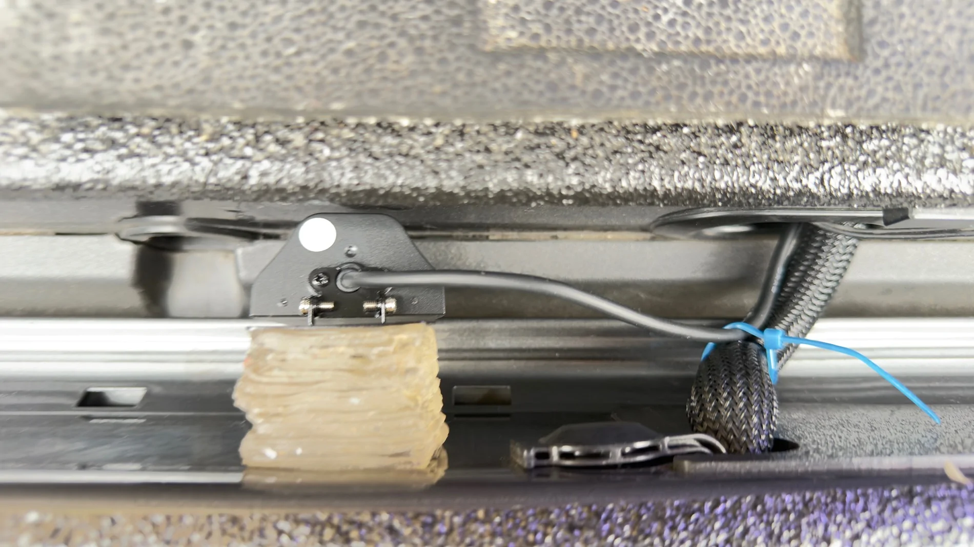

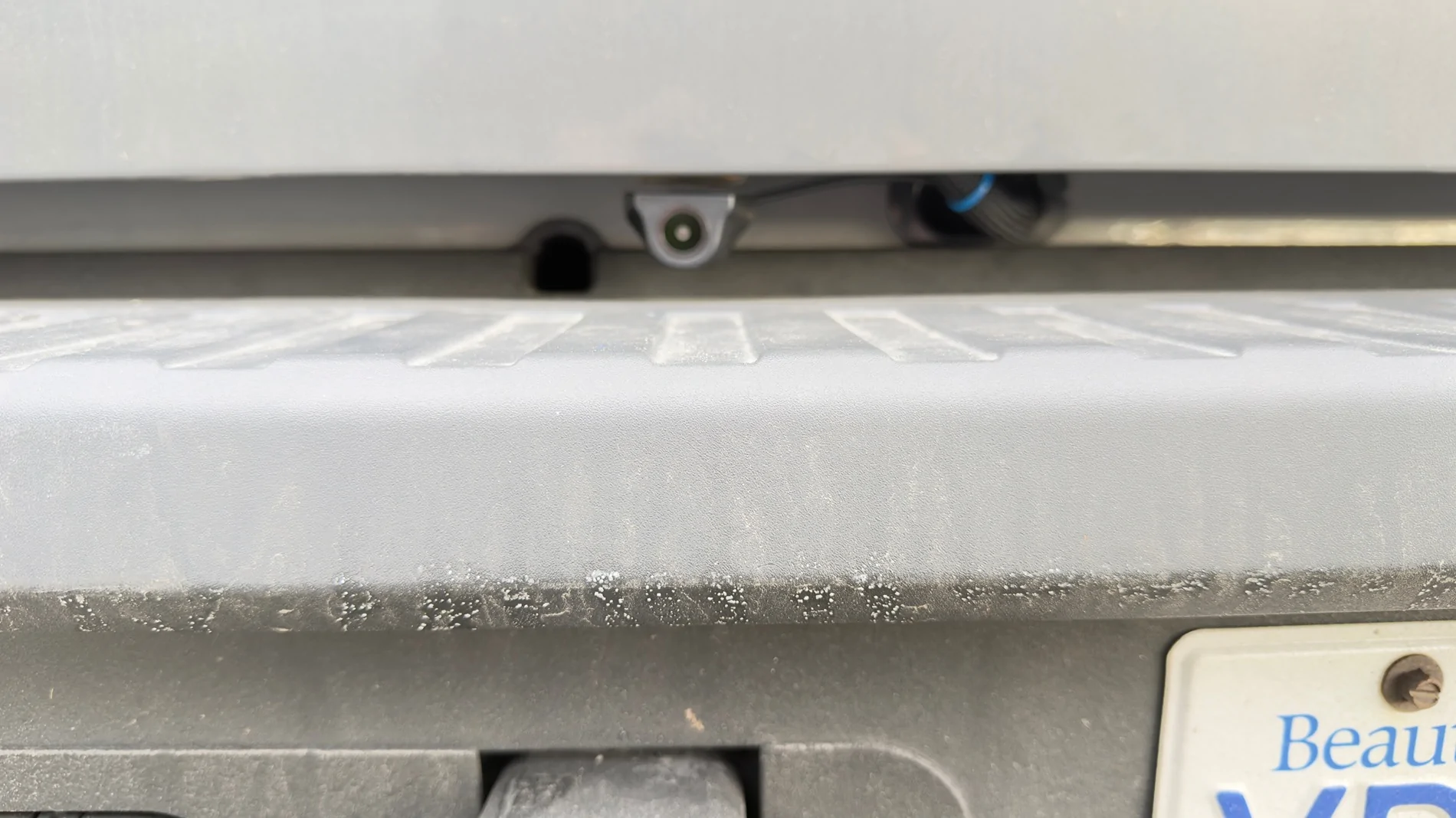

I’ve recently give a new location below the tailgate a shot.
I have temporarily mounted it at the correct height and depth so that it is protected from damage, constant rain and has clearance for when the tailgate is dropped. I’m hoping this position also reduce drops blocking the camera.
I have to reach out to some friends who 3D print as I have no idea how how to cast the contour the space to make a solid mount.
If anyone who 3D prints could tell me how to achieve this please DM as I would appreciate any help.

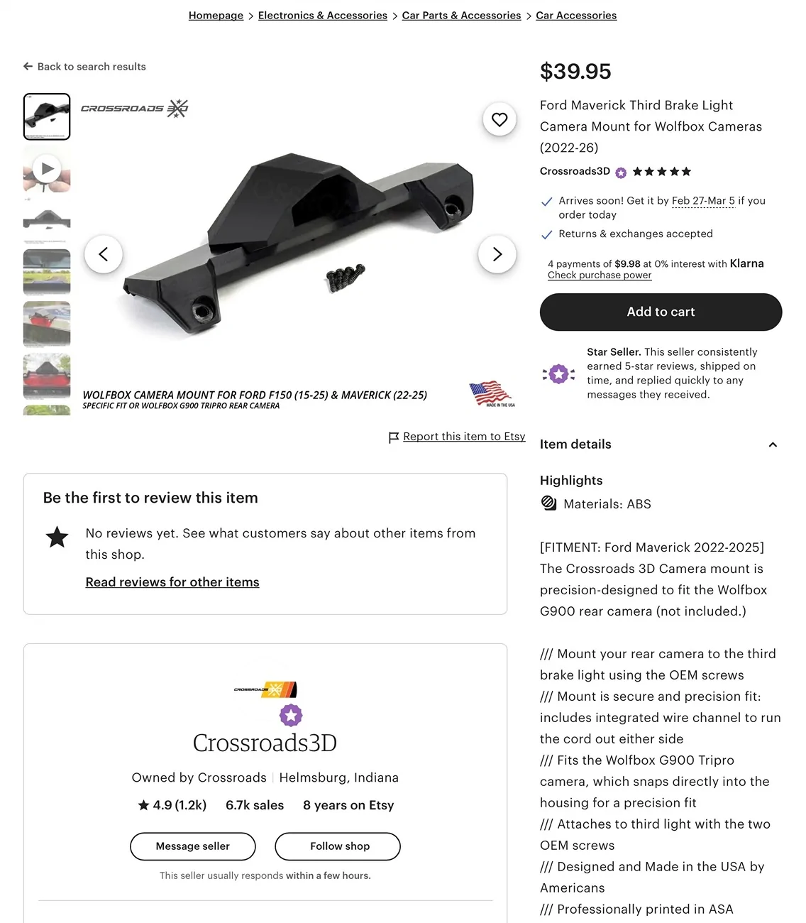

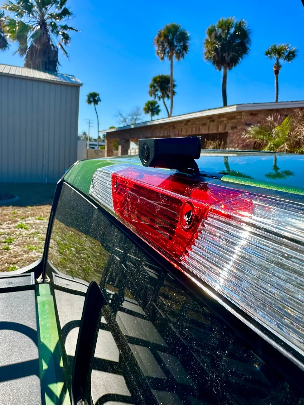

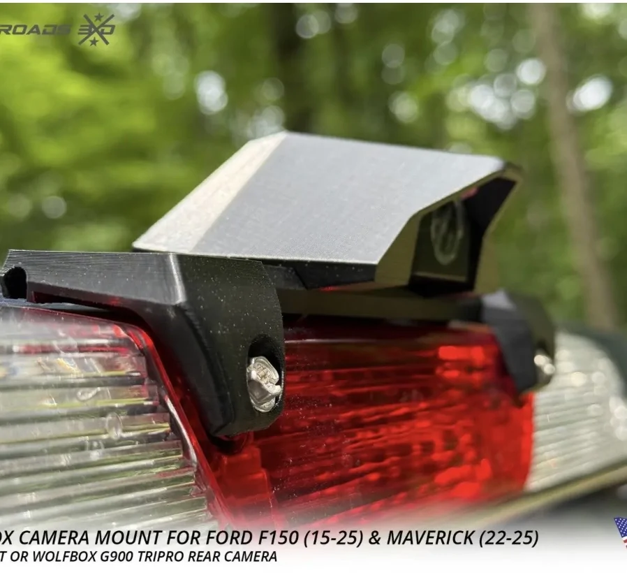

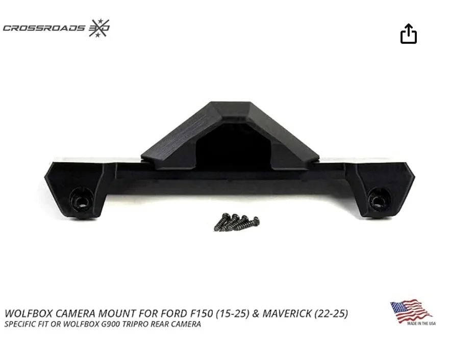

Hey Ryan thank you for the compliment on my write up - I did move my rear facing camera outside above my 3rd brake light , I love the view however it’s not very well protected so I found this mount for the camera that mounts on to the 3rd brake light and also provides better protection it wasn’t cheap but I feel it adds a additional layer of protection I ordered it off Amazon but you can buy directly from the “Crossroads3D“ website it’s about 10 days out so I am really looking forward to remounting it when it arrives - I have attached a few photos showing how I mounted it temporarily

Yes. I think that will make the brake light position cleaner and protected.
I may give them a shout to see if they can point me in the right now for the tailgate position.
Seeing the grill of the vehicle behind me removes the uneasiness of wondering if the car behind is going to stop soon enough.

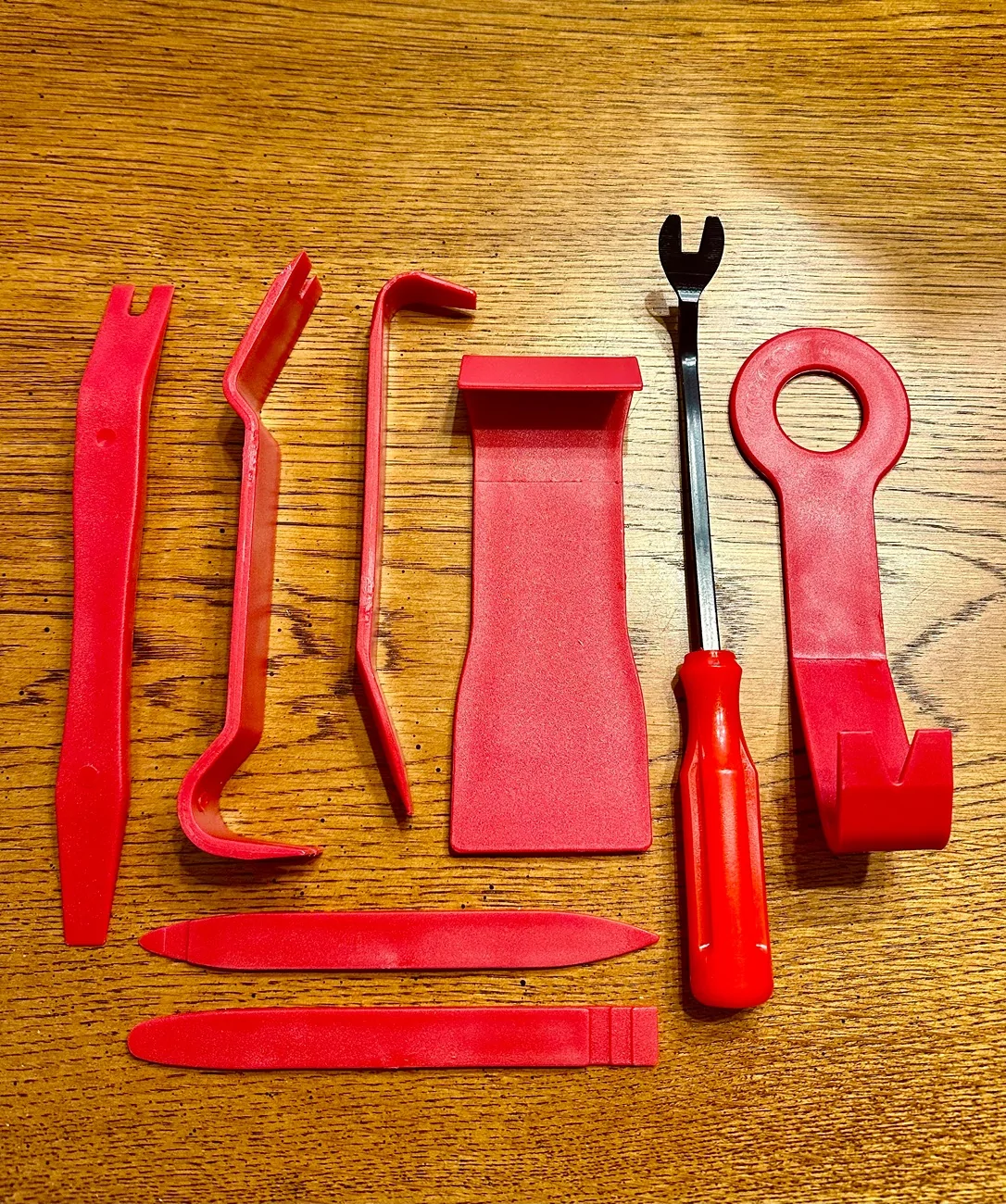

Do you mind elaborating on how you removed the trim? What tools did you use?
Same for the headliner, does the whole thing "come down" or were you just pulling it back a little? Again, what tools did you use?

I didn’t remove the entire head liner there is enough room to pry it open just enough to tuck the wires in.
the photo is a trim tool kit I picked up on Amazon it worked great and made this job easy there are lots of different kits to choose from - hope this helps

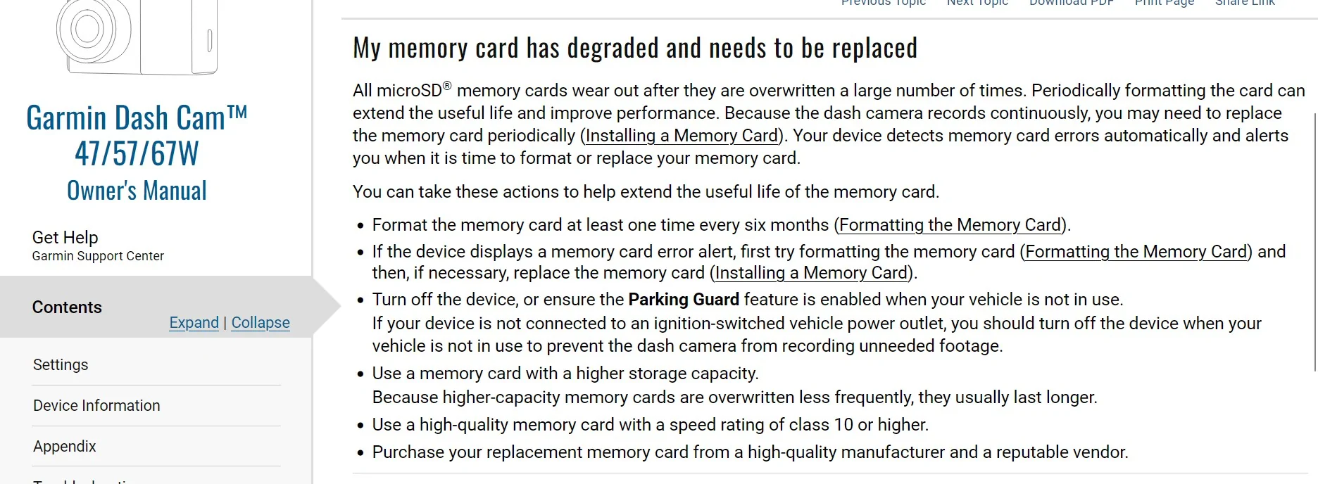

I have had a dash cam for 3 years.
FYI..... after about three years the dash cam was only recording the first couple of minutes on every trip. I did not notice until I tried to download a major accident that happened in front of my car. It did not record it. I thought my cam was bad. Apparently the SD cards degrade /"wear out" in dash cams. I put in a brand new SD card and works great.
I was ignorant and thought SD cards last forever.
SD CARDS WEAROUT or DEGRADE.
Especially on dash cams.
Don't make the mistake I made.

I wasn’t aware SD Cards “wear out” I do know they frequently need to be formatted (the WolfBox G900 TriPro has a reminder that alerts you to do so)…

I learned this recently too,,,,,
