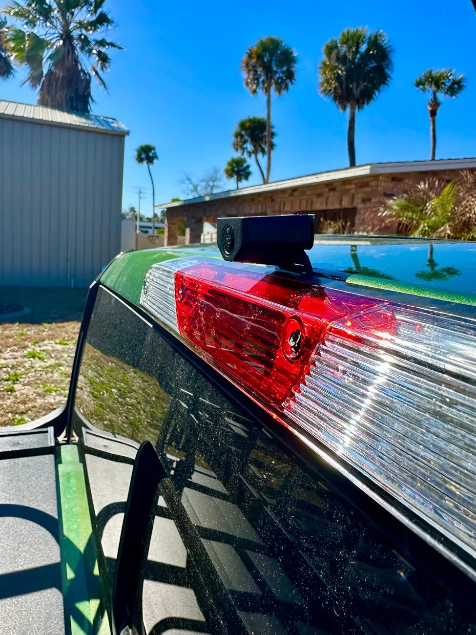

Okay I see some used this exit point from the cabin to run the wire through the 3rd brake light enclosure then stuck the camera outside just below the fixture or on the roof and the cord exited the 3rd brake light enclosure and was outside the enclosure the thin cord still allows the light to be put back in place and maintained a good seal with the camera mounted outside the brake light - is it possible you snap a picture of yours finished?

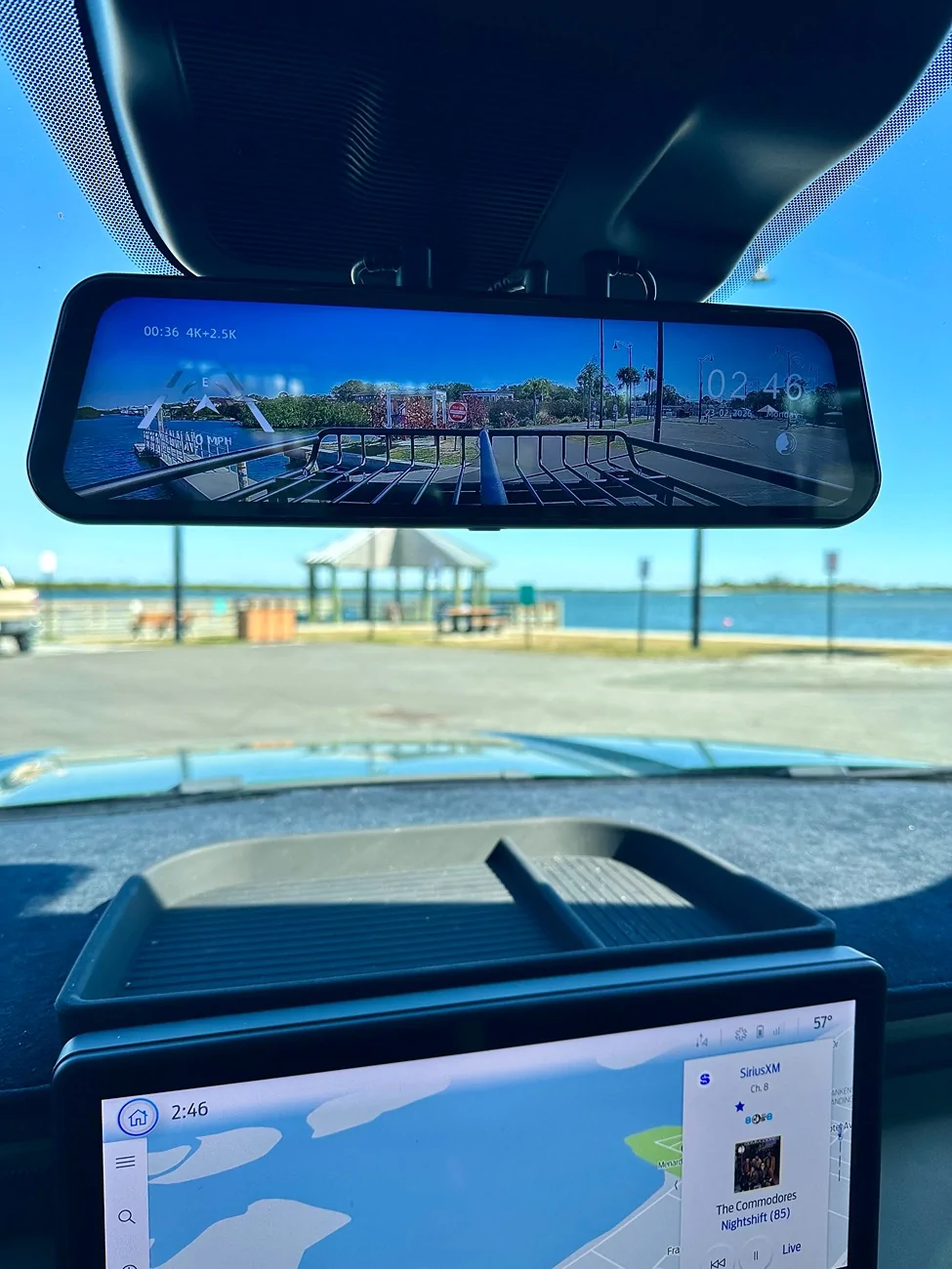

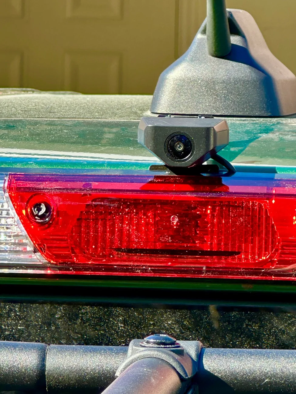

Okay I relocated the rear camera from the interior cabin to the outside above the 3rd brake light - this gives me an unobstructed view above my cargo basket instead of the tunnel vision view I had with the camera mounted inside. I want to thank everyone who provided suggestions and recommendations I’m very happy with the results.
Ford Maverick WolfBox G900 TriPro Dash Cam Installation Completed IMG_7654
Ford Maverick WolfBox G900 TriPro Dash Cam Installation Completed IMG_7642
Ford Maverick WolfBox G900 TriPro Dash Cam Installation Completed IMG_7641

Is that waterproof enough to have 60+ mph water blasted at it?
Well I certainly hope so, the camera is approved to be mounted outside so we’ll have to see how it works out. The interior option didn’t work out since I have a cargo basket mounted on crossbars over the bed…
