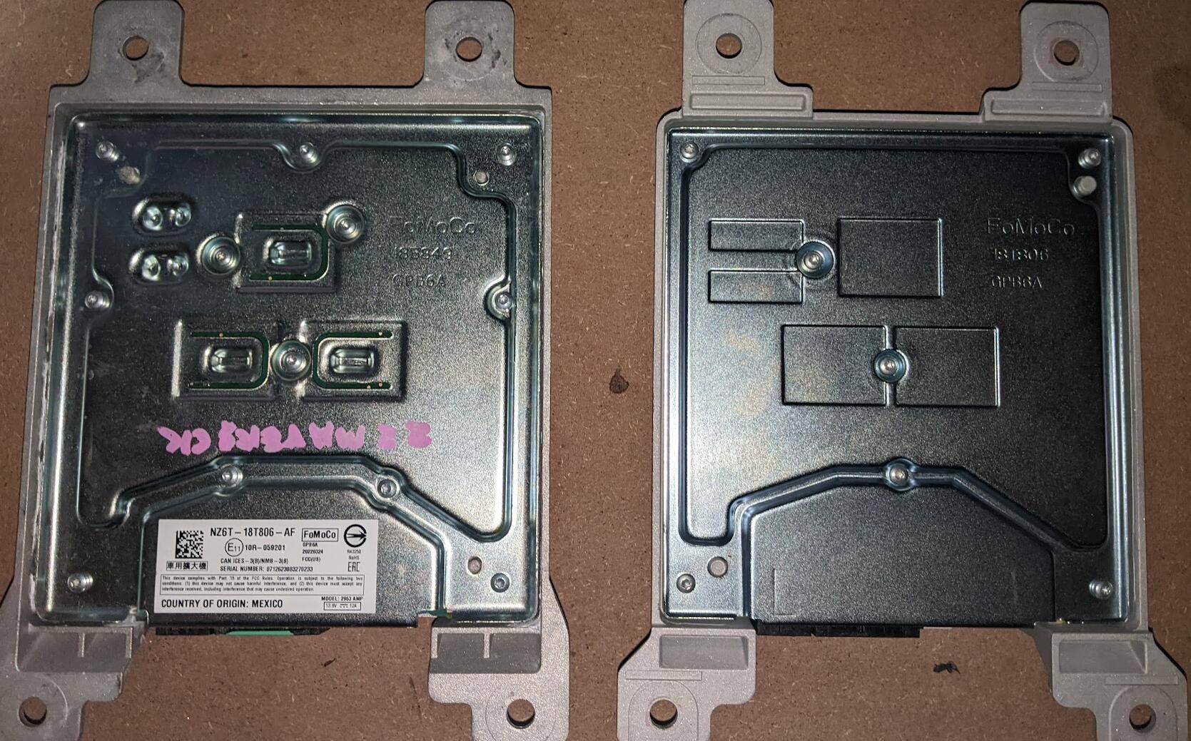

My kicker HS-10 died and I'm waiting on an RMA replacement, so I had the opportunity to listen to just the setup with the Dayton replacement with the mid-2023+ B&O amp for a little while. I think the bass is reasonable for a 6" sub. On some hip hop or electronic tracks it's got a decent amount of low end.
Also interesting development, I found a 2022 B&O amp finally on ebay and I see there are possibly some others available. Looks like NZ6T-18T806-AF is the part number. I previously was searching for NZ6Z-18B849-A

Ford Maverick Simple B&O upgrade and sub solution. 1734672892337-4h
Ford Maverick Simple B&O upgrade and sub solution. 1734672922761-eh
I installed the 2022 B&O amp and so far not hearing a noticeable difference.. Maybe I would need to do some science and take audio measurements, but not a big priority tbh.. Just going to leave the older version in since I was chasing it for so long.
The dayton replacement I would probably do again. Gives a reasonable low end compared with just a touch of physical vibration to balance out the rest of my system when I turn my kicker all the way down.
