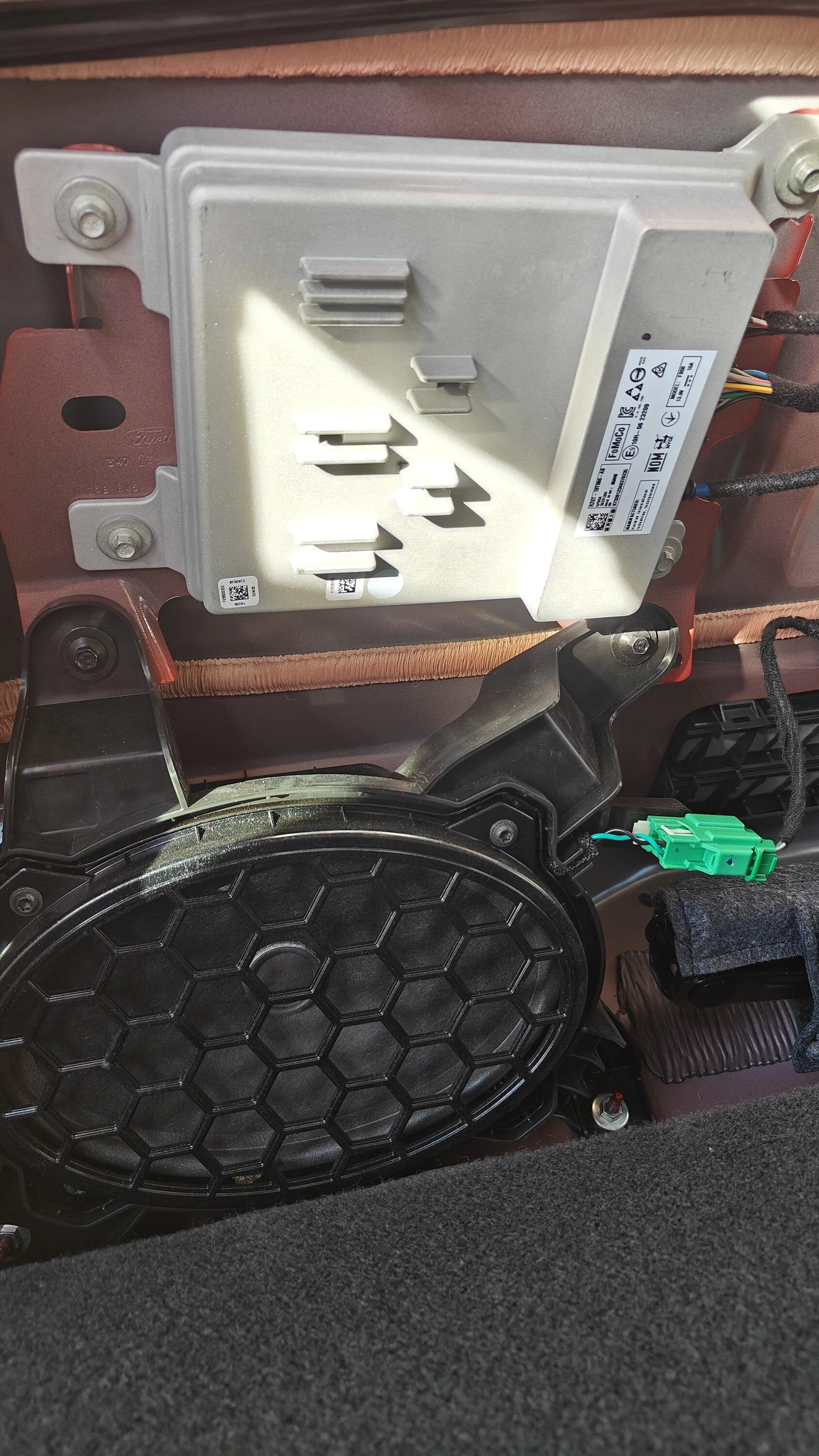

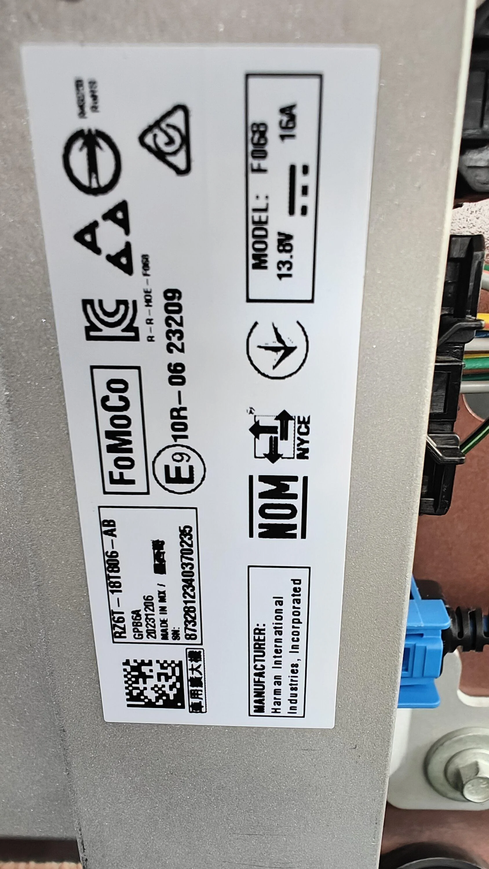

OP. Thanks for putting this together. I have a MY2024 Lariat, so B&O equipped. It does not sound good. I'm going to take a photo of my subwoofer and amp and share it on this thread to show the differences.
Here is what the subwoofer and Amp look like on my truck:
Ford Maverick Simple B&O upgrade and sub solution. IMG20240123142119
amplifier label

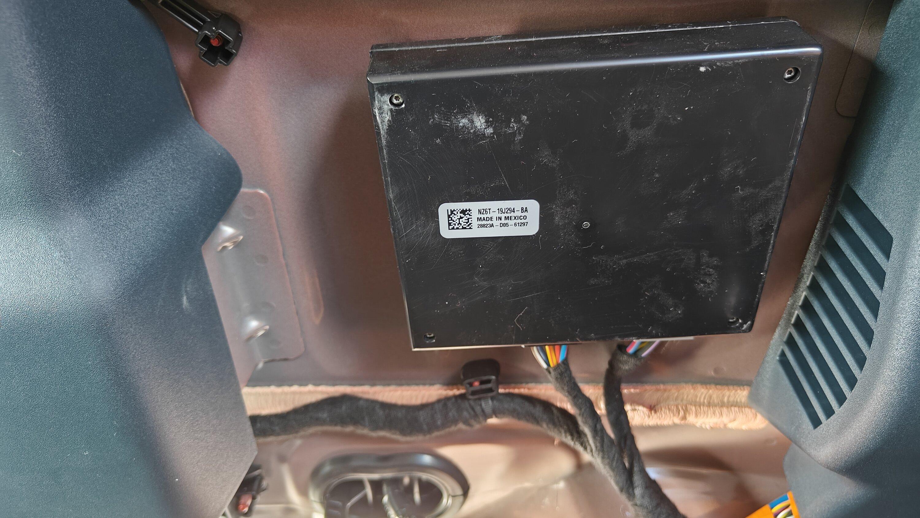

Another poster referred to a black plastic box... That is here... It's not the amplifier.
Ford Maverick Simple B&O upgrade and sub solution. IMG20240123142323

Hints that there's less power in the new amp:
  • @22Lariat indicated his EQ is basically the inverse of mine because the bass was too strong
  • he needed to add dampening to lessen vibrations which I face no problems with
  • The calculation based on the sticker on the "new" amp: P = I x V => P = 16 x 13.8 = 220.8 < 660
