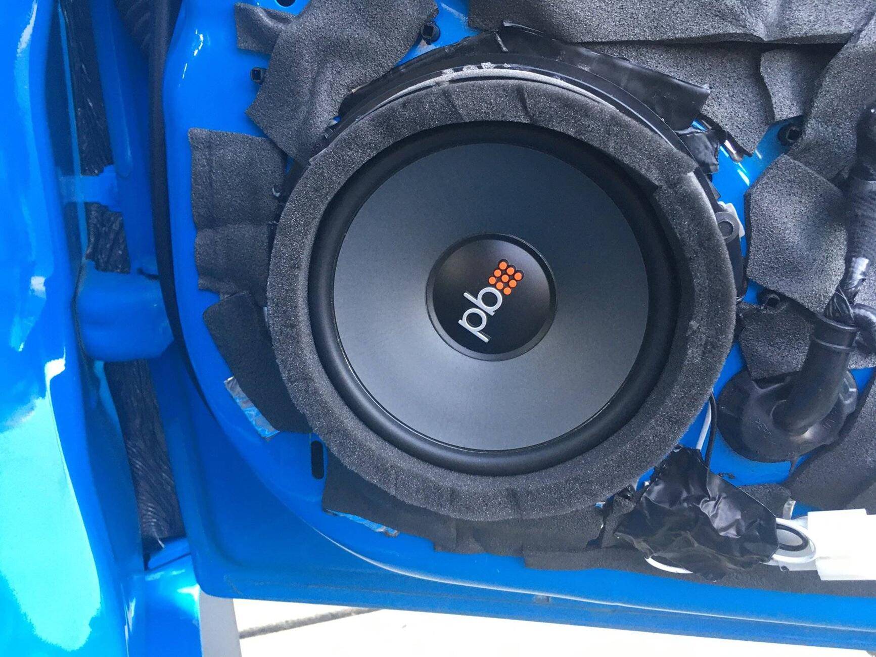

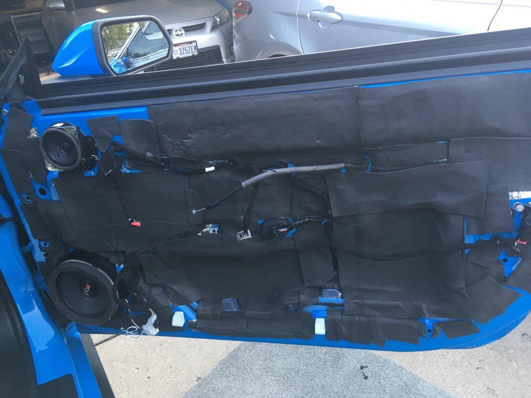

glad to hear its that simple. I cant wait for mine! I cannot say, but I did put powerbass speakers in my mustang, and I thought they was exceptional vs the stock premium ones.
the door deadening like shit. but they was great

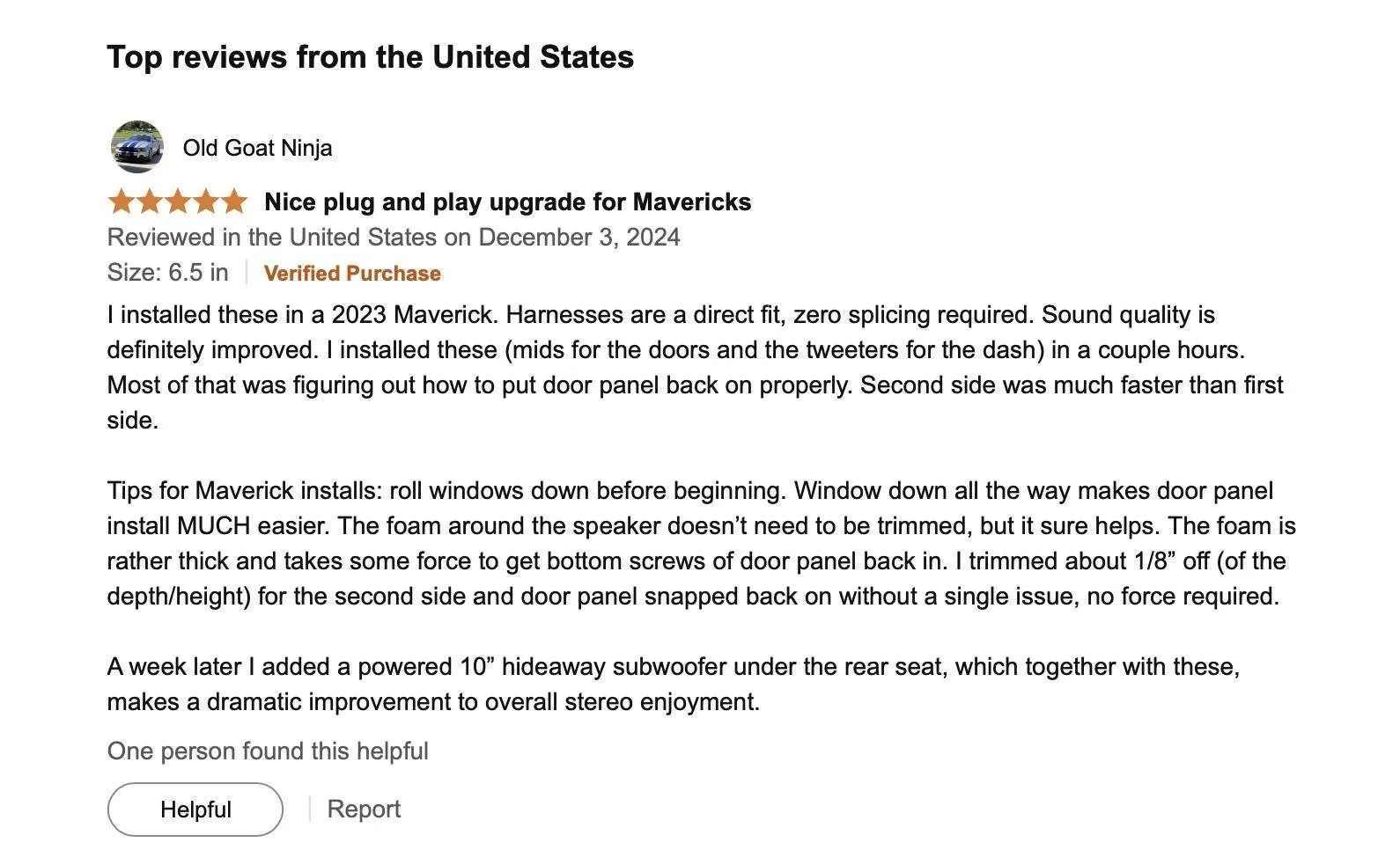

I think these are what I got, and the first review on page is this
https://www.amazon.com/Powerbass-OE65C-FD-Component-Lincoln-Replacement/dp/B07DWF6NBY?th=1

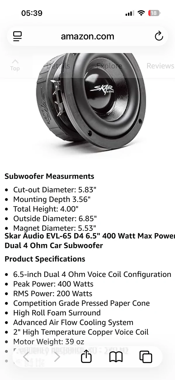

Based on your knowledge of the B&O Enclosure do you feel this Scar 6.5 sub would fit in a similar fashion as you used in your application? The measurements are close to the Daytona Audio 6.5 however the Scar is just a bit larger.
do not attempt to put anything in the factory B&O sub enclosure. it's infinite baffle, meaning the rear of the speaker vents under the truck to open air which kills SPL. and it's tiny so you can't seal it.
That is generally poor advice. There is absolutely nothing wrong with Ford's infinite baffle design in the Maverick where the rear of the speaker is completely sealed into a separate space from the cabin.
I have the factory B&O 6"x9" subwoofer being driven by an aftermarket amp and it is super responsive and generates tons of bass.

Thank you for the response. I was interested to know if the Scar 6.5 Woofer would fit in the factory enclosure’s physical space like the Dayton Audio Woofer mentioned by the OP.
As Bluelobo26 mentioned I feel the factory 6x9 woofer does sound pretty good. I would just like to expand on it a little bit without a large investment in time and money. The Scar looks like it may have a slightly larger footprint than the Dayton Audio speaker and I do know the available packaging in the OEM enclosure is limited.
Even if it will fit, it would be a terrible candidate on efficiency alone. The factory amp is pretty weak, and that 82.8db efficiency isn't going to help. It is far less efficient than the Dayton(87.4db) the OP used. It would likely be weaker than factory. If you are determined to mount a sub there, make sure the specs are good for an infinite baffle setup(total Q higher than .5) and that it is efficient. You don't need power handling, you need efficiency. There aren't a lot of small subs that really fit those criteria.
Thanks for the reply and the recommendation. I appreciate the detailed explanation and do understand why the OP’s choice is a better option.
OPs choice is not a better option. I went out and found the highest efficiency (103db) aftermarket 6x9" I could and it wasn't a meaningful improvement over the stock sub. What Ford put in there is actually extremely well suited to its purpose. You are better off adding a second compact sub to handle the lowest frequencies and leave the B&O sub active to blend into the stock speakers.
