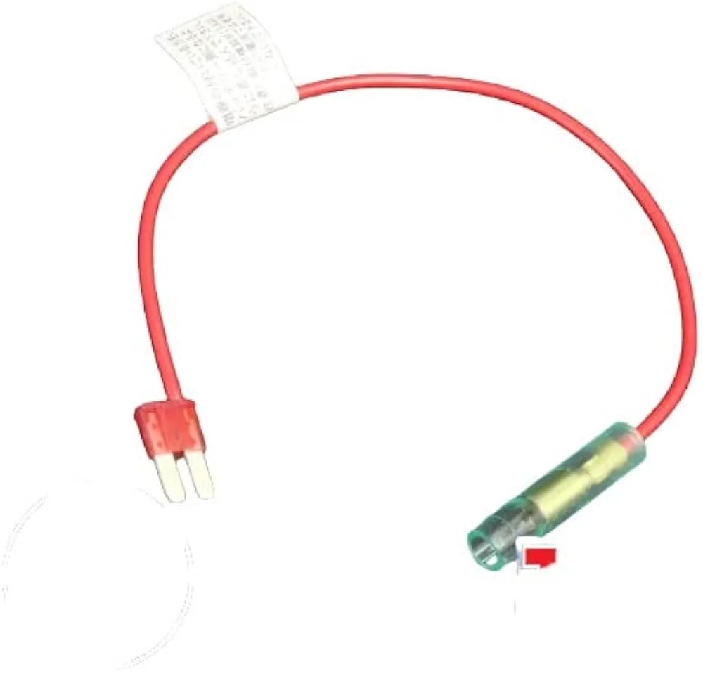

Just run to fuse 6 remote turn on, use a tap. 3/6 are good fuses, when unlocked etc radio sends signal and wakes up sub. I read this in like 20 threads.

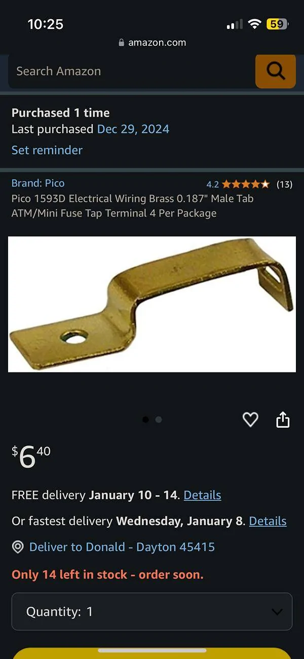

I ordered this to use on fuse 6 personally. It should work, and if it don’t; I’m just going to solder a wire to top of a fuse lol. That’s what it looks like some fuse taps do. Doesn’t look hard to do

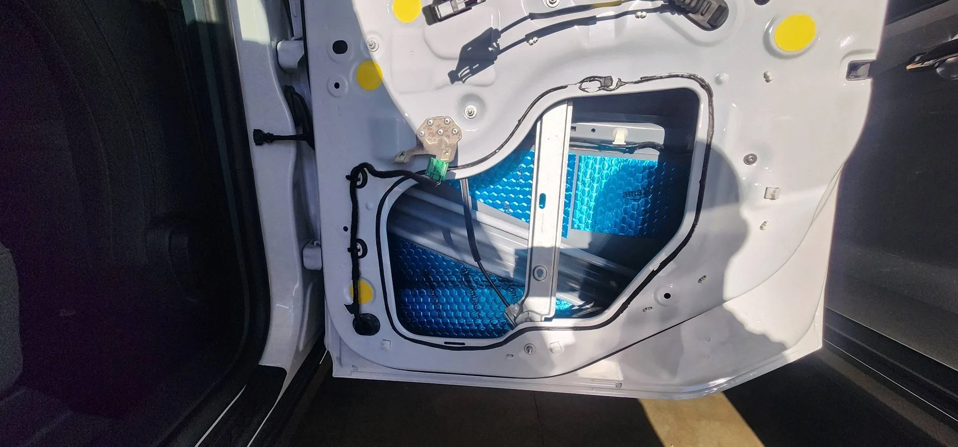

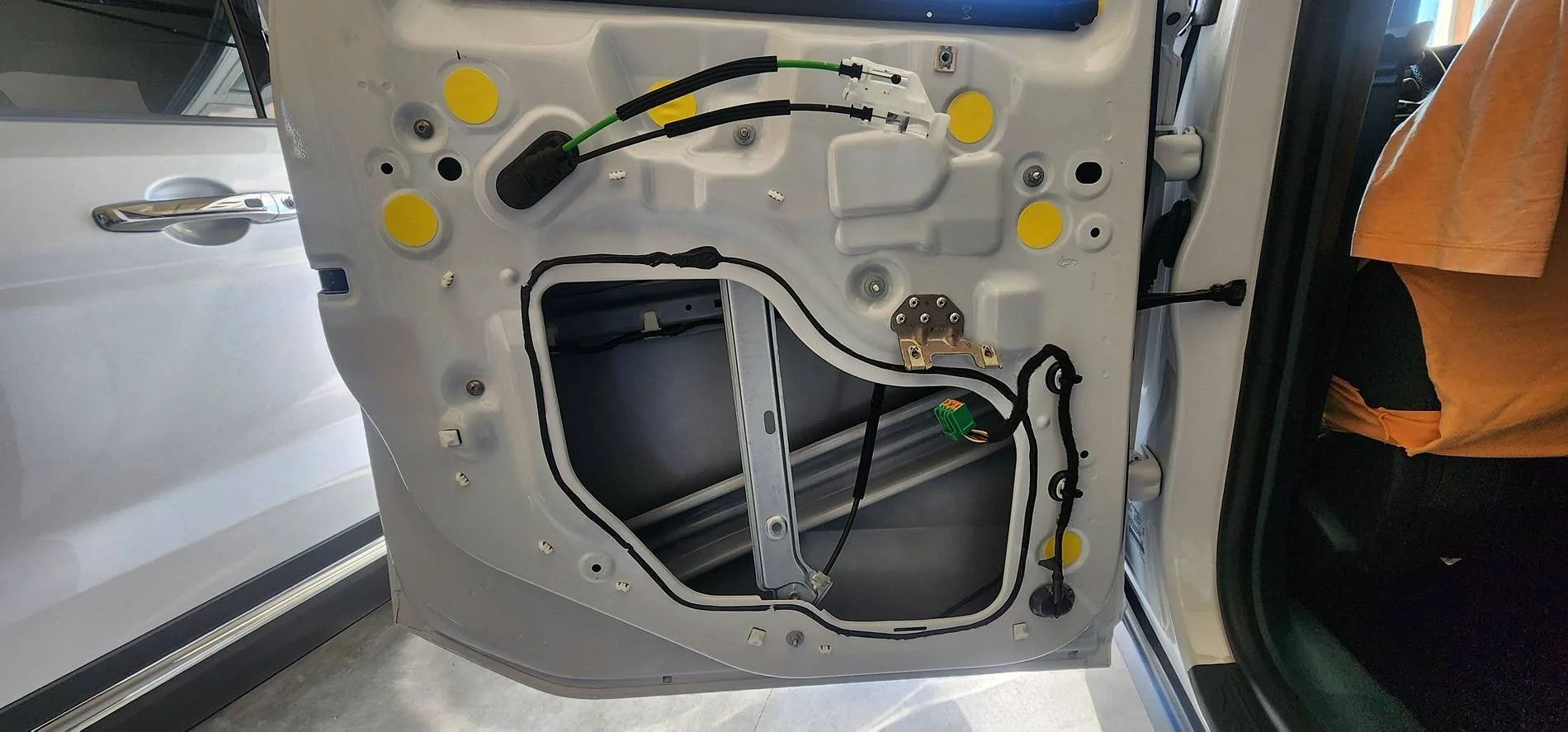

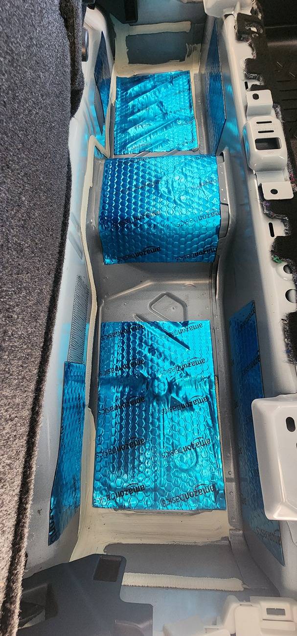

Can't comment on hybrid but definitely worth adding sound deadening material in the doors on them and other areas of the interior. I did inside all the doors as well as footwells and under rear seat storage area used 2 boxes with 10 sheets in each.

Was there no vapor barrier on the door skins? That’s interesting if not
What brand is blue? I’ve only used dyamat extreme and stinger roadkill. Both worked well, but I pay the premium for the dynamat extreme now. Works well
but deafening in the all the same

Yes it's just standard cheap clear plastic sheeting, you can see the butyl where I removed it to install the Amazon basics sound deadening sheets. It did a great job at reducing road noise and the hollow sound of the doors previously.

The blue is Amazon basics. Very affordable, middle of the road performance I think. I liked it better than killmat

It's was just under 28.00 for 10 sheets of 10" x 14.5", now I believe it's 30.00. so not expensive.
