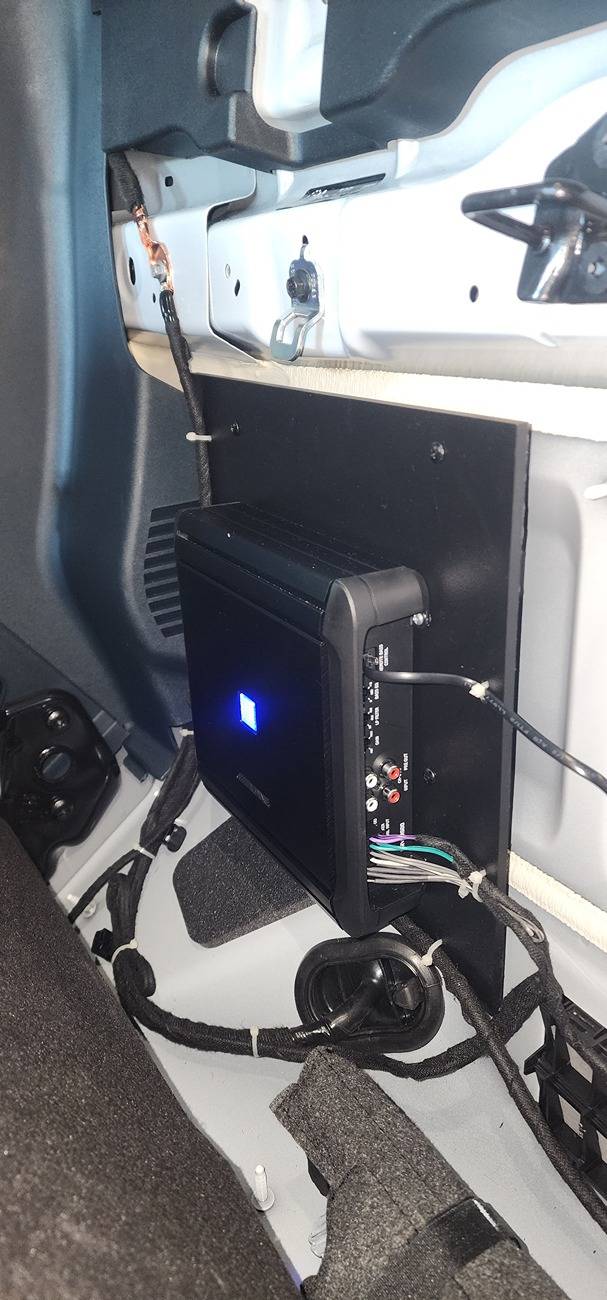

If you go with a shallow mount component sub you can put a 8-in or 10 in under the rear seat with a separate box. A few companies make boxes for a 8-10in shallow mount sub. You would then install your mono amp for the sub behind the seat.
I put a 10-in shallow mount kicker Comp RT on my passenger side of my EcoBoost, using a ground shaker box. This will result in much better bass response than the smaller all in ones.

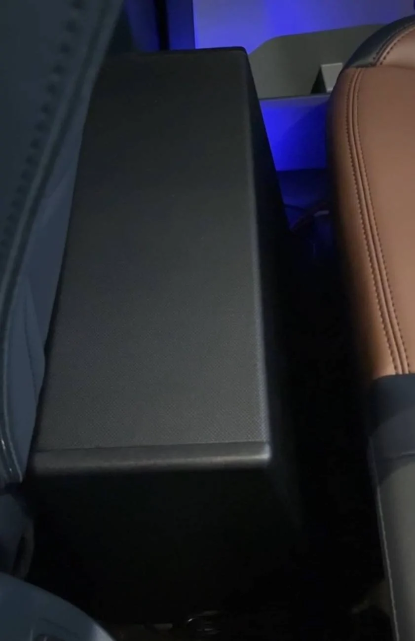

Installed behind the passenger seat. Just need to find something to wrap/hide the bit of wires sticking out the side. Back seats RARELY ever gets used except storage when traveling, so not a big deal to me.
how's it sound though?
edin702
Hunter
Jan 1, 2025
Wilmington
2024 Ford Maverick Lariat
Not as clean as I'm used to, but do need to tweak the gain abit, I'm guessing the B&O amp outputs pretty loud to the fractory sub, Barely have the gain on and it hits.
