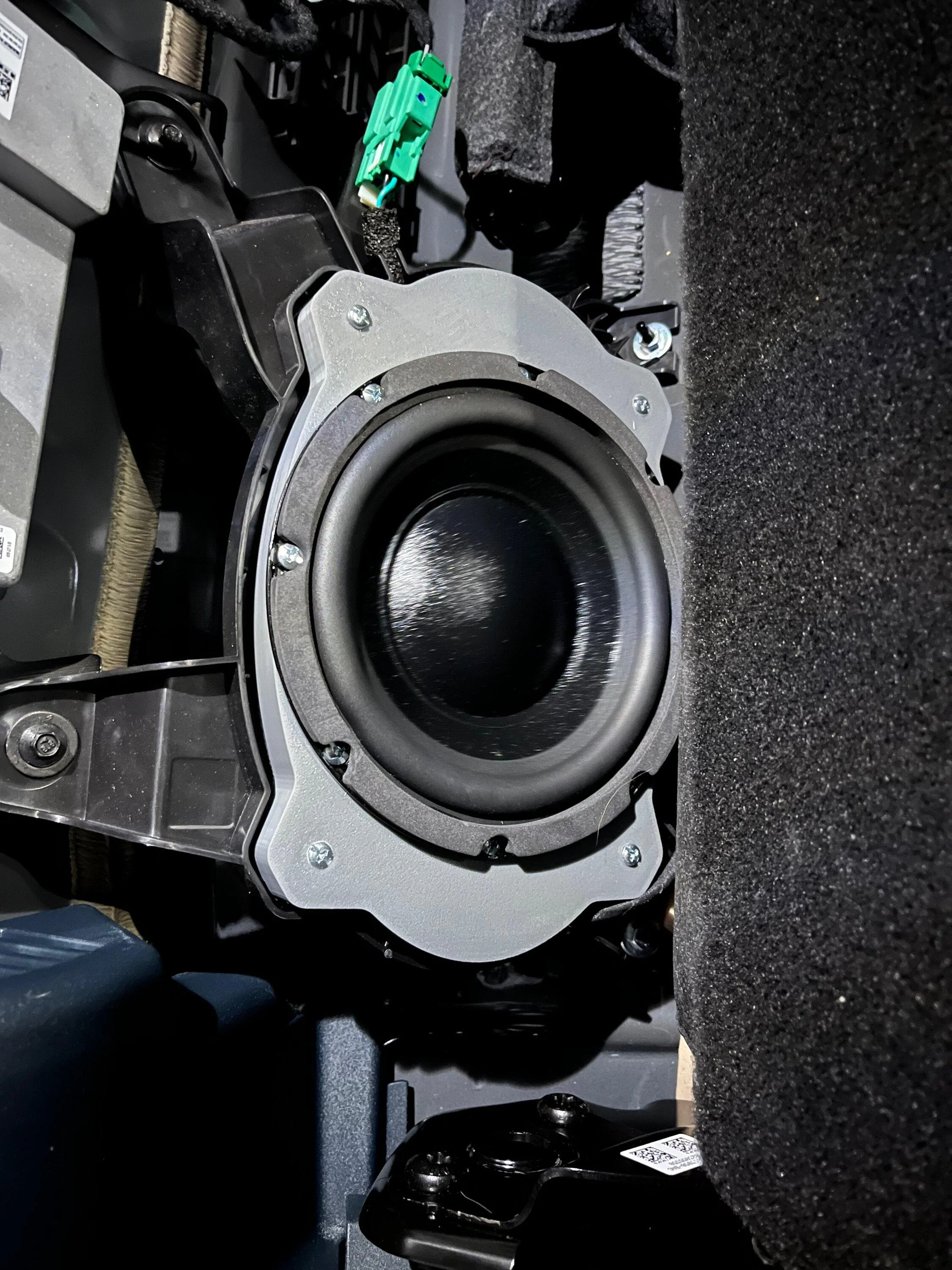

So I just swapped the sub (other speakers on their way) with the Dayton in the original post and I'm also underwhelmed. My Maverick is also a late '23 Lariat so I wonder if there really is something different with the amp? Maybe I didn't get it fully sealed? It's too cold and dark to mess with it any more. Moving the fader to the rear definitely didn't increase any bass. With or without the seat up.
When my Skar audio speakers get here, I'll try one of those 6.5" in there to see if it works any better before I put them into the doors. If so, they're like 1/2 the price of the Dayton...
Also, we designed a 3d printable adapter plate which you can find here: https://www.printables.com/model/704624-ford-maverick-bo-sub-adapter-plate-65-in-6x9
It's 19mm to approximate the 3/4" MDF OP used.

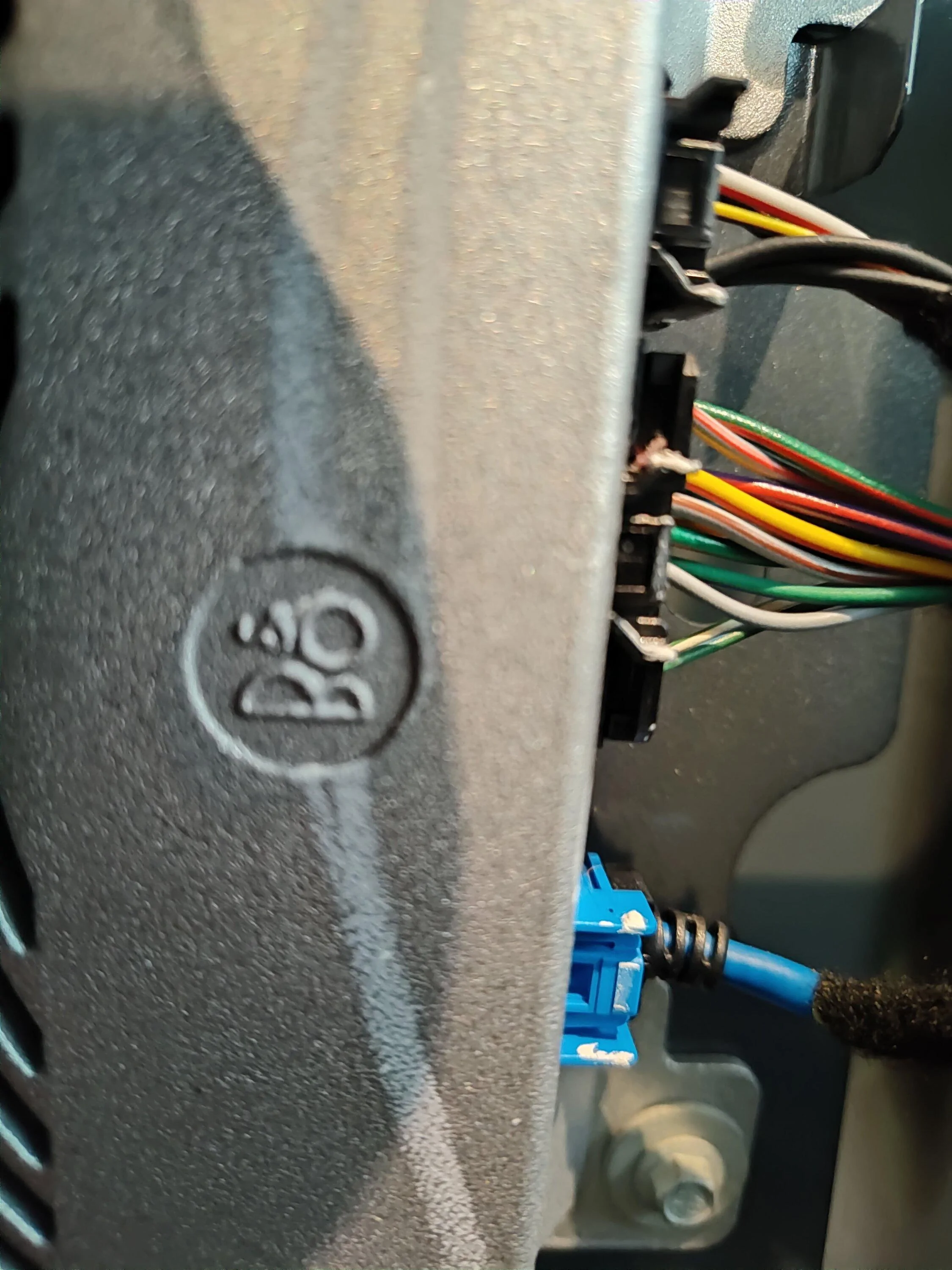

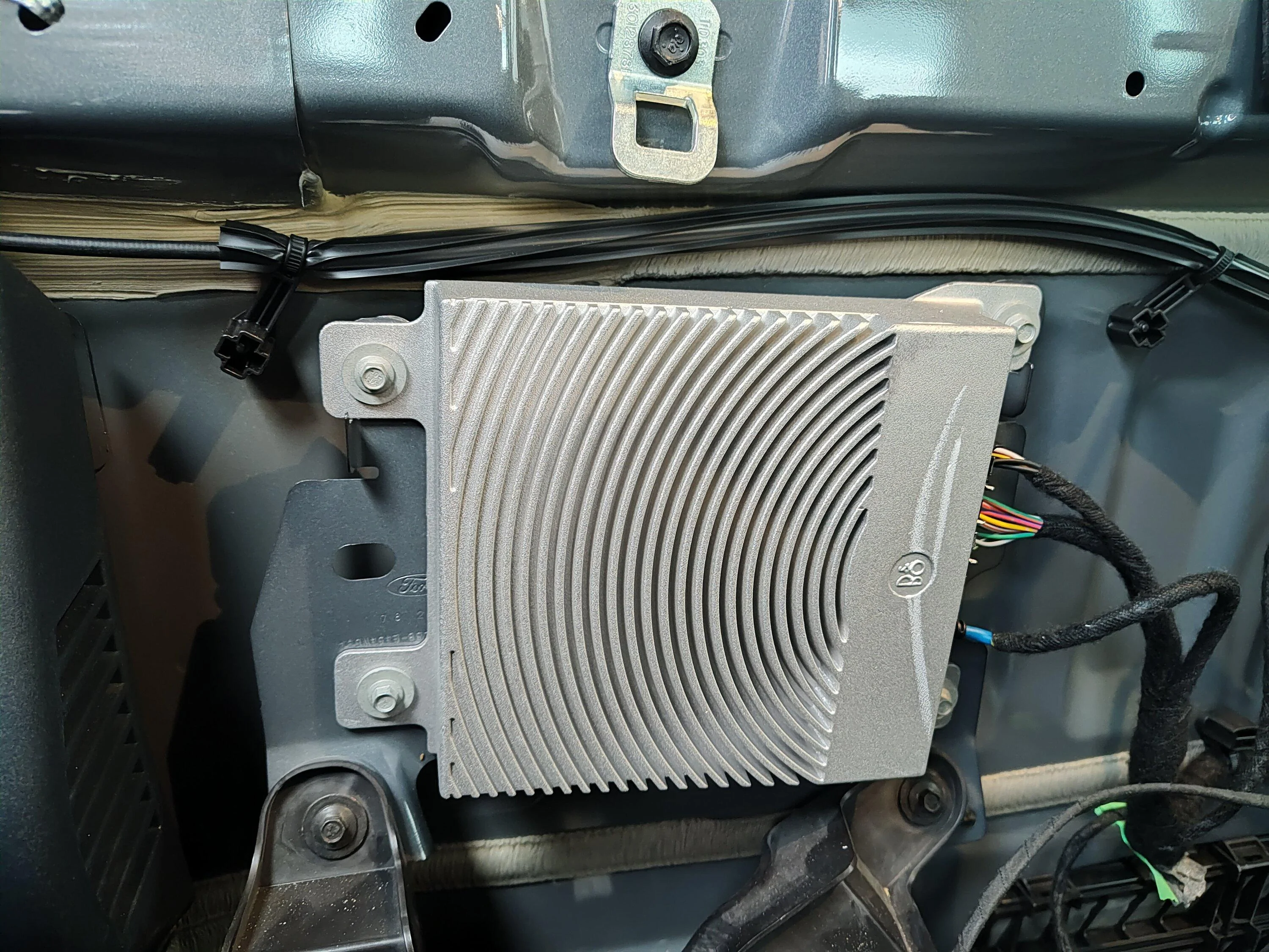

I posted this to the original post, and adding here in the hope that everyone reads it.
UPDATE: It appears Ford changed the amp in later Mavericks. Mine is early 22 build. It is labelled B&O on the amp. Later models are not the same. Others are reporting less than satisfactory results with with the new amp. I read that Ford was experiencing blown speakers with the old amp. I had a blown speaker that led to my upgrades. I suspect when Ford and changed the amp, they changed the frequency output too.
Also, I will reiterate that sound quality is a preference thing. What sounds great to me may not sound great to you. However, upgrading the cheap paper speakers in the Maverick regardless of amp, really should only improve quality. And as I stated a couple times before, DO NOT expect miracles.
The good news is. If you followed my example and you're unhappy, you can return the Dayton speaker and put your sub back exactly the way it was. It's completely reversible.

Thought you upgraded everything? My amp has the dsp, I just don't think it has the power. If we swapped I'd be saving you gas in the long run
colinl
Colin
Jun 21, 2022
5,440
6,194
ICT
nah, I'm still using my B&O amp for the front. replaced the front components, center channel, installed an amp and sub.
I wonder if you could find a different Ford B&O used amp, cheap? from an F150, Explorer, Bronco etc.
