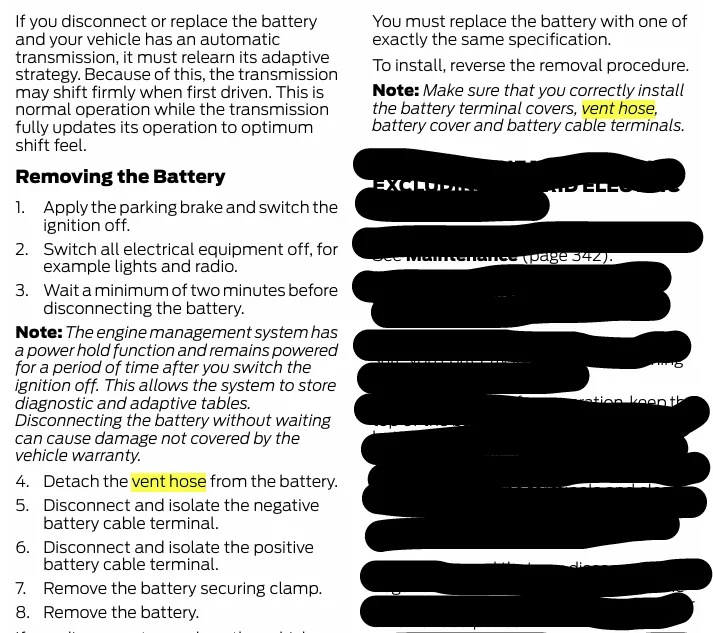

Changing the 12V Battery - Hybrid Electric Vehicle (HEV)
WARNING
WARNING: For vehicles equipped with a 12V battery vent tube, always properly reconnect the vent tube to the battery after disconnecting. Failure to follow this instruction could allow harmful gasses to enter the vehicle cabin, which could cause personal injury or death.
There you go - and because curiosity got the best of me, looked in the '25 Mav OM, searched for 'vent hose' got similar info:
