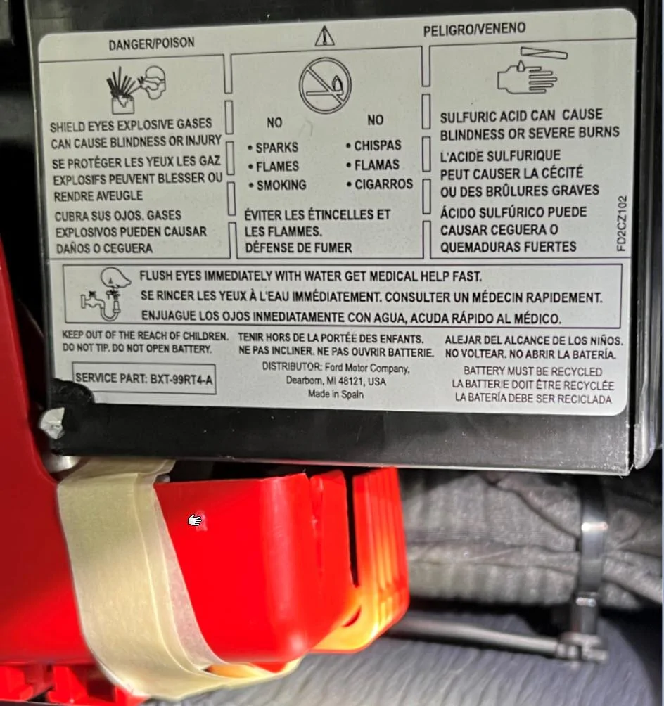

Here is another battery question/observation. I have this battery (see photo) in my Hybrid. I understand that most Hybrids came with the BXT99RT-99RT4-A. This battery is a flooded acid. Have not seen anyone else on this site with the one I have. Can't seem to pull it up on google either. Odd. Anyone have any clues? Just curious as I am having zero problems, but want to investigate for "WHEN THE TIME COMES" Kind of sounds like the death knoll eh? Haha. Thinking the "BA"

Thinking the "BA" means AGM type?

That 10655 number is a Ford engineering number and not a Motorcraft battery part number. The BA at the end does not indicate the battery type.

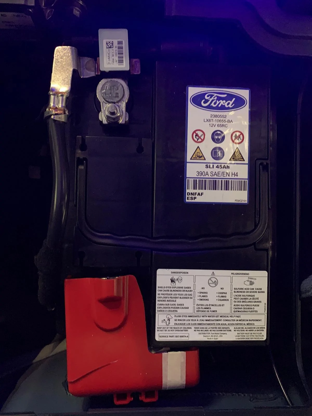

I had the same battery in Maverick 2.5L. Same one in my Escape 2.5L
The Ford FLA has Service PN BXT-99RT4-A on the white label.

The battery shown in post 46 is the standard flooded Maverick Hybrid battery. The Motorcraft number appears nowhere on the battery.
It’s identical to the battery sitting on my garage shelf I pulled from my ‘23 Hybrid 4 days ago when I replaced it with a new Diehard Gold T4 battery, and the same I pulled from my ‘22 Hybrid a year ago when replacing it with a new Diehard as well.
