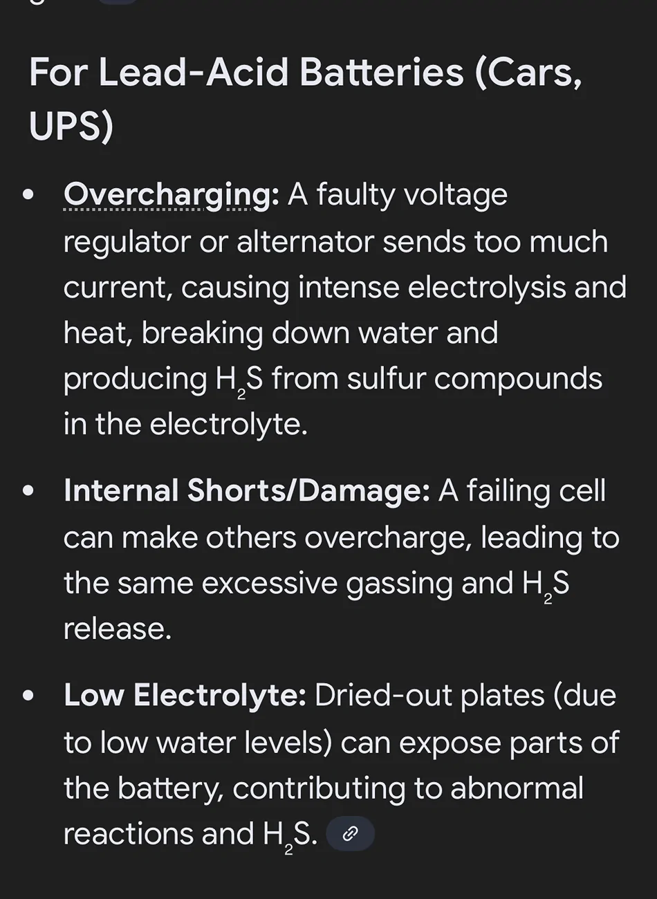

A short, as in a high drain on the battery? No. That would lower the battery voltage. H2S is made when driving the battery voltage very high, such as when your NOCO genius battery charger is put in desulfation mode and it’s driving 16 volts into a 12 volt battery.
My maverick pumps in 15.4v.
Almost Daily.
I was impressed the BMS earlier this year when it was clear I had at least 1 if not 2 bad cells - backed off the charging rate and time even worse than normal, for exactly that issue of overcharge on the good cells I'm convinced.
Which of course aided greatly in it's timely death.

Ok, fair enough. I thought you meant a short in the car’s wiring, causing a massive discharge of a healthy battery, not an internal short in a damaged battery, leading to a thermal runaway.
A thermal runaway of a lead acid battery would indeed produce a lot of H2S in a short period of time that would lead to the scenario described in the article.
