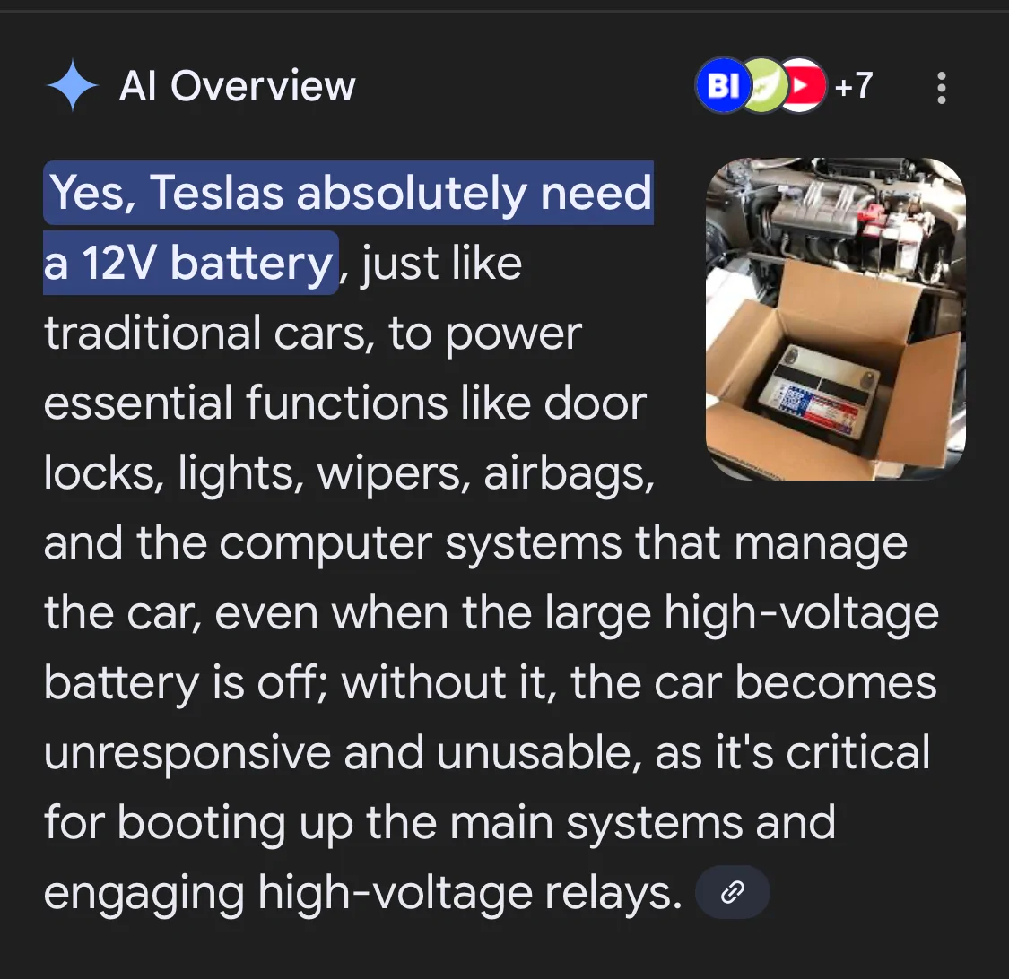

Again, now a direct question.
Why Oh why does the Mavbrid, or any hybrid need a 12 volt battery ?
To start the ICE ? Our little back up Noco battery boosters are Lipo with enough grunt to start a 6.0 L diesel right ! Or so they/them say.
:’P
The high voltage battery is disconnected while parked.
You use a 12v battery to close the contacts on the high voltage one.
Even full EV's make use of a 12v battery usually for the same reason.
