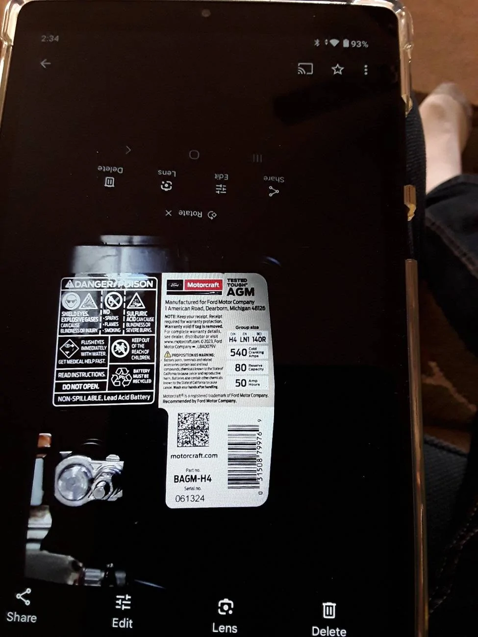

This is the battery installed in my Maverick, the research I’ve been doing does not tell me if it’s a lead acid flooded battery or an AGM anybody know? I’m trying to charge it. I’m assuming it’s a flooded battery.

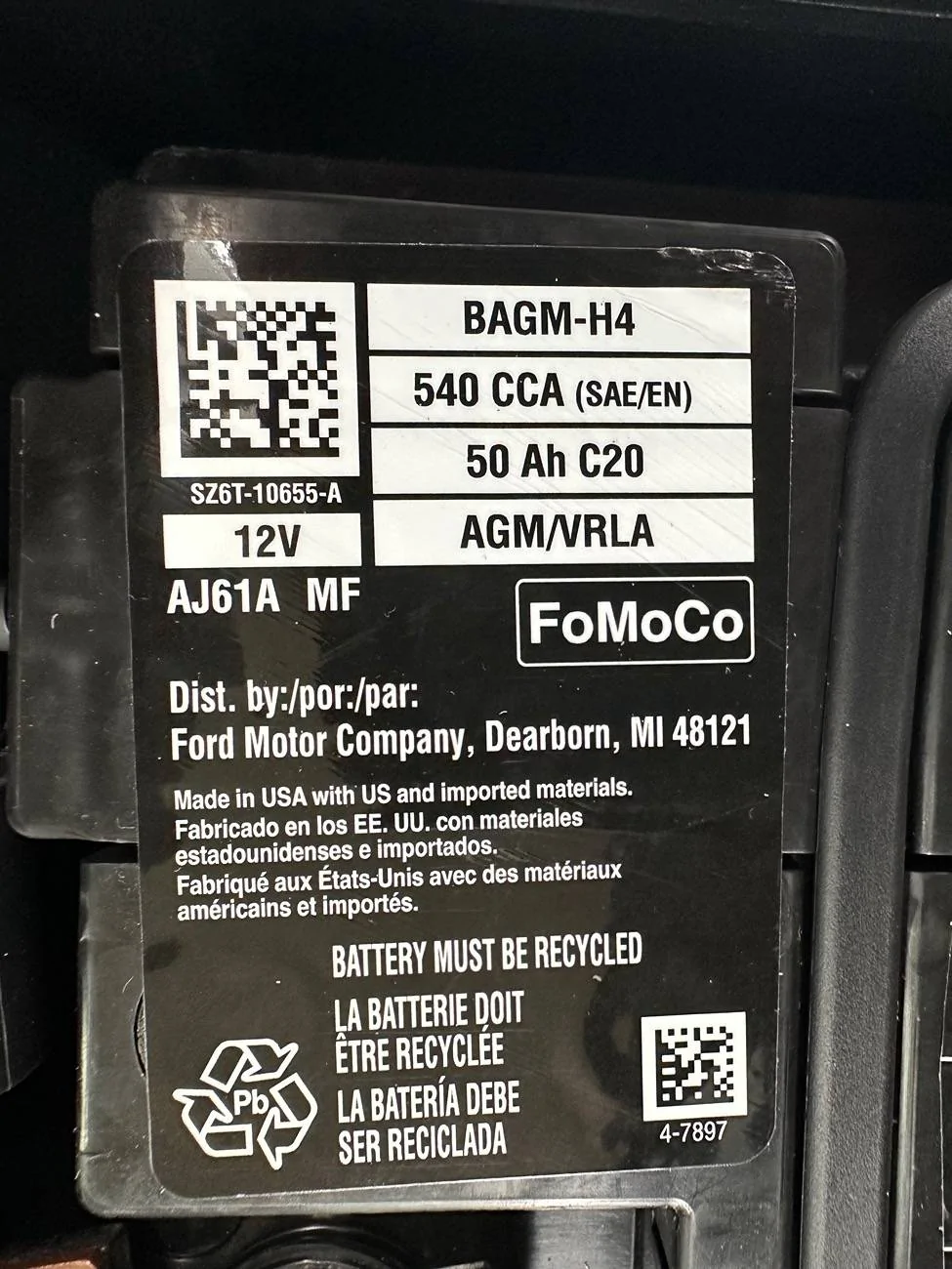

Same battery, look at the part number, it's just got a new label. :ROFLMAO:
part number same, different codes. could be different manufacturer. this one is from USA, but i've seen posts they also get some made in spain.

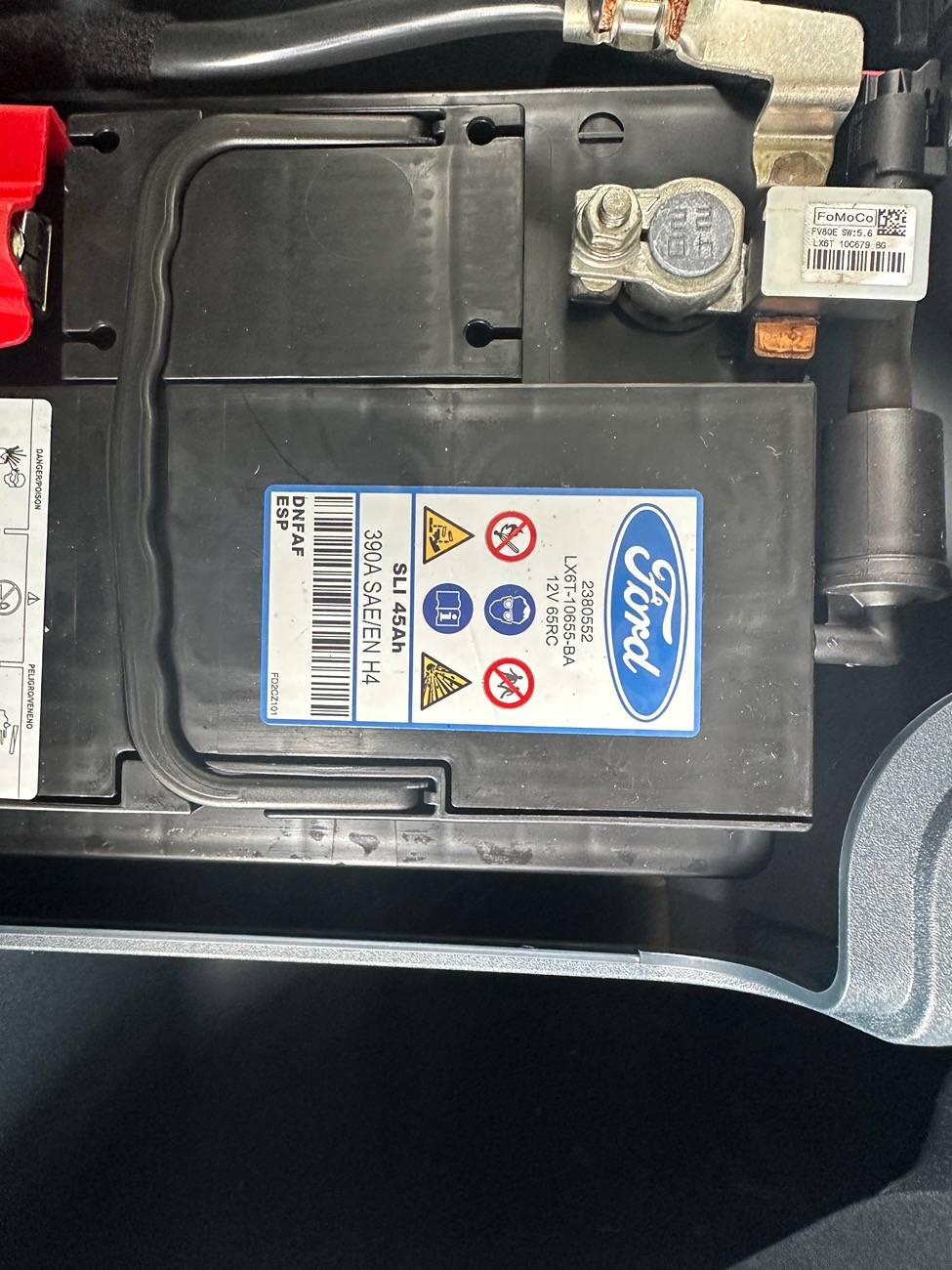

My 2024 AWD Lariat Ecoboost came with this one:
When new it sat unused for two weeks due to ice conditions.
The voltage at the start of the two weeks was 12.37 and two weeks later it was 12.29 VDC
Now at 3300 miles it sat at rest for three days at 12.34 VDC
