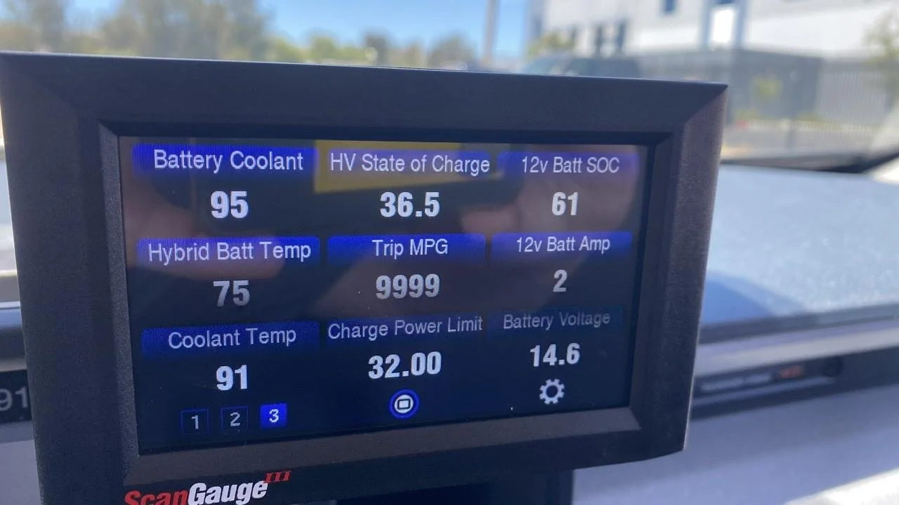

Nice work.
I have the same or even more watt-hours lost overnight. I also turned off WiFi and GPS and Telematics. Even deleted the Ford Pass App from my phone.
I also have an OBDII scan gauge 3.
It has 12 volt state of charge.
My truck, best I can tell, keeps the 12v battery between 60% and 70%. Never better. Never worse. In over 8 months of monitoring. Exception:
Parked it at a dealer for a month waiting for parts. When Ford returned it to me 12v battery was measuring 32%. That night, I put it on a charger, got it up to the point the automatic charger shut off. Slowly, within a week, battery back to 60% to 70%.
30 to 45 minute A.M commute and 30 to 45 minute PM commute. Always 60% to 70% 12 volt battery.

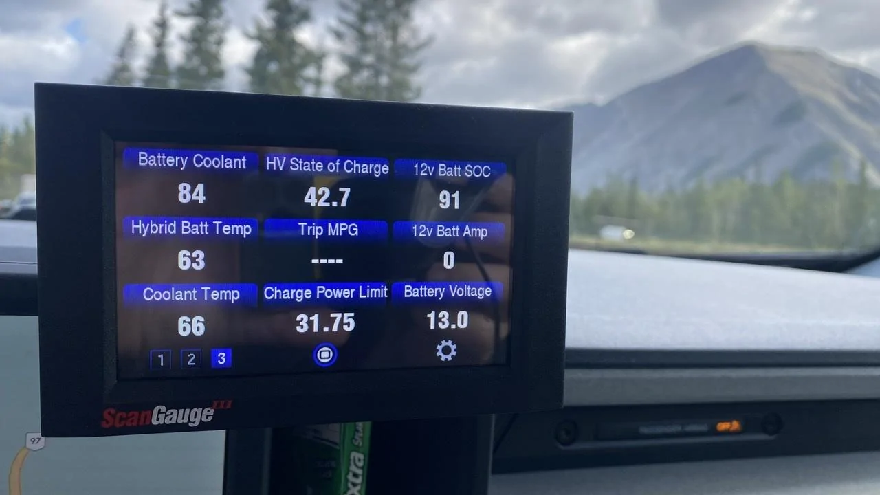

EXCEPTION.
Drove San Francisco to SE Alaska.
Five consecutive 10 hour days of driving. Not paying much attention until at destination, glanced at meter, was at 99% charge (12v) after 50 hours of run time in 5 days.

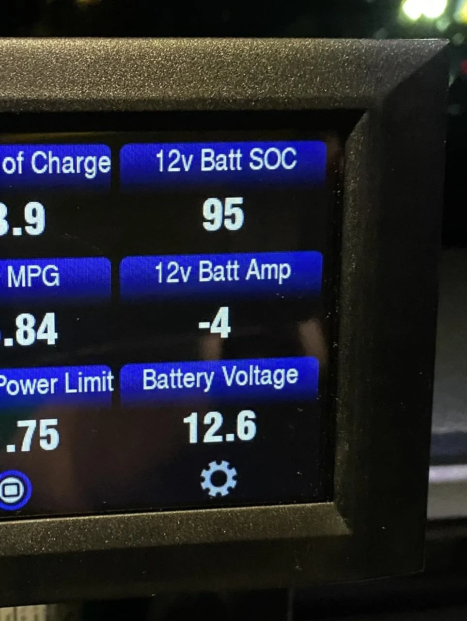

Normally:
Ford Maverick Replacing 12v battery 866565FD-6E75-4D2E-BC34-12E176593C39
After 50 hours of run time in 5 days:
Note the voltage WHILE RUNNING. DC/DC was that low. First time I've seen it under 14.0v because it needed no charging for the first time in 8 months?
Ford Maverick Replacing 12v battery D1B90A7F-C156-42B3-867A-062D5483C9C8

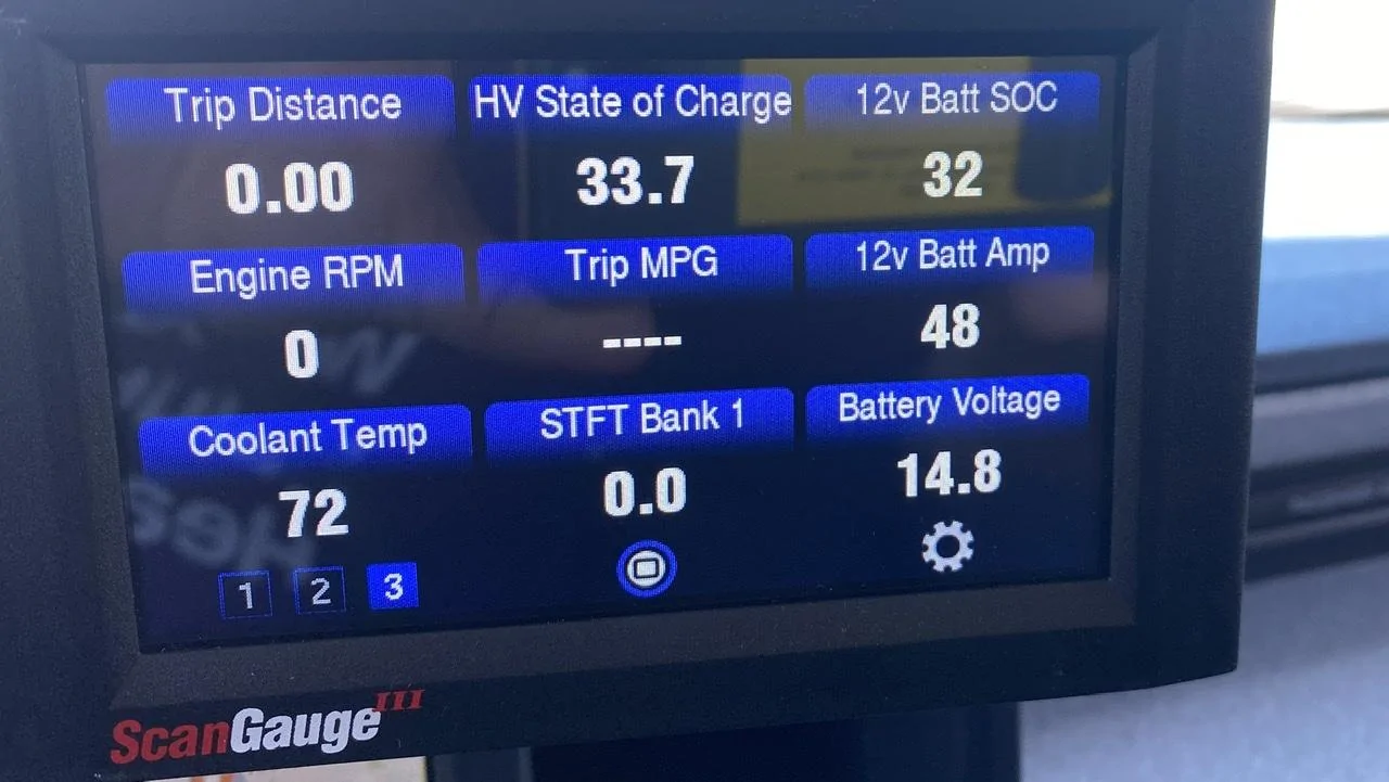

When dealer gave it back to me after having it sit for a month:
Ford Maverick Replacing 12v battery 913BF114-E582-4B3F-9C32-7A019436AAB3
Note heavy charging at 48 amps.
Zeros and ambient temp: I had not started the truck yet. Just turned the key to run.

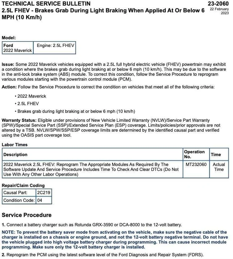

The 12 Volt battery is not the issue.
The issue is that the software that decides to charge the 12 volt battery is deficient.
Have TSB 23-2060 done because not only does it vastly improve low speed braking but doing that TSB also updates the software that charges the 12 volt battery.
After I had TSB 23-2060 done I no longer had any Deep Sleep issues.
Ford Maverick Replacing 12v battery 908DF5E3-F181-4AA6-8748-82FA2A801355
Apparently there is a recall now 23EO7 that replaces 232060.
